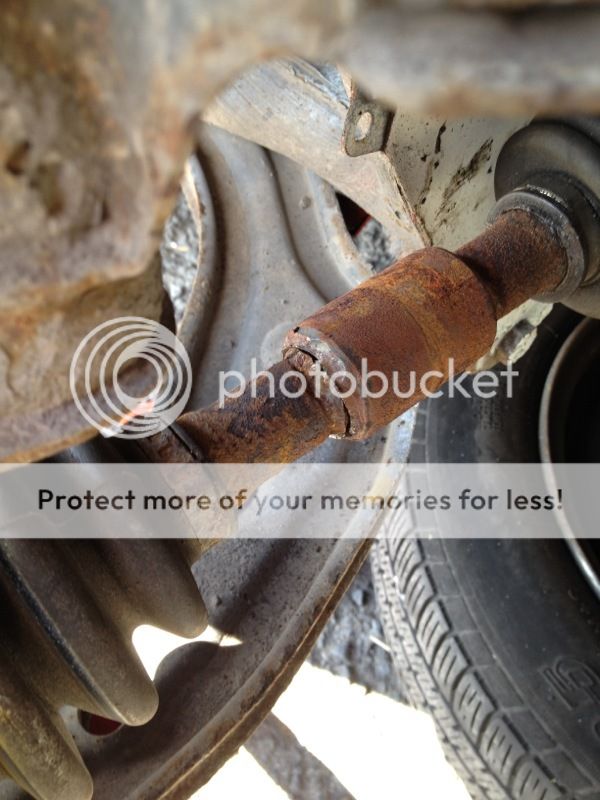

Anyway i go out in it to shops and i break a driveshaft. Yes a Driveshaft which is suppose to be rated 350bhp and made by a company???????? well it breaks a weld (a weld of all things!) where the two shafts have been sleeved together so now i cannot even drive it. It runs etc but cannot move it in gear as driveshaft just spins. He says he will come and get driveshaft and get it sent back to company and repaired but i hear nothing since. Ive threatened him with court order and he not budging so im still here today with a broken k11 which i have no knowledge of fixing and cant afford to get it fixed. Id imagine the driveshaft just needs rewelding to make it drive and the engine needs adjusting on mounts. i mean it doesnt even look like its in straight!

The driveshaft i have a video of. its been sleeved and where its been welded at the sleeve it snapped so the shaft to the micra wheel doesnt spin but the sleeve and the shaft to the gearbox spins..

Thought I'd try and get driveshaft off and take to mate to weld it up again but I couldn't get the thing off. Ain't a clue What to do with it.

if the shaft is in two bits you just tug on it and it should come out of the gearbox fine (expect loads of oil to come too...if Kristian actually filled it up) the other side you will have to take the nut off the end.

wip them out and get them welded properly. dont forget to catch your gear oil though.

its quite easy to get the shafts out
  1. wheel's off,
  2. hub nut off 36mm socket iirc ,
  3. two bolts out the strut 17mm socket ,
  4. then pull back on the hub and push the cv through the hub,
  5. then pull the whole driveshaft out the gearbox, note the oil will p*** out everywhere so get a bucket under it
  6. get them welded by someone reliable (i.e not kristian and his dodgy mate's)
If i were to weld the shafts id do more than just a sleeve i.e. drill a hole down the centre of each shaft, slide a rod in one end, maybe drill through the sides of them, fill it with weld, slot them together, weld the butt joint, grind that down then weld a sleeve over it.
Yes you have to weld the core of the shaft together first eh stani, THEN sleeve it, and also make some attempt to de-scale the rust off the shaft first :rolleyes:
