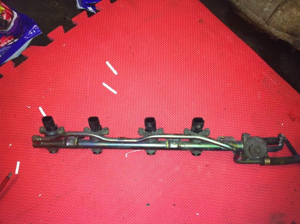

Ok next question.... Seeing as I don't really want to spend more money on things I already have, if I cut 'n' shut my s14 rail would it be safe to use high pressure rubber hose to join the pieces together?
Technically that would work and is a flucking clever idea but depends as you say about hoses? Can they withstand 4 bar of pressure? 32 psi in a tyre would be 2 1/4 bar :/
So 4 bar is around 56 psi ? If it held it Would be so easy to make :)

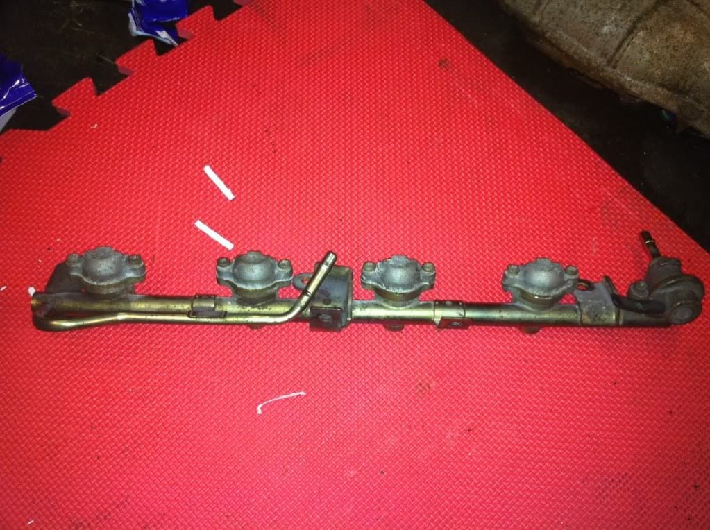

the stock fuelpipes have got a retaining bead swaged into them tho mart eh
where the fuel line attaches to the rail the rail has a slight mushroom flare to the pipe... kinda like exhaust hangers if you get what i mean

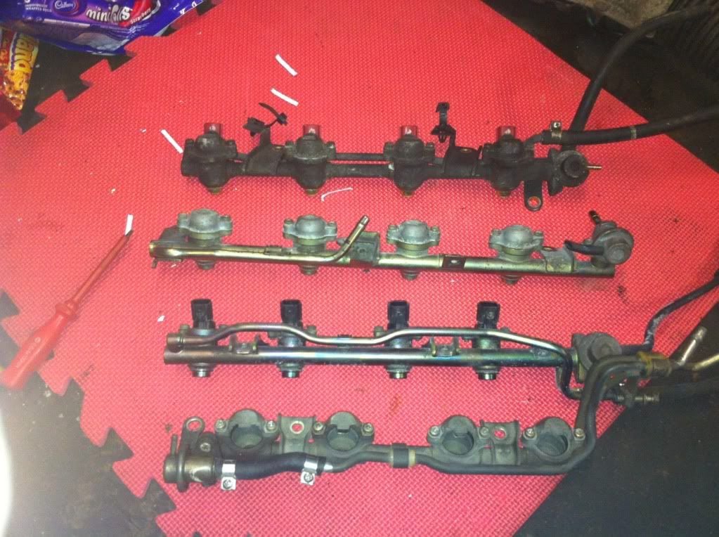

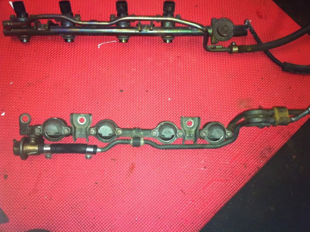

Here we can see all Fuel rails along side each other:
The top one is a highport side feed SR20. 259cc standard.
The next one down is the lowport side feed SR20. 259cc standard.
Next one down is the UKDM GA16DE. 159cc standard
Next one is the USDM GA16DE from a B13 Sentra (unsure on cc, althoguh it may be 185cc) and is capable of taking ANY sr20 side feed injector so is a good upgrade on UK and US GA's and they also come with better intake manifolds in the US and will show noticeable gains on the UK GA's.
Now that sentra GA16 one i have there may be closer to fitting the CG than the SR one. But im not totally sure as i dont have a CG one to compare with. Cutting may be less...or more. im not sure

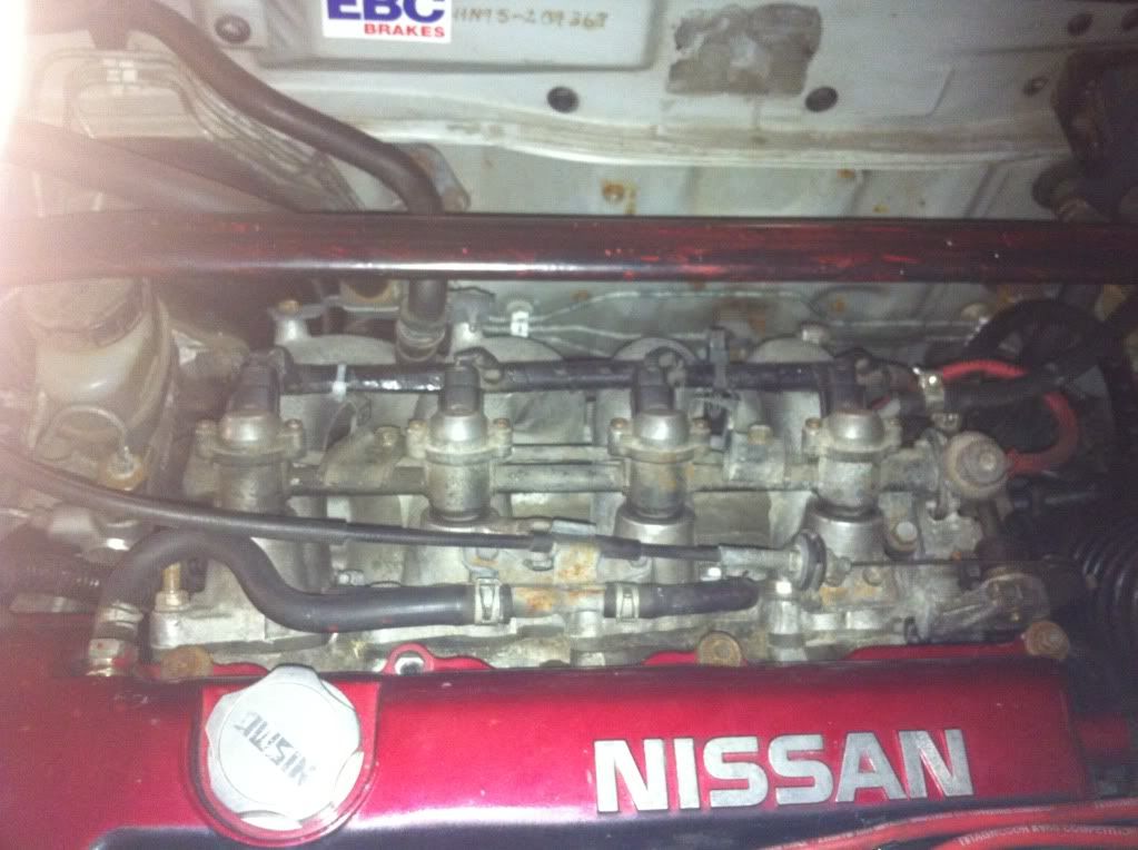

the CGA topfeed setup might be a better option for you turbo guys :)

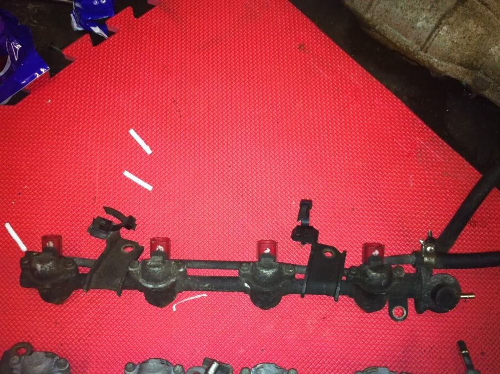

the spacing is correct, and the 2 fixing brackets line up perfect (arrowed)

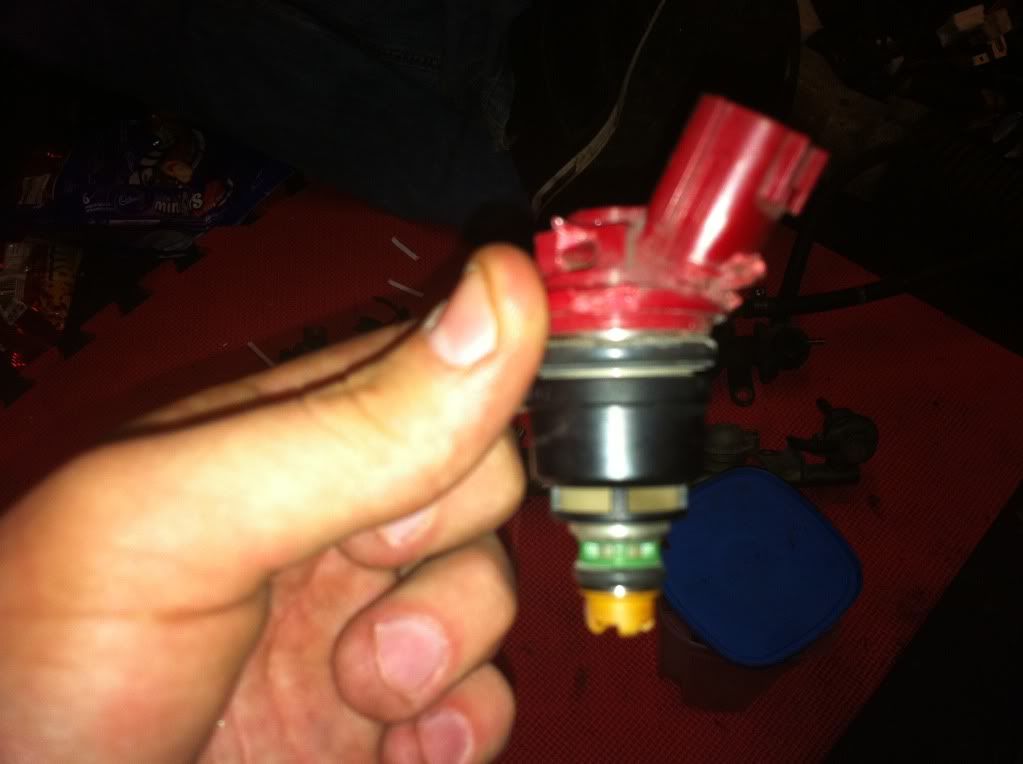

apparently my QG (red ) injectors are rated at 211 cc @ 3 bar and 14.5 ohms, but there are bigger ones available eh

you have to cut the idle control valve off and mount it remotely, else it hits the topfeed rail martin (like the t/b on the left)
or else you could turn the t/b around 180 deg (like in the pic)
either way the QG injectors have solved my fuelling out, with no leaning out even with the QG 50mm t/b and 100+hp :grinning:
it works fine for N/A, but turbo,s need some extra spark retard tho eh fwn (else you would have to manually retard it and live with it being laggy at low revs)

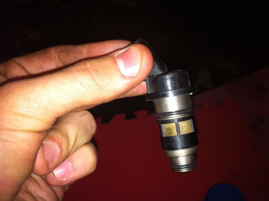

the remote i/c/v is easy to setup mate, and makes it more user friendly :grinning:.
the injector plugs are slightly different (you have to shave a locating rib off the side).
and i had to untape the loom a bit for the t/b plugs to reach

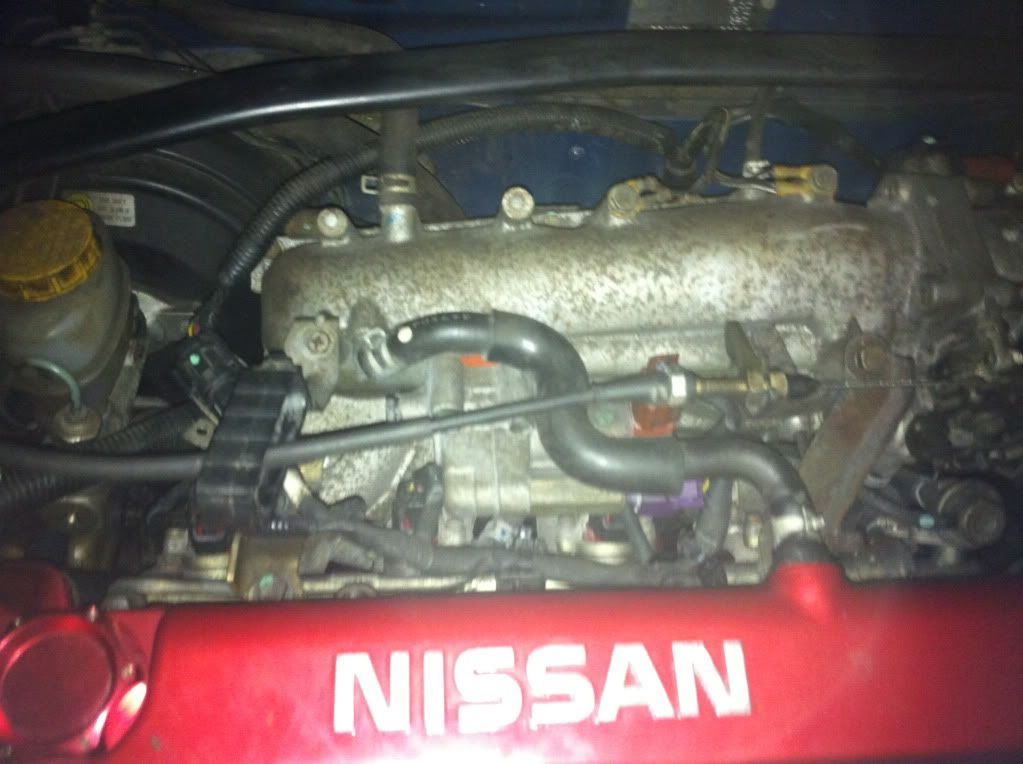

So let's say for instance I used the stock cg13 inlet and tb
Then used Micra topfeed injectors (swapped to something bigger when required).
Swapped fuel rail, could I just turn throttle body after drilling and tapping inlet to suit 180 degree turn tb
Ive already un wired the loom and have an s14 sr20 det air flow meter in line
So basically stock inlet, top feed fuel rail and Re-drilled inlet with 180 degree cg13 tb?

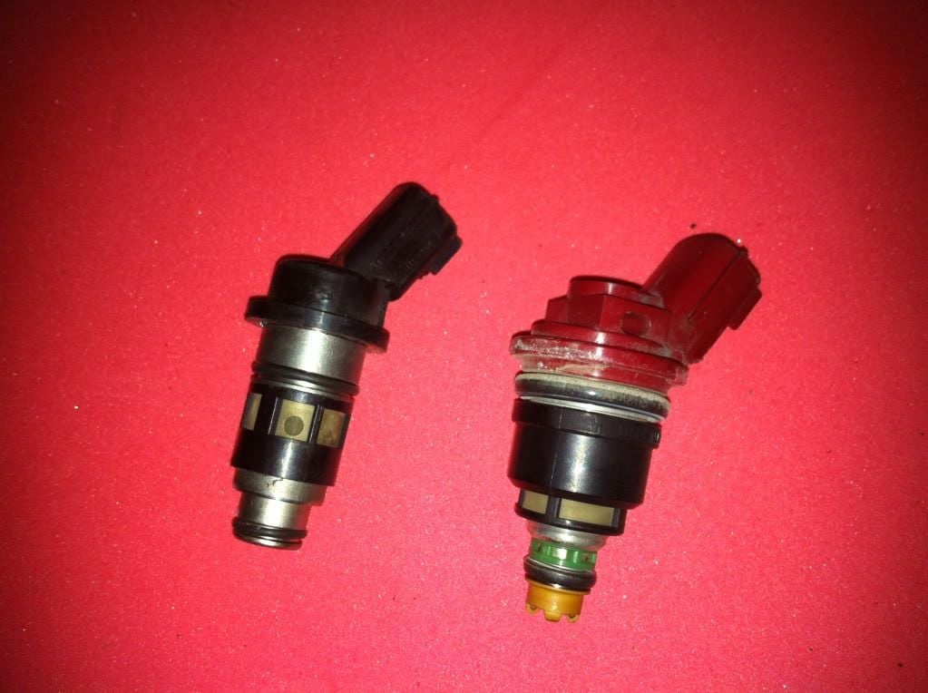

the (blue) CGA injectors underfuelled on mine martin, so dont bother with those.
i would say that the (red) QG ones would be fine upto about 120hp (with a stock ecu).
and my other mani with the CG t/b turned around has a cut-off mount welded ontop
