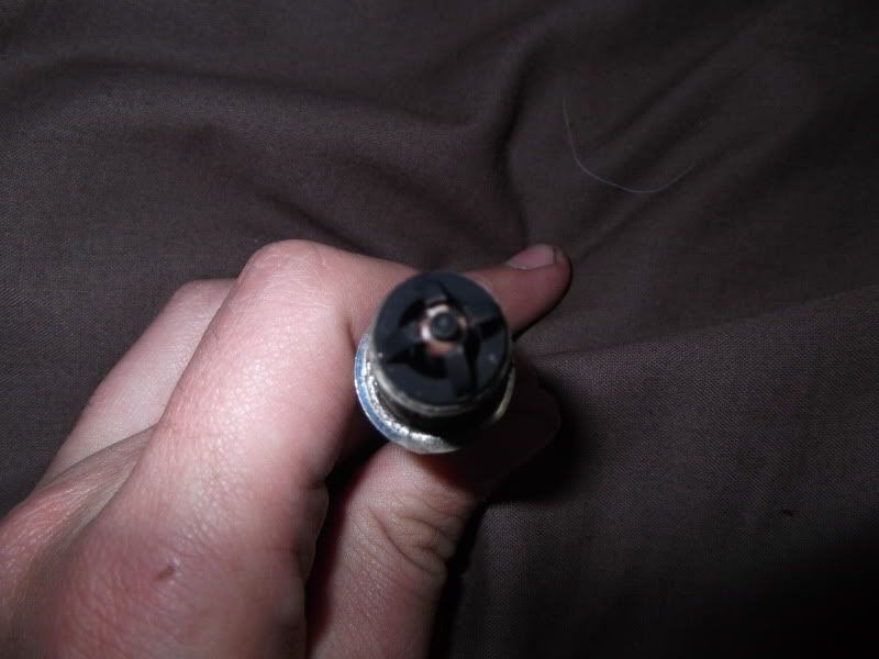

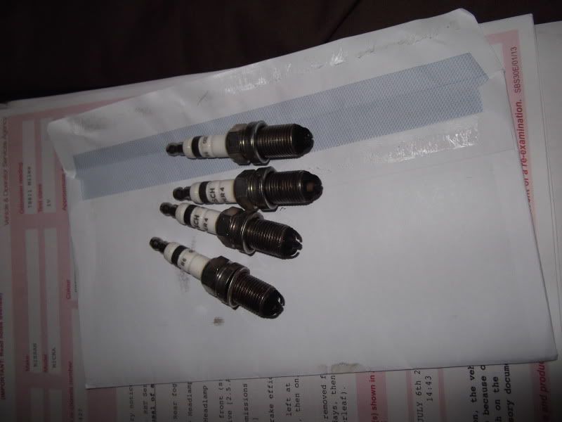

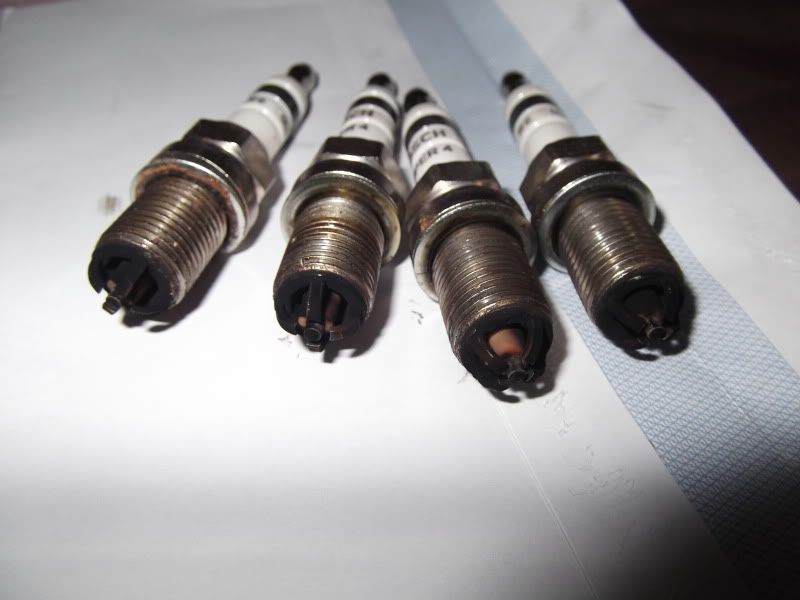

Onto the other problem.... Changed the Bosch super 4's for some NGK's today in hope that they may tell me a sign....
If i am correct doesn't sooty black carbon on all the plugs indicate overfueling/running rich?
if so do you think that could of been due to the just bolt on the foam filter to the TB technique that was on there?
now i have a stock airbox/pipes new sparks and giving it a little raggin' with some redex in there i have my fingers crossed...
