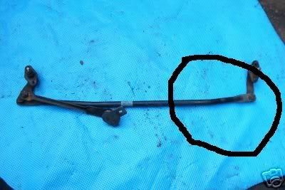

If you get the standard mechanism there is a bar with a bend in it, if you straighten it out a bit the arm will sweep further. Worth a try for anyone with a spare wiper mechanism.
Just to make it a bit clearer here is a linkage arm off a 350z. I have circled the bend that needs straightening. You will also need a straight wiper arm (the bit the wiper attaches to)
there is no bent bit on the k11 setup, its a straight rod,
to make it sweep further you have to change the cam size, adjusting the con rod lenght will change where on the screen the sweep area will be.
