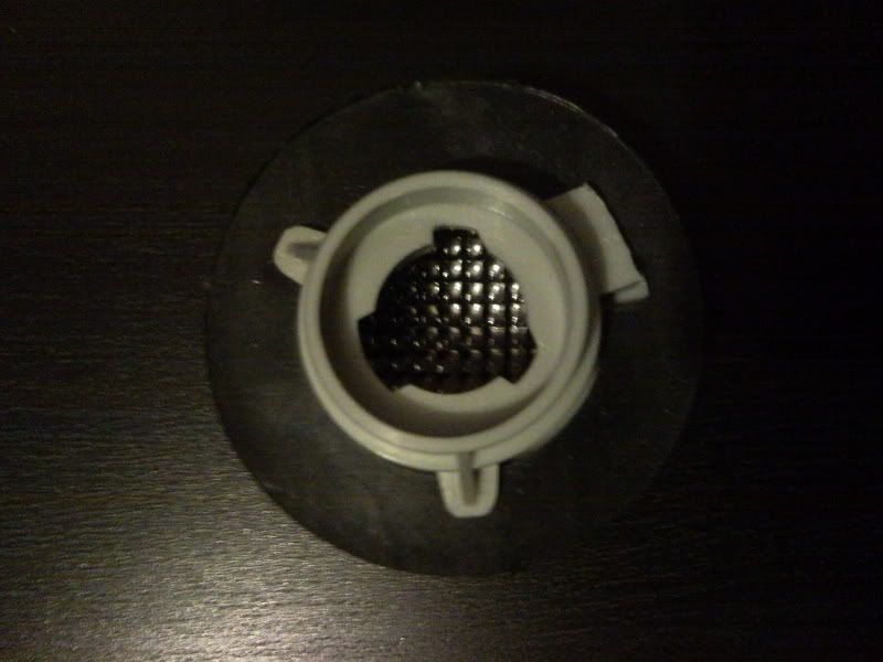

Bought some clear side repeaters off eBay, tried to fit them but they are different!
Original Side Repeater
Clear Side Repeater
The hole on the clear repeater is slightly too large and the plug will not fit. Anyone else had this problem?
Yup i cut of the holder from the original lens and made it a push fit into the other lens..that way the bulbs still fit and are held in place without bonding anything in (so easy to undo). :)
