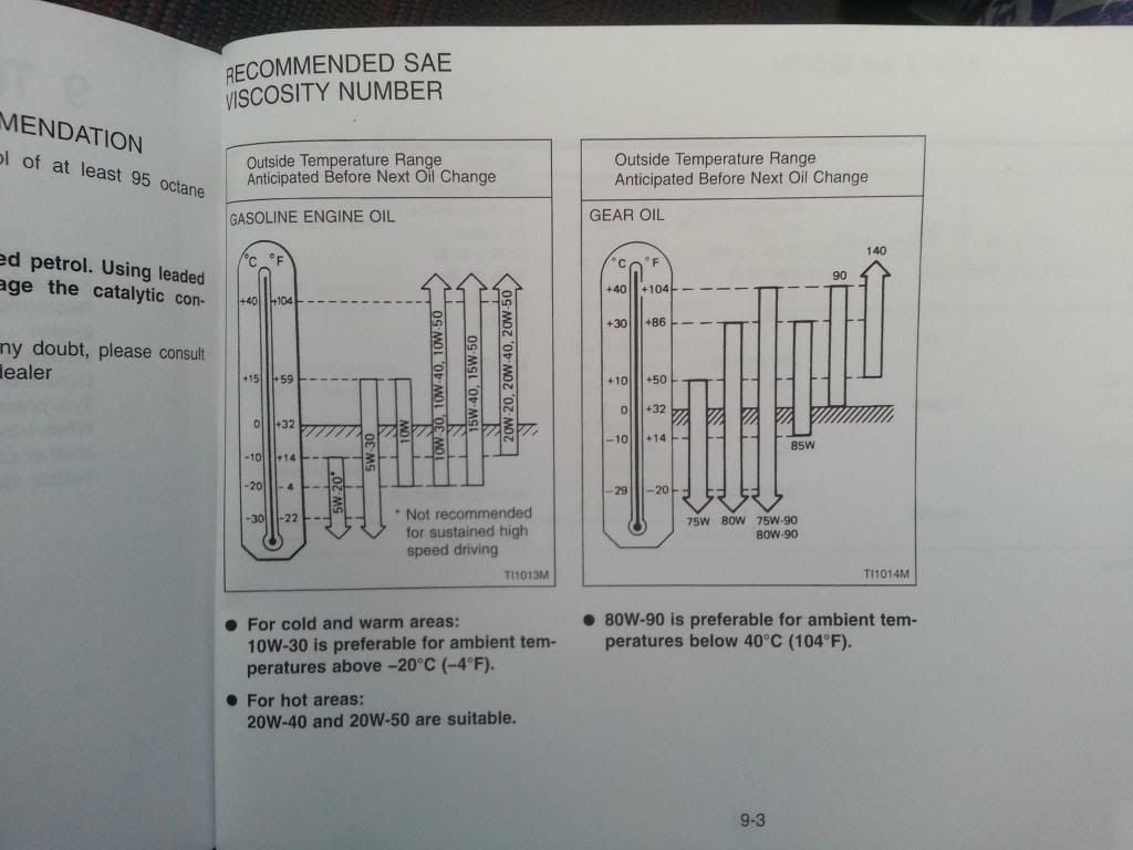

I'm getting the bits and pieces for my service, and need to know what oil I should be running. I went to Halfords, they told me 5w30, went to Castrol - They said 5w40. Looked around the forum - ppls are running 10w30. What do these numbers mean and which one should I run?? I'm leaning toward the 5w40 by Castrol (as its a good make) I have a 1 litre 2ndfacelift coilpack if that's any help....I think, don't quote me on this, all the oils will actually be fine, the numbers have just got something to do with the temps I think....correct me if i'm wrong??
first number is how thin the oil i, last number is temp range. So 15w40 is thicker and works at hotter temps than 10w30. If your engine has a fair few miles on it i'd put 10w in it, 5w for a fairly new engine. w30 for cold half of year, w40 for hotter half. Also, if you run a fast road sort of engine and drive hard, add 10 to the second number.

The numbers have something to do with the viscosity at different temperatures...you ideally want a lower low number and a higher high number, if that makes sense
EG: generally speaking... 10w 40 is "better" than 10w 30 as it has a wider...ummm....working range? it's still good at higher temps...I think

I'd say an old engine was 100k miles, you can assume the engine will be quite loose by that point. Oh, and don't think that a higher second number means better protection necessarily, the higher the second number the more viscous it is when cold, putting more stress on oil pumps. If it's mechanical not electric, excessive revving when cold could over stress the vanes on the oil pump or damage the drive gear.

The smaller number is how thick the oil becomes at cold temperatures (the 'w' stands for winter, not weight), the higher number is how thick it is at full temperature. Nissan recommend 5w30 for virtually all their cars because 5 is thin and gets around the engine more easily on start up when the engine's cold. This is vital for protecting the cams and other upper engine components. They recommend the 30 for fuel efficiency reasons - it creates less drag within the engine than 40, or 50.
I use 5w30 in winter and 5w40 in summer in my diesel. To put all this into context, the Americans are starting to go to 0w20... :).
The higher second number has nothing to do with cold viscosity, the first number does ie a 5w50 would be thinner at cold temperatures than a 10w30 ;).

I think for this years service, I'm going to go for the oil in my shed and switch up next time, as for spark plugs - might as well go NGK as you can get the four plugs for a fiver, if the expensive ones are promising more than they're worth, I might as well make the saving

can't see the pic, is it of the manual saying bosch?
i saw that, and still bought ngk's,
