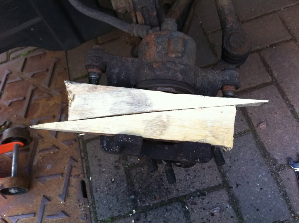

Theres no need to change the brake fluid really, just bleed all 4 corners then top up. Fitting new brake pads is easy, youll need a tool to push the piston back though or you can do this instead
Basically wheel off, 2 bolts undo the caliper, then remove the old brake pads, push piston back, fit new pads, refit caliper and wheel. Pump brake before using car.
