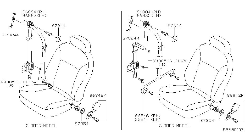

this is the exact name of the part: BELT ASSY-TONGUE,PRETENSIONER FRONT LH
also found this..
ok so I found someone on ebay who sells in here in Italy...
the code is different... its: 86885 6F810
According to a list of spare parts of the micra, this piece is the exact same one, but used between the production period from August 1999 to July 2000 (so just before my micra was produced)
The seller says it is compatible, but the only thing that seems strange to me is that the one he has listed has a long metal tube attached to the seat belt mechanism. The one my mechanic took off my micra didn't have this tube.
I read up about the difference in Pretensioners, and it seems that the one with this 'tube' is a Pyrotecnic pretensioner, while the one I have is an electric pretensioner....
can anyone help me out with this issue?
I found an image of the one of the seller on ebay
