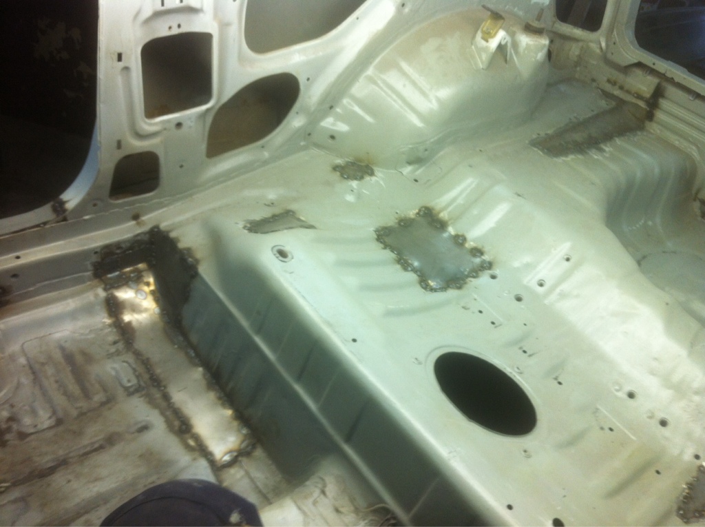

Welding has already begun and it should be ready in a week. I'm now wondering instead of sealing those welds with seam sealant just use a thick layer of anti-rust undercoating and that should do the trick. What are your thoughts on that, should I buy the sealant or use the the undercoat? btw: I have tons of that underbody coating.
Good to see you're not giving up.
I agree with infinity, sealant sounds best, may as well do it properly after all that work, can always undercoat it too for extra protection, over here the MOT guys aren't too fond of thick layers of undercoat as its probably hiding something but don't know what it's like in your country

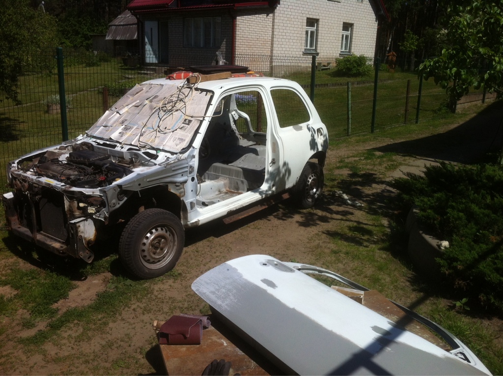

Whole week of restless work and just now an all-nighter to get her running and make it to an apointment at the mechanic so he can hook up brake lines. Little did I know that the generator is blown and now i'm stuck for good! :mad:@@@

Haven't been posting a lot lately. I guess I was to busy enjoying the car. So it is kinda ready! Finished exterior and interior at end of the august. Had some fantastic trips around the country and is now being driven almost every day. The car is amazing and I can't get enough of it. :D
here are some more pics of progress
