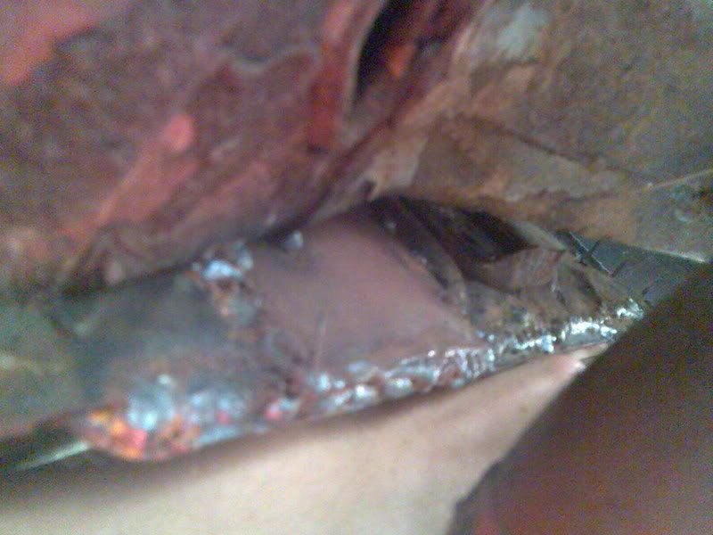

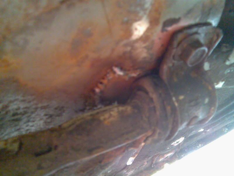

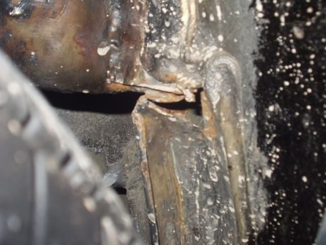

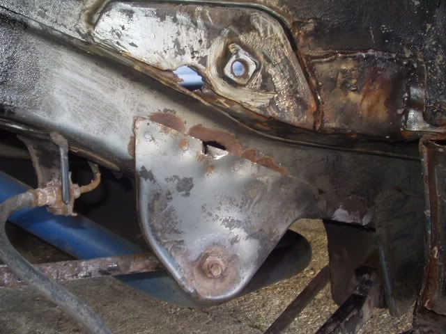

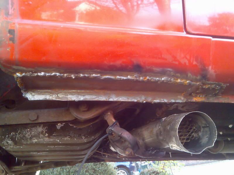

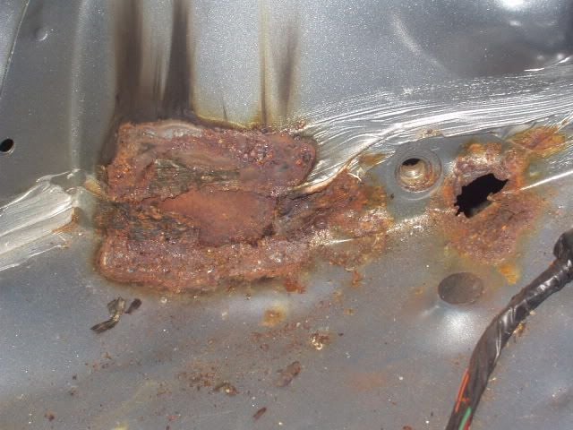

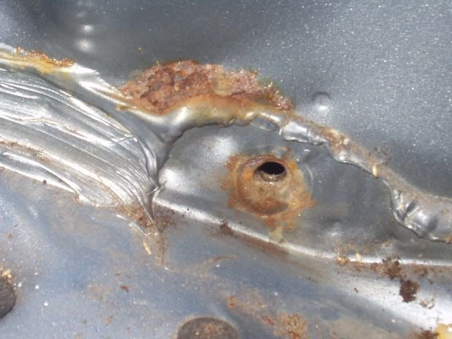

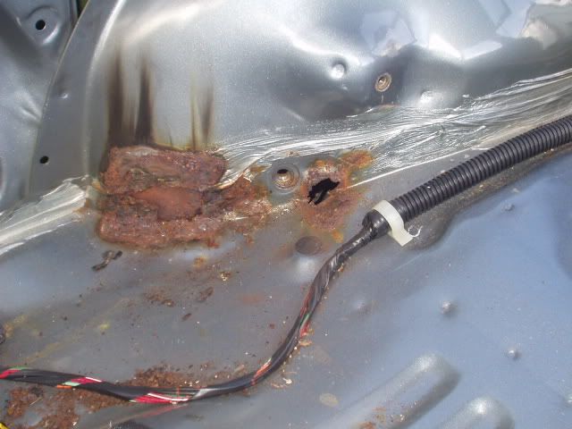

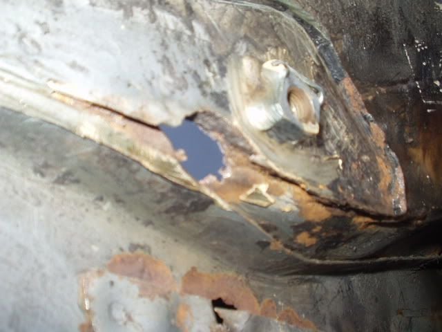

Took a few photos of the offending area.... o_O
Nice hole... you can see where they welded a plate on.
This is where the Sill joins the Bodywork...
Inside the Cabin...
other side of cabin...this bit isn't too bad, something i can probably fix myself

the corrosion on the s/b anchorage that was listed was probably the bit that was fixed with the square patch, and the smaller hole you,ve uncovered was probably covered with sealer and underseal

I just got mine welded up on both rear cills....offside rear outer and inner ..plus near side outer.....
cost 115 poond!

Thats what needed doing to mine aswell as a hole behind 1 of the front bottom arm bushes.
Ive got pics, i just need to borrow my mates bluetooth stick to post them up.
