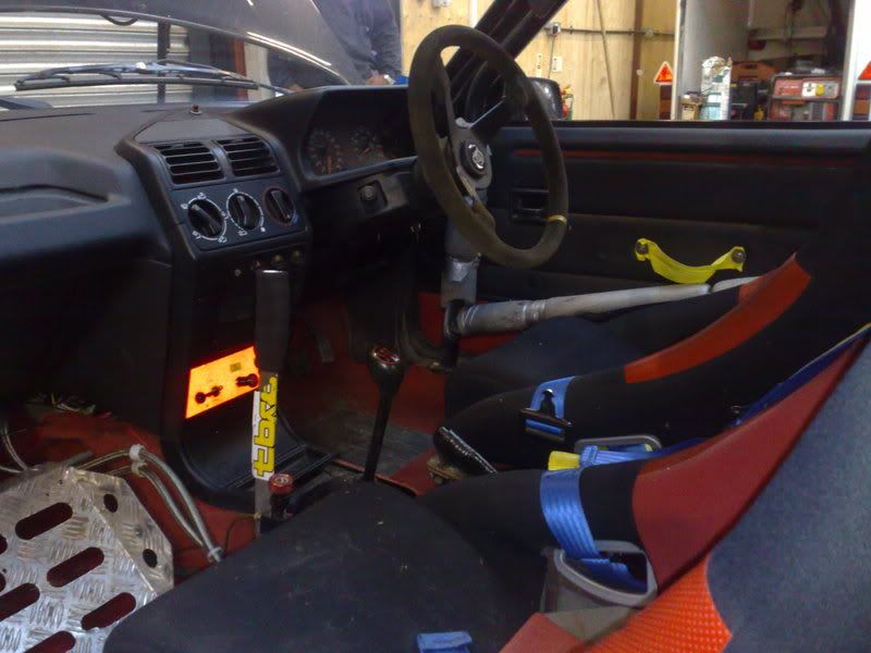

Pic off google not mine:
Thanks again, so they are pretty lenient with the interior aslong asit isn't fully stripped and stupid etc.

That 106 interia shot, the hyd hand brake is illegal, it must only be 'piggy-backed' off the OEM hand brake.

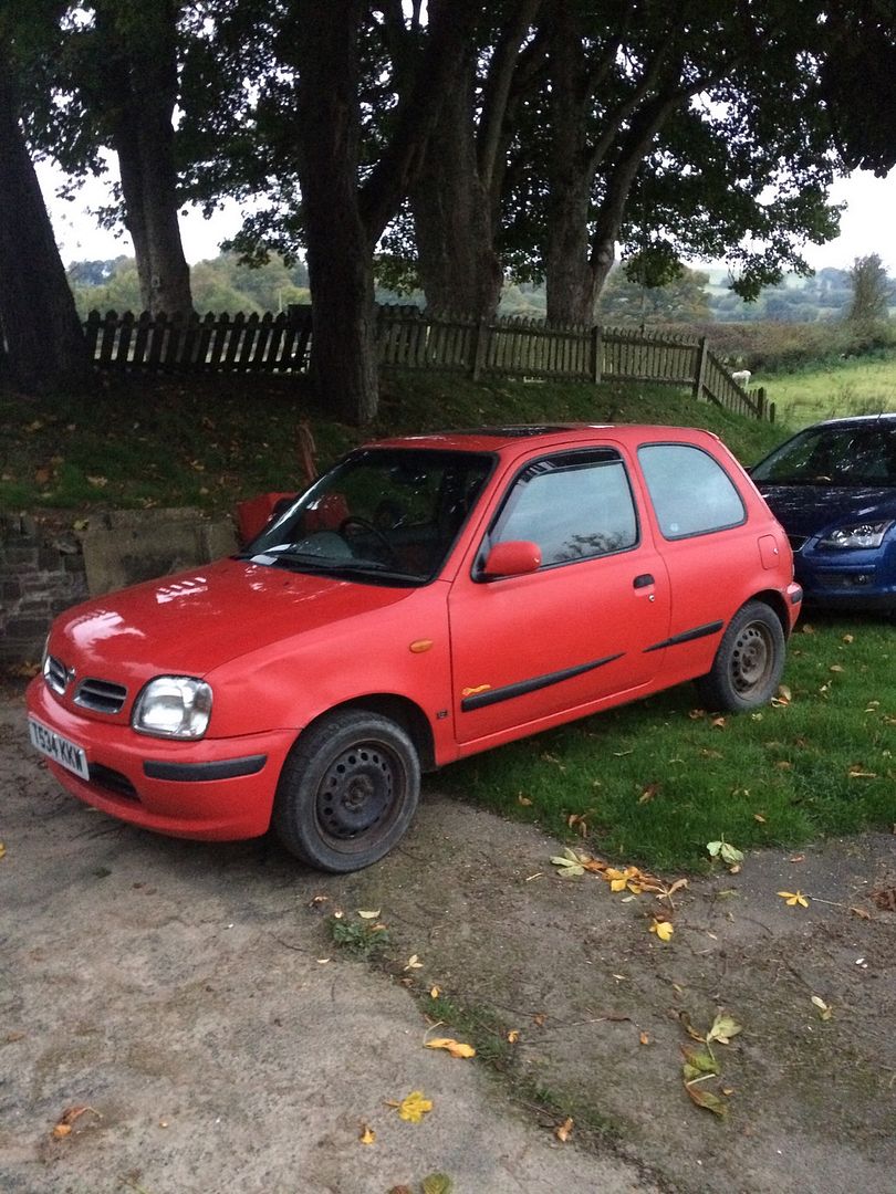

Forgot to add a picture of the beast.
It is the sunroof model which isn't ideal I know but I am going to remove it and cover it up. Sills are rusty so making my own sill asap and getting that welded in. Apart from the sills rust wise it's pretty good. There where a few areas that had surface rust underneath but I sorted that with a hammer, wire brush and some red oxide.. Lots of work but I think worth it.
Took the sump guard off today to find that the sump itself is leaking, easy enough to fix ?
Also I would like to move the position of the bucket seats, they are bottom mounted can somebody please show me how they have done it ?
Also when shutting off I am getting a knock, any ideas ?
Thanks
