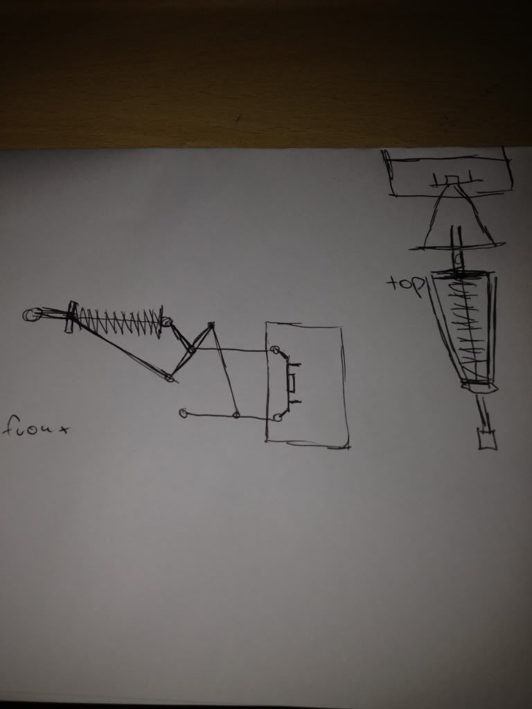

I got another idea in head. I'll draw it and post it later. Working atm
hope that make sense. just another horizontal setup with another arm that would have two rods from each side of the shock pulling a collar at the bottom of the spring as the suspension goes depresses.
is this rising rate though. if the spring is linear wouldnt this set up maintain that linear spring rate.

Small correction - ALL motions in wishbone bases suspension designs are rotational.
All geometries cause some amount of rising or falling of the rate of compression of the spring - sometimes even one then the other.
You have to watch the angles between the links to establish whether the rate is rising or falling. Most of the angles in the line drawing are closing as the wheel bumps therefore causing a falling rate. But, because both ends of the spring are being actuated the net result might be a rising rate. It would take some maths to work it out.
