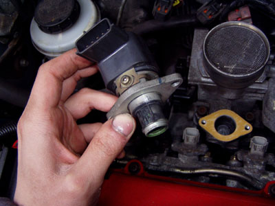

perhaps sticky dirty slow-reacting or mis-calibrated Idle Control Valve and/or stuck fast idle waxstat mechanism?
c725uz-206-jpg.30685
http://micra.org.uk/threads/pollymobiles-rebuild.35251/page-19#post-446256
