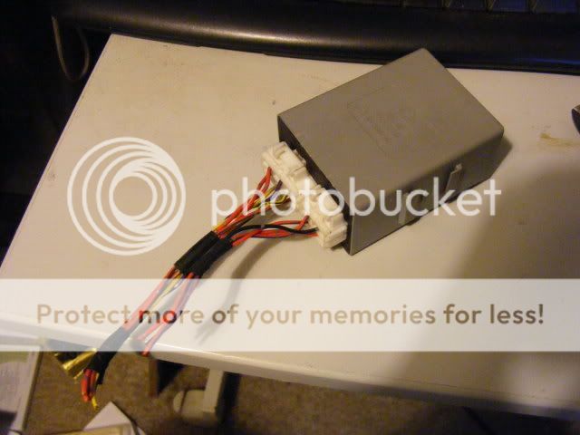

try to disconnect the box which controls all the sounds when you open the doors or reverse etc. it looks something like this
Its located underneath your steering column by your feet. You can undo little bit of plastic with two screws and the box should be attached to it.
Sounds like its faulty. Your car can function without it

I can disconnect em all? It's only the sounds? i'm not gonna get any surprises? lol
