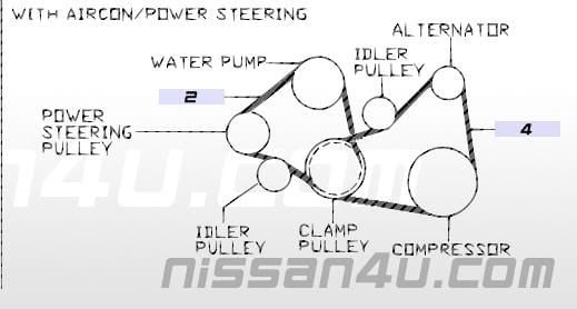

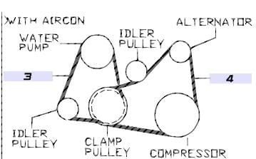

I was going to try take the front bumper off. But looking at that photo, I can't see how the belt is going to reach the second idler pulley once I've moved the alternator down. And I'm kind of hoping I can use the original alternator mounting bracket as well
Remove that idler pulley it runs from crank to alternator thats all as the alternator is adjustable for the slack! I have the mountings and a belt that you need
So are you basically saying that I don't need that idler pulley, then? And how much do you want for that? (Y)
