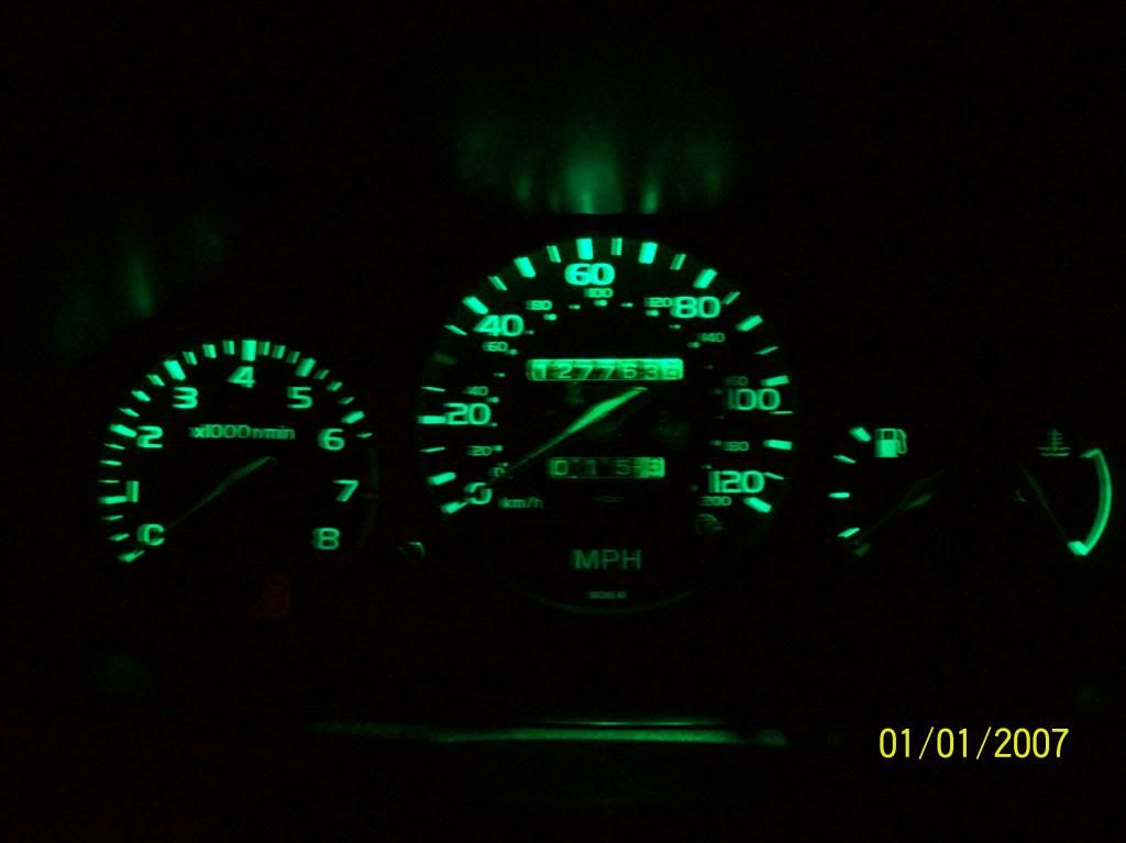

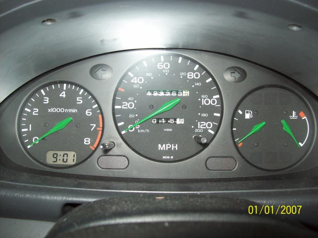

She is a real nice clean car! Few dings here an there but its what to be expected for an oldish car. I then bought some super s clocks off of jasperfox on here, they already had a green led conversion:
Ignore the date and time haha, whilst i had them apart changing the mileage over i painted the needles green:

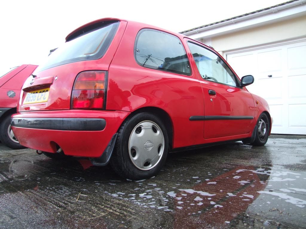

Then came the lowering:

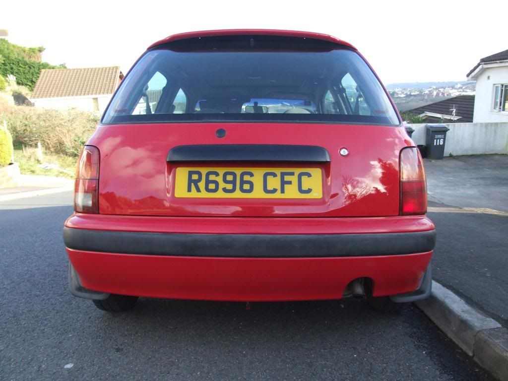

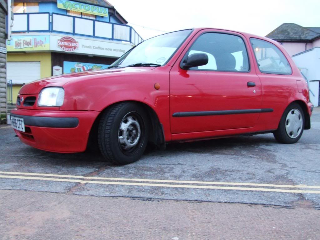

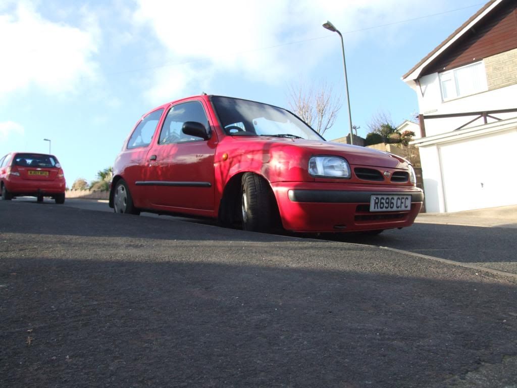

Setup is: matiz front legs with spring perch dropped on the front and cut springs with corsa dampers on the rear (Bought the front struts and rear shocks of leon on here). The ride is lovely and gives really nice lows! Then I de wiperd it and put a pre facelift boot handle on (Thanks jay for the grommet):

looking good, suspension set up has it sitting nice and low. quite surprised actually. did you have to do much work to make it all fit?
Thanks :)! No not really tbh just gotta use the micra strut top mount drilled out and file out one of the bottom strut hole because they are slightly closer together on the matiz strut.

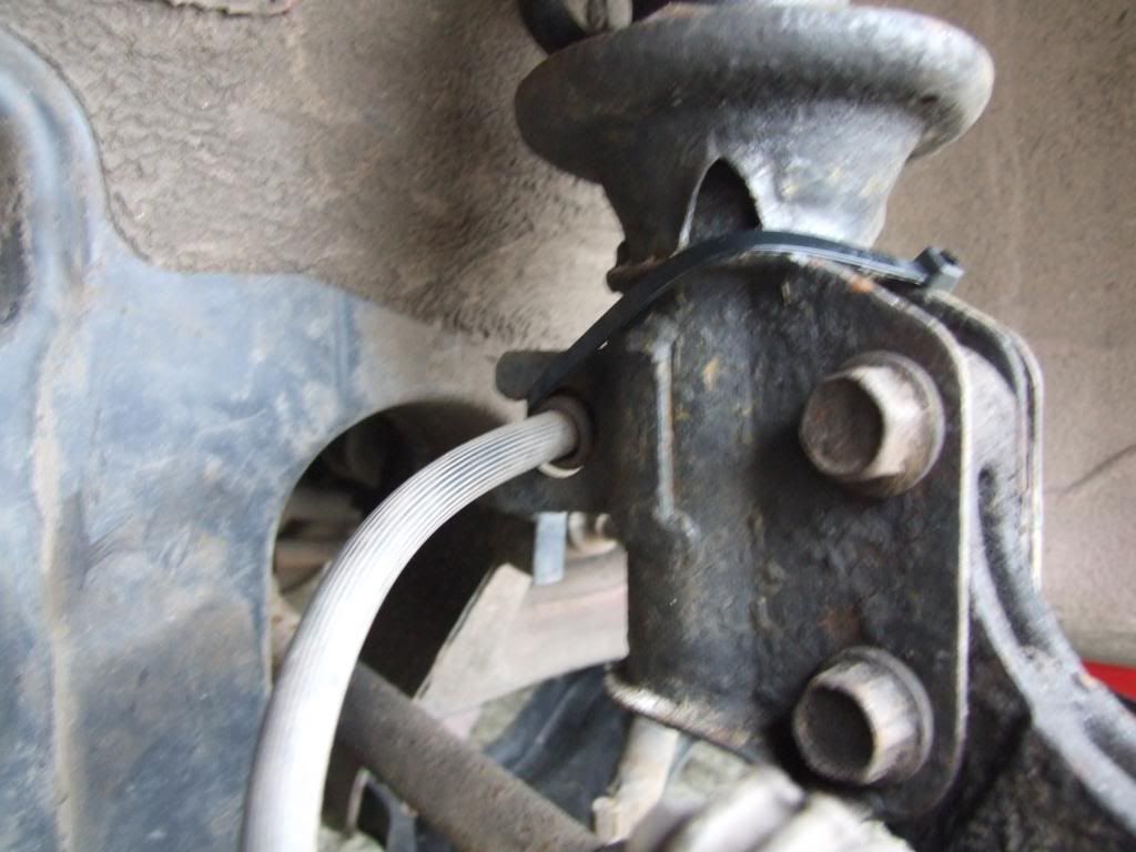

Tiny update. Had a clunky grinding sort of noise coming from the front passenger side lately so i took the wheel off today to have a look and the clip that holds the brake pipe in onto the strut had come off so the brake pipe was just floating around so i got the cable ties out...

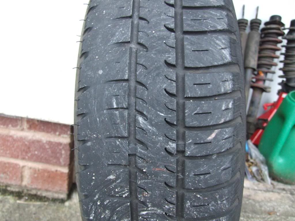

Secure for now but im gonna get another clip soon. Im also gonna need some new front tyres because of the negative camber...
Just legal imo, What do you guys think?
