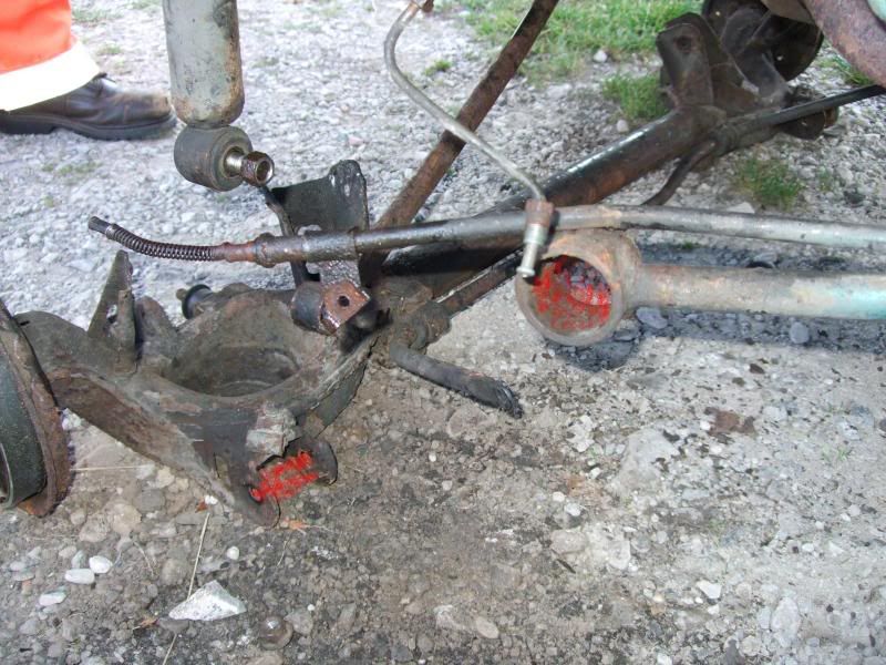

Hi all, i decided to replace the rear axle with 1 from the scrap yard, i just managed to get the old axle off and get the new axle ready to go on, so i poped down to local parts place and shown them a pic of what i wanted(the lower rear drop links) and they sent me to local nissan dealership, i nearly fainted when the dealer said 105QUID each, any 1 no any were or have any spares kicking around for sale??

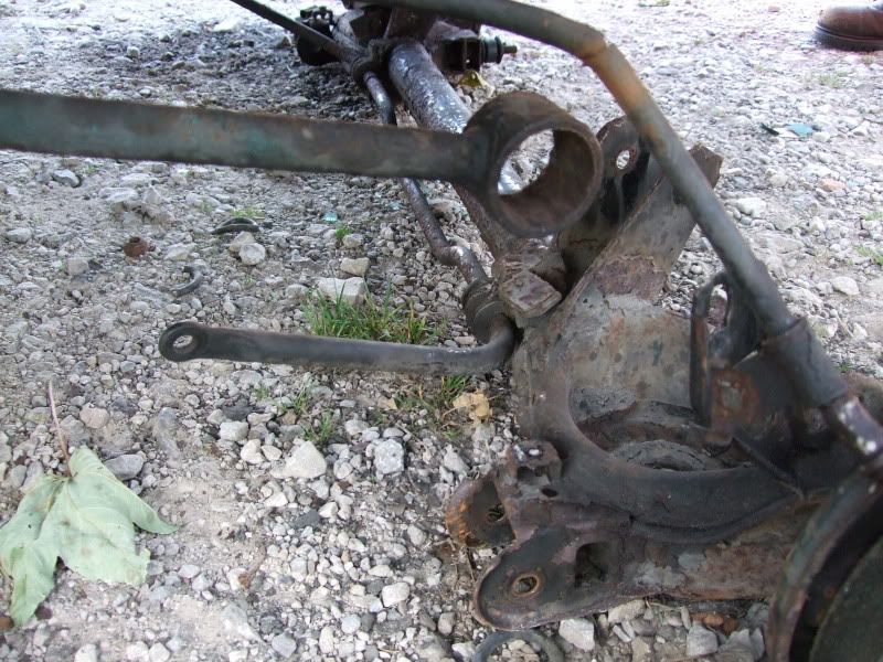

hi, well the nissan dealership was showing me there parts book and the part i needed was complete with the full bar(see top pic) with both bushes in,.. are the lower link bushes the ones that are in the top pic?
That's the one I thought you wanted at the start, a lower link to axle bush, £23 something from Matt in the first link, I guess new nuts and bolts will be extra.
jamie, i have a spare pair of lower trailing arms after i replaced mine with some whiteline adjustable ones. got some spare nut & bolts too. you could have em for say £50? + p&p
i originally brought these from me local breakers for £90 during me restoration (was hard to find cos they're mostly rusted on) but after recently fitting me janspeed exhaust system i had to replace em with adjustable ones in order for the axle to clear the backbox.
