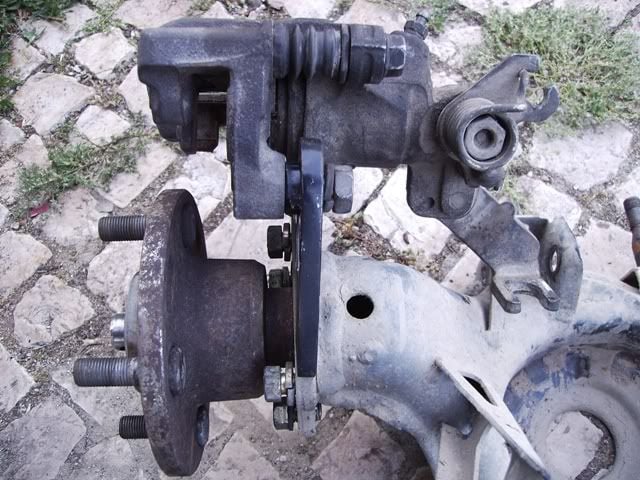

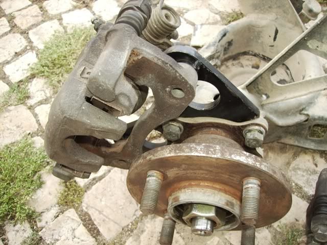

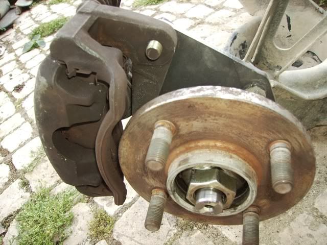

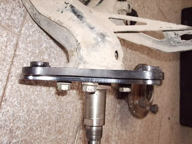

Right, i tested two types of brackets, but they dont seem to set the calipers to the right spot.
Brackets for stock front calipers, to use with hydraulic hand brake:
NME brackets, to use with stock rear calipers, in my case, N16 calipers:
There is something wrong as the calipers dont sit on the right place... :doh:
What do you sugest?
Can you not just space the caliper out? like 10mm to suit where the disc will be situated?

I think you will find there is nothing wrong with the brackets, as they are for retrofitting K11 rear callipers, (Matt's Kit). N16 callipers have a different offset, so won't line up :(
A link to polly's thread showing rough offset dimensions is here, (see post #100) ---> http://www.micra.org.uk/threads/35251-PollyMobiles-Rebuild?p=384411
Scott, yes, they are from Matt (rear calipers), and the other ones are eBay ones (to use with front calipers, and hydraulic handbrake).
R-REG, they are made of steel. I will keep you posted.
Low Rider, i thought of using GTi-R rear discs, they have the same dimension of the N16 ones but 4x100 PCD, but they cannot fit with the current spacement, will foul on the calipers. Yes, i saw that post from Pollyp, will check the dimensions tomorrow.
Frank, seems that i will get my hands on a Brake catalogue soon... :laugh:
Thanks guys. (Y)

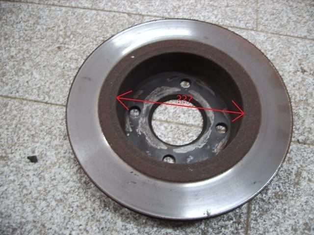

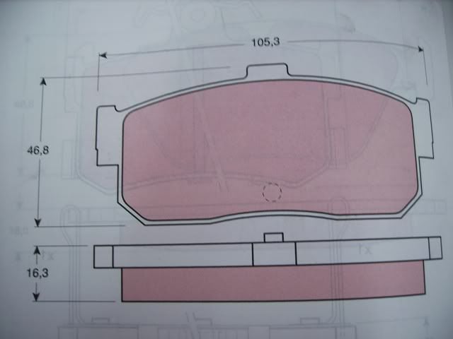

Already put the two types of brackets side by side on the axle, so i can make some hybrid one, to bolt on the axle (like the one to use front calipers, instead of welding like the NME ones) and with the NME spacement to bolt rear calipers. And it seems that i will have to use N16 calipers with N16 pads, and K11 rear discs:

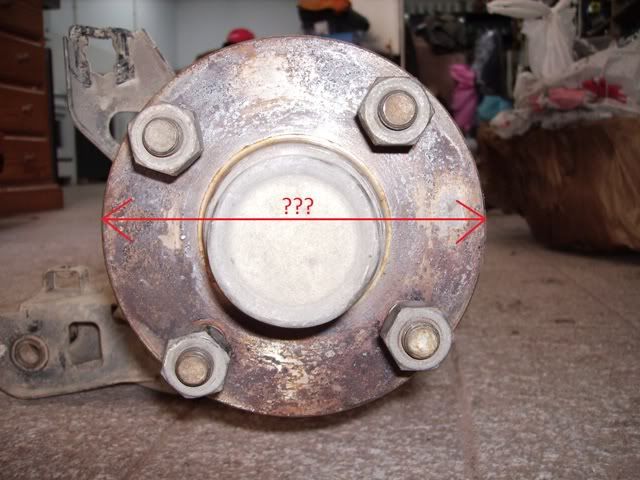

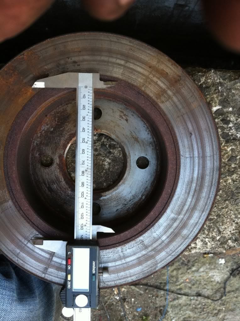

What i need to know now is, does anyone have the measurements of the following pics (but on stock rear discs and hubs)?
Bosh
I make the diameter of the rear hub to be 135mm.
And diameter of the disc to be 138mm
Hope that helps, if you need anything else let me know!
