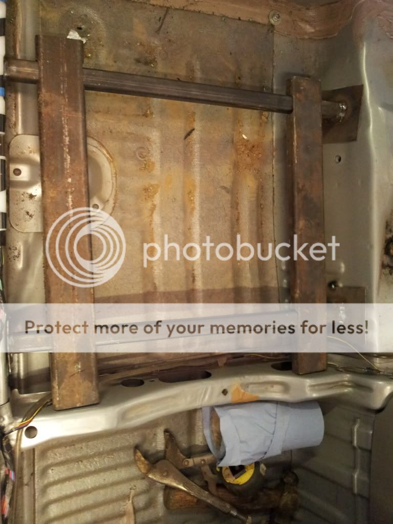

Seats will have to be fixed, mine are done with the bars welded s the inner sill and exhaust tunnel

Mine are floor mounted, need plating underneath though. Passenger side is best as there is a recess to allow you to take the wiper mechanism out - there is also a routin into the cabin where the heater/blower used to be (if removed)>

My seats are bottom bolted to a 50mm sq box section in turn bolted through the floor with large washers. Probably not to MSA stage spec but adequate and mega low.
