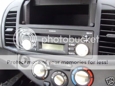

hi, just wondering how to remove a cd player from a 2006 nissan micra k12? as i have lost the code and need to get the numbers from the cd player, i have heard some cd players can only be removed if the dash is removed first, i have a photo of what the player is like so if anyone knows how to remove it i will apprieciate it, thanx

the cd player is bolted into a cage i`m guessing you do not wish to to change the player so i will only give the instruction for removing the cage which should enable you to see the info on the back
this is very simple there are two screws above the heater controls
and two screws inside the cubby hole bit i think these are behind the little clips shown at the top of your picture it should then just slide out you may however need to give it a little tug as there may be some clips behind re insallation is simply the reverse if you experience any difficultys let me know and i will check my workshop manual
hi, thanx for the reply, i did try this the other day because i had found the screw where you said, but it just didnt seem to budge, so i will try again tomorrow, thanx again
just had another look at the manual there are two clips right at the top edge that you will need to disengage best way will probably be to take the four screws out then pull it from the bottom edge upwards then you may just need to get a long screwdriver in to undo the clips that are directly above the air vents

think the image uploader for attachments is working now i think i know the one`s your on about now to remove the headunit from the cage would it not be possible to read the numbers off the back without removing it from the cage ?
