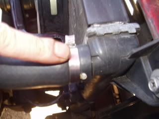

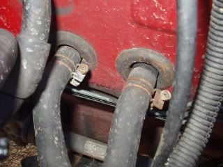

Mirca 110 cheers for the pictures and advice, will be following it shortly. I did loosen the right pipe in the first picture, but no air was present.
In the second picture, i have done that and water and air did come out, but ive since taken of the pipe again, so i guess undone that! Is it normal for that pipe you are holding in that picture to be very hot to touch? Just seems to be TOO hot to touch, thats all.
edit: also does it matter if the pipe snakes up and round a bit (problems with coolant circulation etc.)?
The top hose can get quite hot. The pipe you have there was probably bought from Halfords? looks a little longer than normal but i can't see there being any problems unless the Pump is old and worn and can't handle the extra amount but i doubt it.
