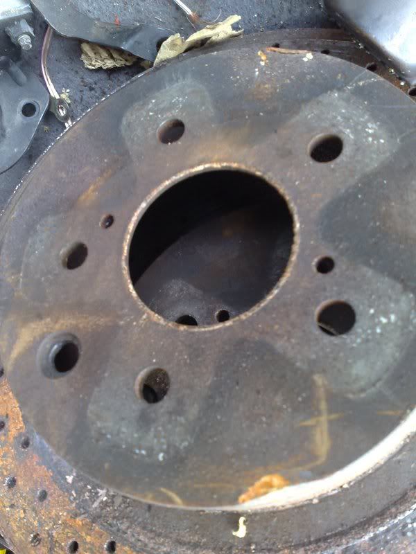

My Pulsar brakes got delivered last night and they dont look like the other ones in this thread.
They're 5 stud discs for a start!
Im really confused o_O
Pulsar brakes don't have the nissan printed on the calipers, along with the 5 stud holes in the brakes make me believe they are early skyline brakes or something.
i highly recomend GTIR calipers....even with stnadard GTIR discs and standard pads there good! mine stop awsome (3G 257mm vented and grovved discs and stainless lines) when raceworx had them he had the back end up off the floor! awsome for track useage and are the ultimate road useage brakes for the micra.... id reccomend ebc red stuff pads..are crap when there cold, but when warmmed up they bite hard! ive heard green stuff are rubbish.
although if you want ultimate track go for some wilwoods :p but the micra is THAT light there not needed unless you have an sr20 in.
they look like 200sx brakes to me. though i could be wrong.since you've got them, try and see if they'll fit on the micra hub, then measure what size discs you need if they fit. and try and get some to match, like the mitsi fto caliper/clio 172 disc combo someone mentioned off the almera oc.
Ok confusion sorted! My mate gave me R33 rear brakes by accident, I didn't bother checking them when i got them because I didn't think he'd be daft enough to give me the wrong ones lol

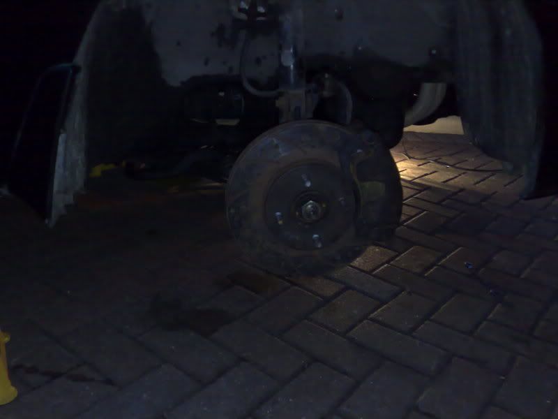

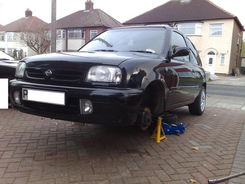

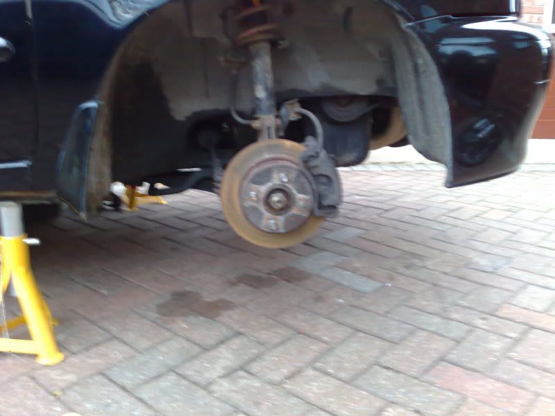

Got the brakes done in about 45 mins before, didn't manage to get them bleed up either as I didn't think I had any brake fluid, then found some as I was packing everything away, sods law!! It had gone dark too so will leave it till next time I'm working on it to do that :)
Before
Little during shot
After
Will give them a lick of paint too while I've got the wheels off to bleed them.
Cheers to everyone in this thread who's posted up too your help has been much appriciated :)
Your car's damn clean. Love it. Black car's all the way..
And well done with the brake conversion.. :)
That's just the camera, it had a wash yesterday but wasn't dried. I still need to wash it, dry it, clay it, clean it, polish it, then wax it :D
Its got a couple scuffs and scratches but I can't really complain for the age of it :)
Will get some more pictures up next weekend when I hopefully get the gearbox done (was meant to do it this weekend but was let down by a mate) and I'll try and give it a good scrub too and some better pics :)
