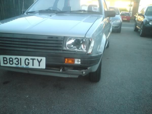

Heres mine with prefacelift front end but using facelift wings
I didnt have to do any modifications for the front grille or bonnet hinges to fit them. Nor did I have to get the bonnet catch.
But you do need the headlight aim adjusters for the prefacelift front lights.
