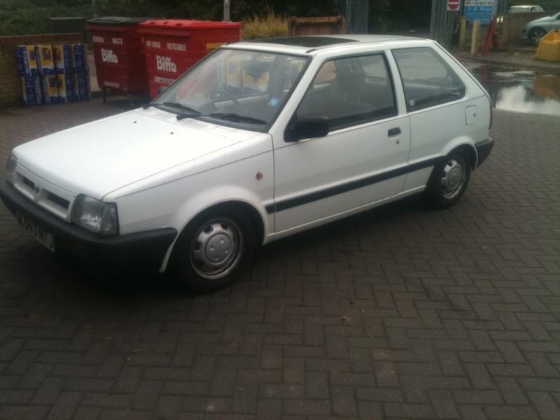

had to sell the car 2 years ago to my secretary at work, got £400 back for it. the exhaust broke on it so she took it to kwik fit who gave the little old lady a quote of £430 to repair it!!! so she got herself a new car and was gunna sell the micra to the scrapyard, so i took it of her for £100 :grinning:
so now that iv got it back im gunna start on the things that i was gunna do in the first place. first was new exhaust which came to £130 fitted at local garage (kwik fit you THIEVING #####)

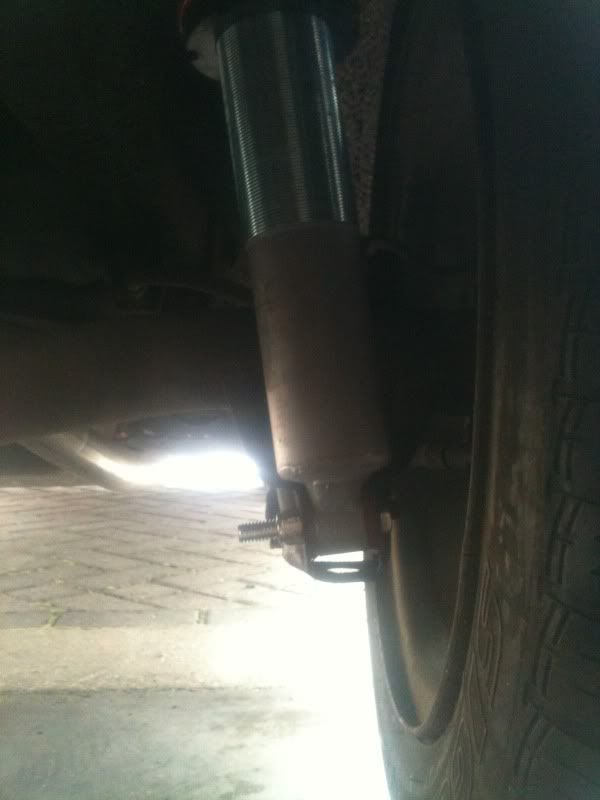

this car is driven daily so decided to do the mods to the shocks to save the car from being off the road, plus it worked out a much cheaper way of doing it.
i have NO mechanical experience so everything iv done was due to looking on this site and is easily achieved for very little money too and very few tools, majority of the work involed a couple off spanners, my dremmel multi drill and a can of wd40, and by myself!

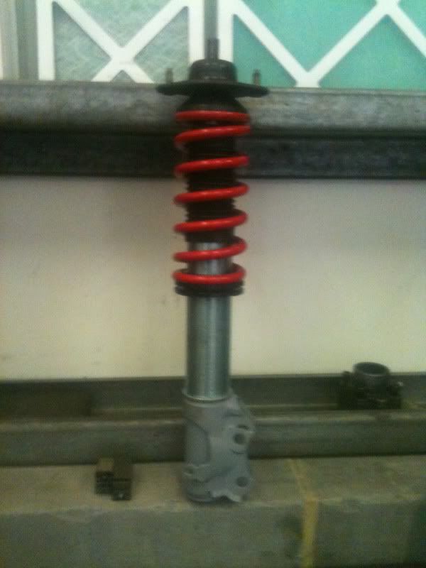

so.....after looking into it a bit on this site i got some polo 6n coilovers from ebay for £169.

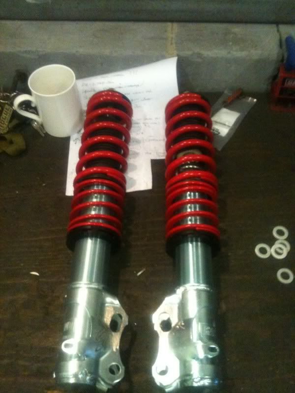

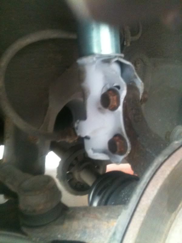

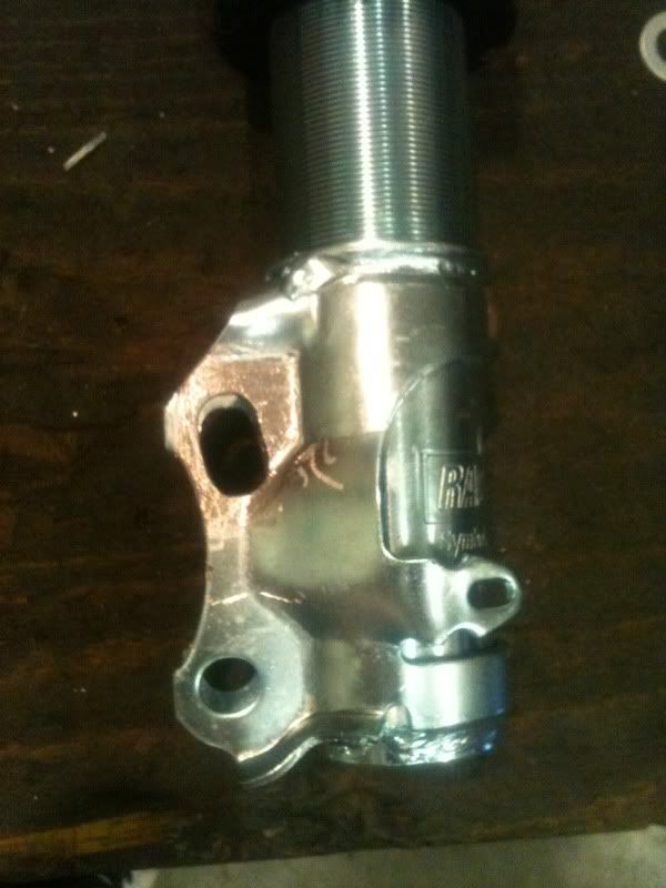

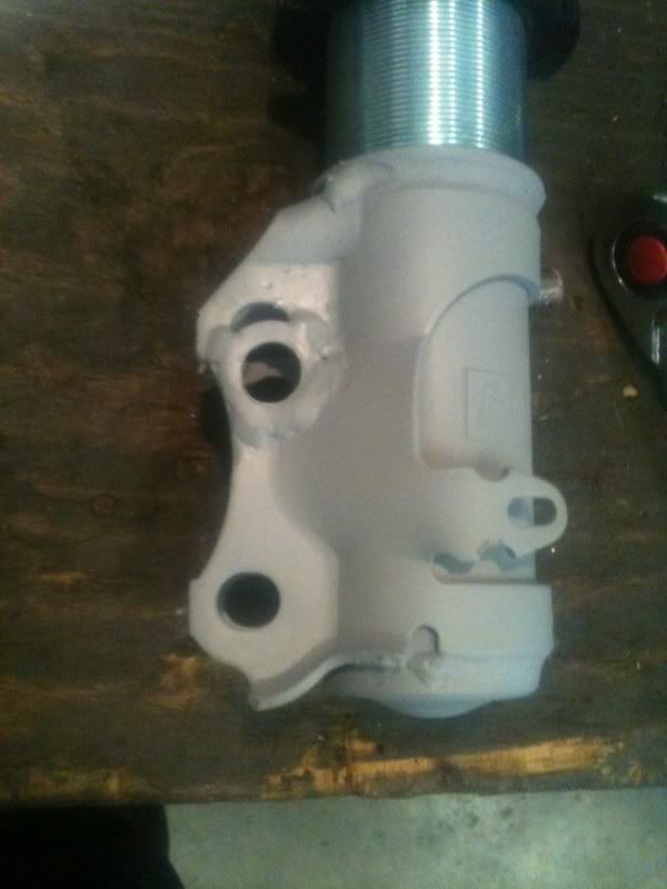

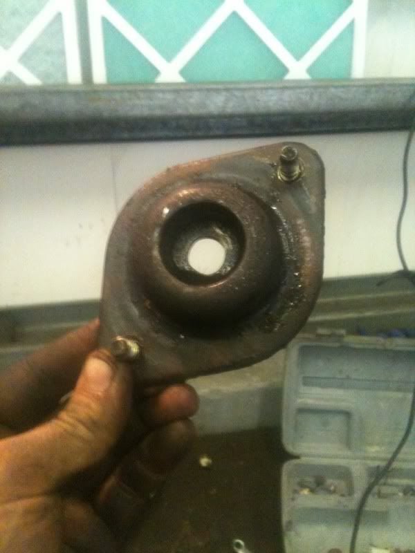

FRONTS:

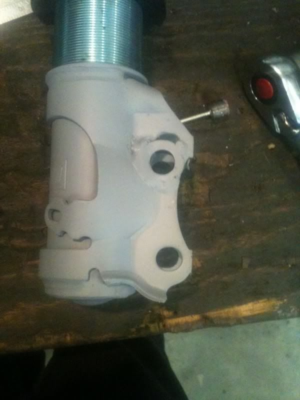

drilled out new hole for the top bolt
bloke across the road welded on washers for free to strengthen up new hole

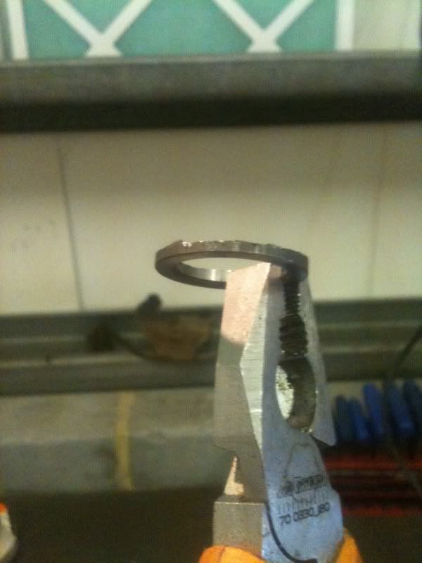

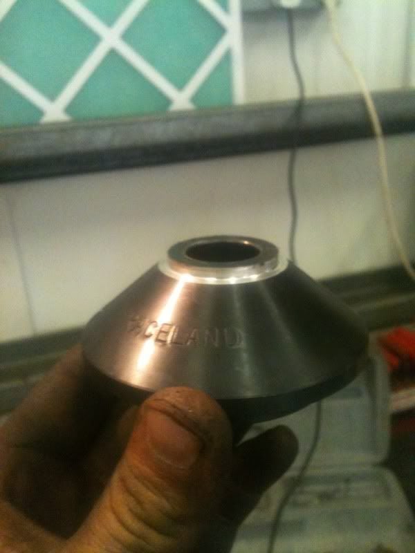

this needed stickin on a lathe to fit into top mount
drilled this out to 14mm#
assembled
fitted to car

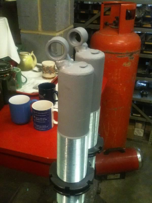

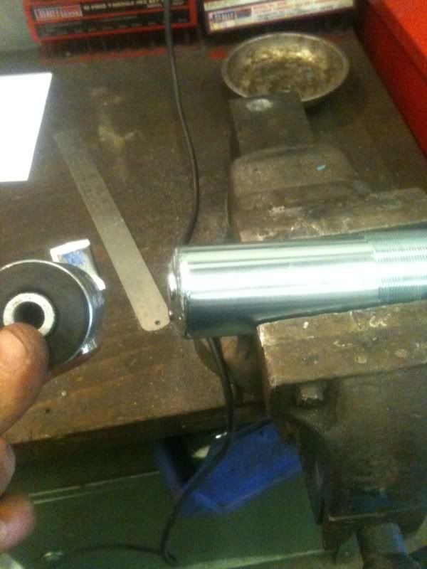

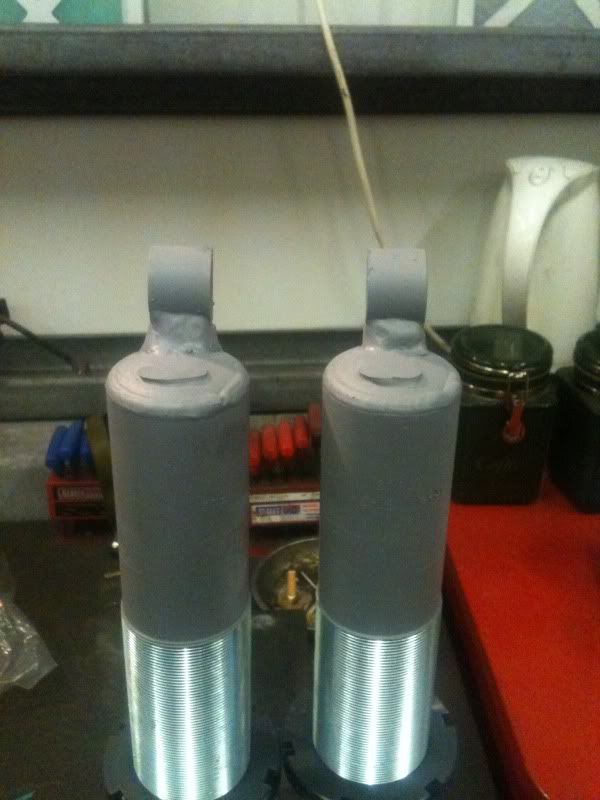

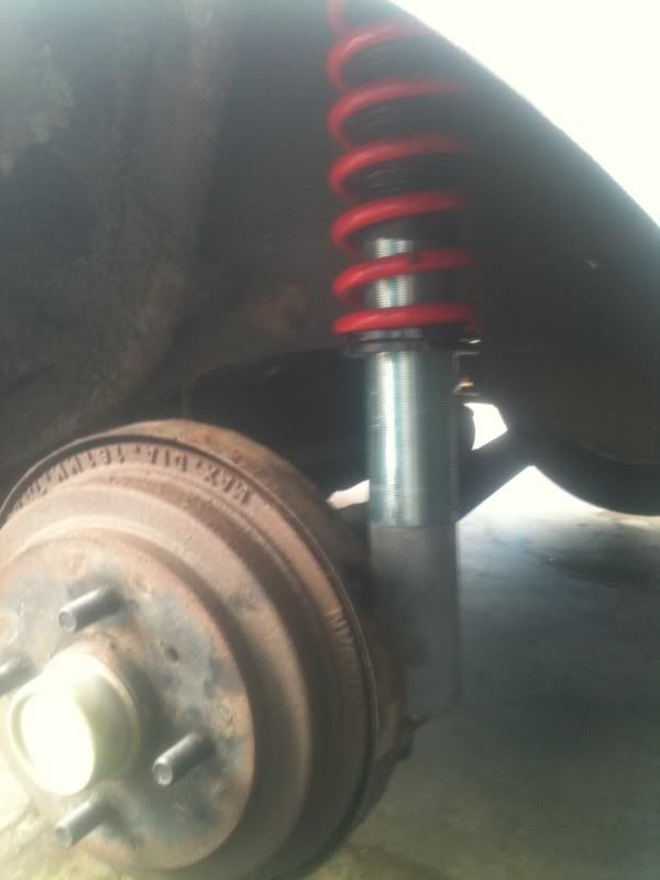

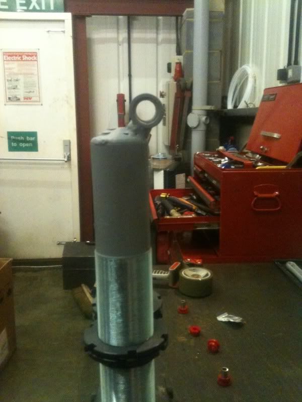

REARS:

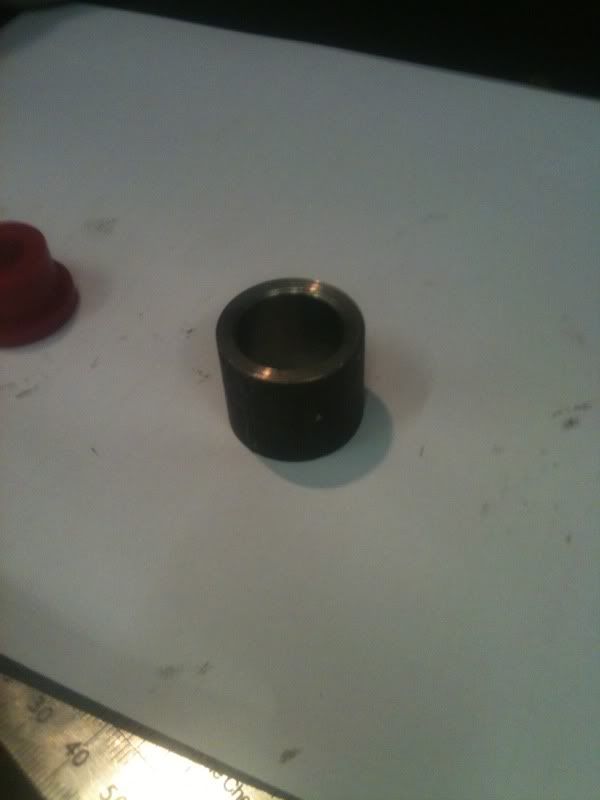

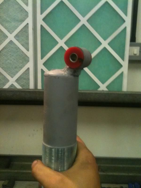

hacksaw off old bush, the original is to big, and the strut itself hits the axle so a new one has to be welded in a different place
purchased universal hotrod suspension bush kit from superflex. this is the kit originally for the triumph spitfire £34 delivered.
kit contains sleeves, bushes and crush tubes
even tho this is the smallest bush and sleeve i could find, it still needs to be trimmed down to fit the axle mount
payed a proffesional welder to weld on new sleeves. £20
fitted bushes
fitted to car

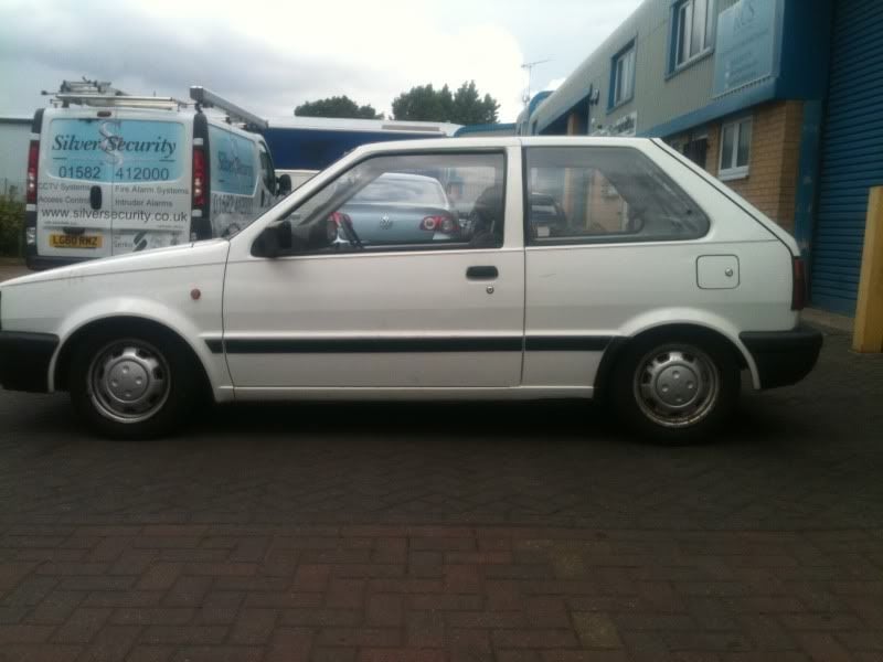

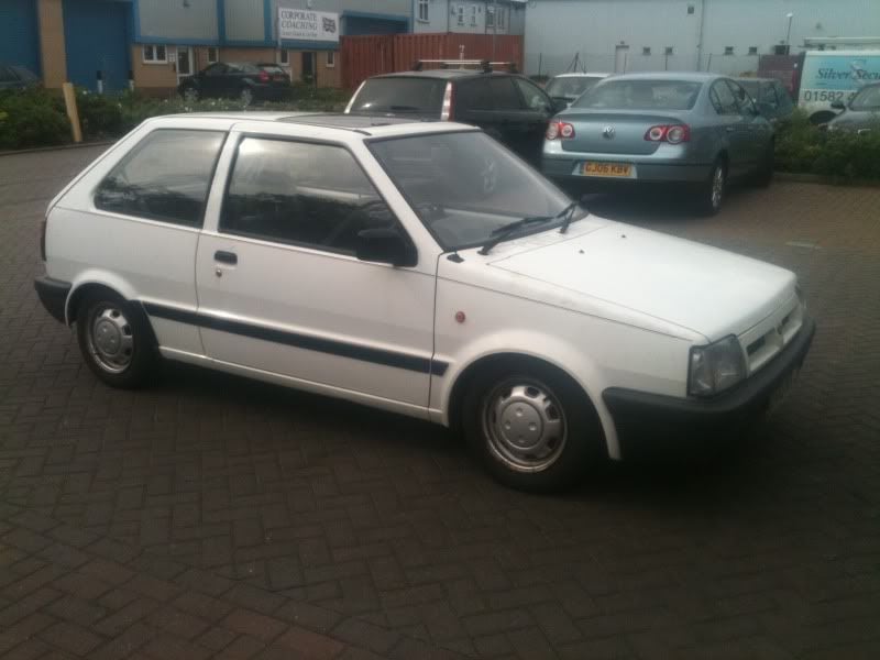

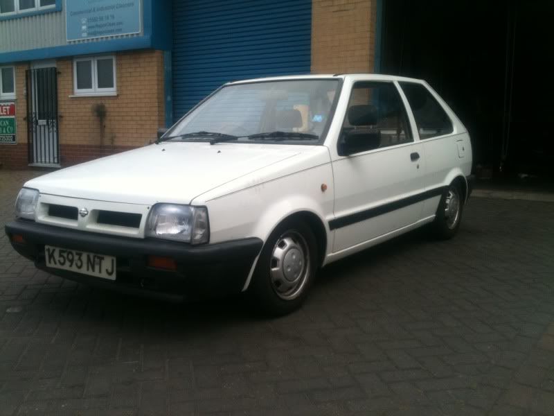

i have at least 3-4 more inches i can drop the car down by, i done it earlier to see how it would look and it was stupid low!!! the arches were sitting on the wheels, forgot to take picture though!!! but we live in england, the land of massive speed humps and even bigger potholes so this is how shes sitting at the momentv while i decide about what im going to do with the wheels......banded steelies i think:grinning:
its mega solid, the only give is in the tyres, havnt had a chance to have a proper thrash around yet, gunna wait till iv got my cbr600 carbs fitted........oh yeah, then tax and insure it....doh!

lookin good pork (Y) and you did a grand job of those coiley,s :grinning:
cheers, wasnt as hard as i thought it would be. managed to take front springs off jus fine with no compressors too, no injurys lol thanks to everyone who gave me advice
handles like a little go kart(Y) jus need to sort wheels out
