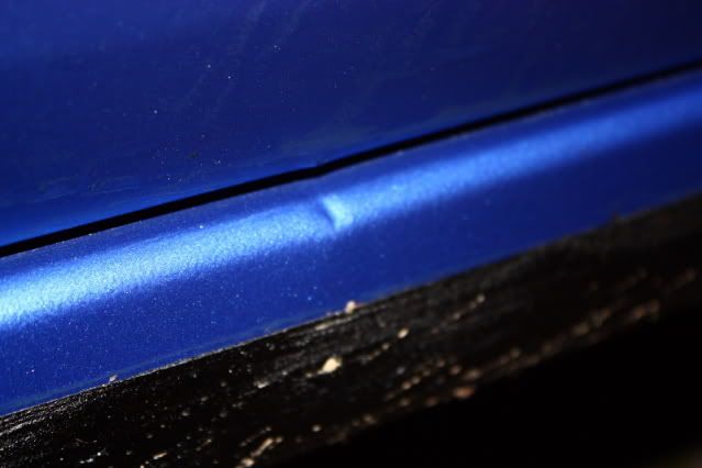

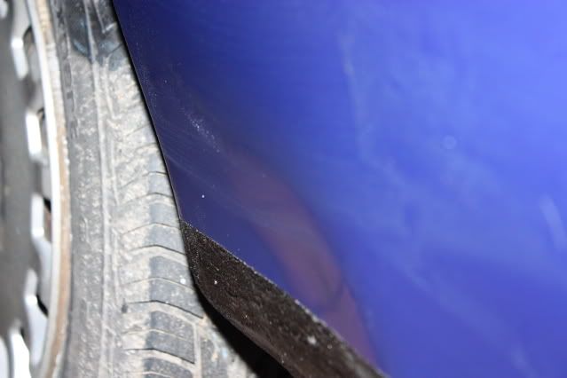

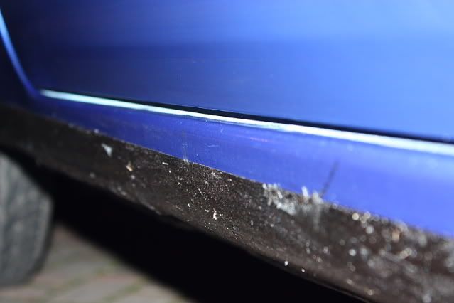

I've just got my car back from the garage after having 24" of welding done on each sill. Now I'm not sure how neat they can get it, but to me this looks pretty rough. Plus, it is now mis-shapen towards the rear each side, and there's another dink near the front.
What do you think would cause the mis-shaping?
Rough black patches? Or fairly normal? It's pretty uneven.
Mis-shaped rear
Dink
Any input would be appreciated!
Reeeeally? i'd have thought it would still be the same shape I left it. The dent is over half an inch in from where it was this morning and sticks out a mile. The reason I got the car is because it was so clean and dent free.
Will go up the body shop tomorrow (next door to the garage!) and see if they can fill the dents for me.
If they have put alot of heat in it will go all over just take it back and tell em to pull there finger out im in engineering and I know you can get a far better weld than that
Yes, too much heat when welding has caused the big dent. But the smaller once looks more like they accidentally shut something in the door.
This is NOT good welding and you should not take it lying down. Tell them to fix it at their own cost.
The black patches are underseal and are normal. You could wipe it off with thinners and repaint.

99% of garages will probably think 'pffff, only a Micra worth £700 - no point in putting too much time in on this one'. Having had it done on an old 1.0 LX that fitted that very description, they simply cut out the rusted material and welded in a big plate with a continuous weld, which added a lot of heat and thus warped the panel slightly by the rear acrh. I am not sure what they do with the inner sill but they may also do the same there. As far as I am aware they are only trying to make it meet MOT regs and not making it win a beauty contest. Also I am sure that plenty of shops may not even think about the panel warping either until it's too late, (K11's are quite sensitive to it).
I did my own drivers side sill a few years back and it's a lot of work to do it properly. We cut back both inside and outside sills to remove the rusted material, made up new inner & outer sill elements, joggled the outer body panel to accept the new outer sill so it sat flush. We then fully spot welded in the inner sill, spot welded in the outer sill bottom where it met the main floor pan and finished off the join to the main panel with evenly spaced spot tig welds. This kept the heat load low and was as close to OEM as possible and sat fully flush. It was then fillered, painted and sealed.

Pic one has loads of dirt that has set in the paint. (this may mostly wash off)
pic two has a bloody great dent in it.
Pic three has had a screwdriver shut in the door
