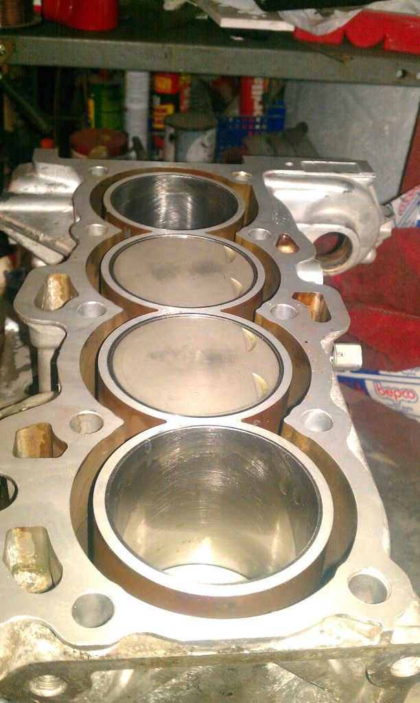

If you are reducing the overall size of the valve spring to increase preload, surely the total spring strength isn't changed, but compressible height is, so you could end up coil bound......
Surely that will reduce the overall cc of the Engine as you're reducing the swept area.... Or are you?
The piston height has lowered but so has the block, so in actuality all you've done is effectively lowered the cylinders in the engine.
Also lowering the centre of gravity.
