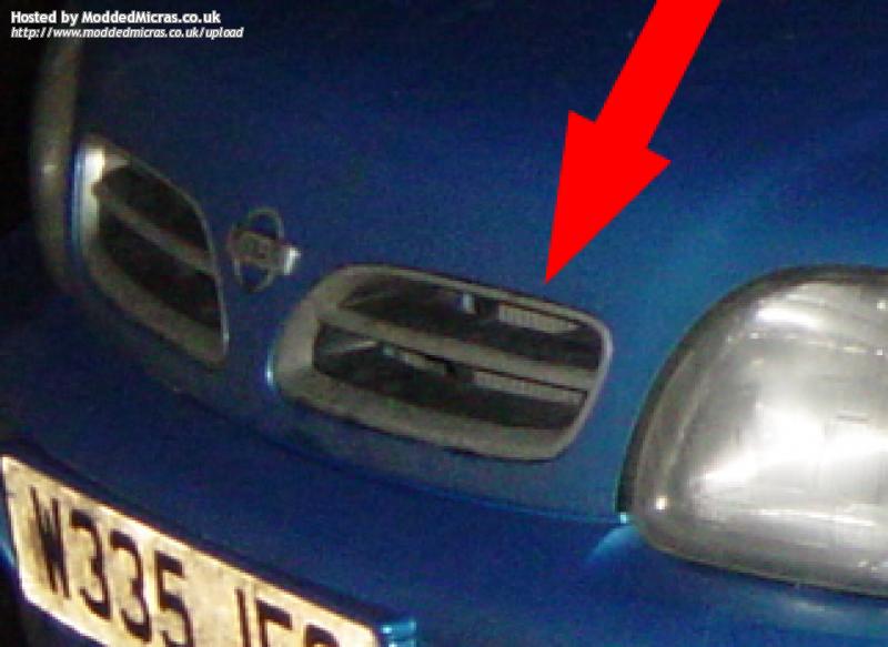

I'm wanting to paint the shiny metalic looking grill on the front of the facelift.
The question is, how do you paint it? What sort of preping will it need? Sand down as usual....?
Any help would be grateful, imo the silver shiny grill is awful and it needs a respray!
Thanks guys :)

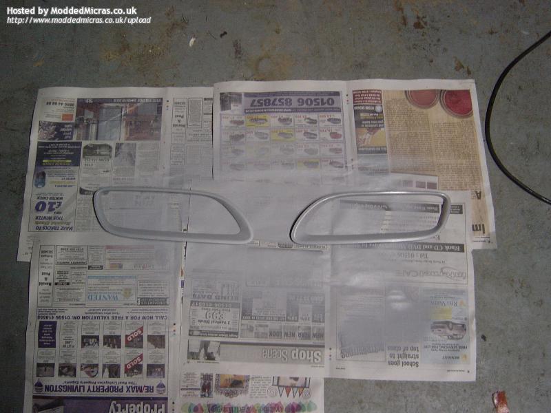

Ended up doing a bit of this today......just done this first coat of primer.

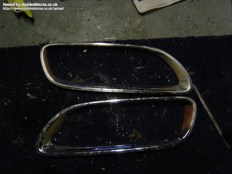

I cut the middle piece out and fibreglassed it over :

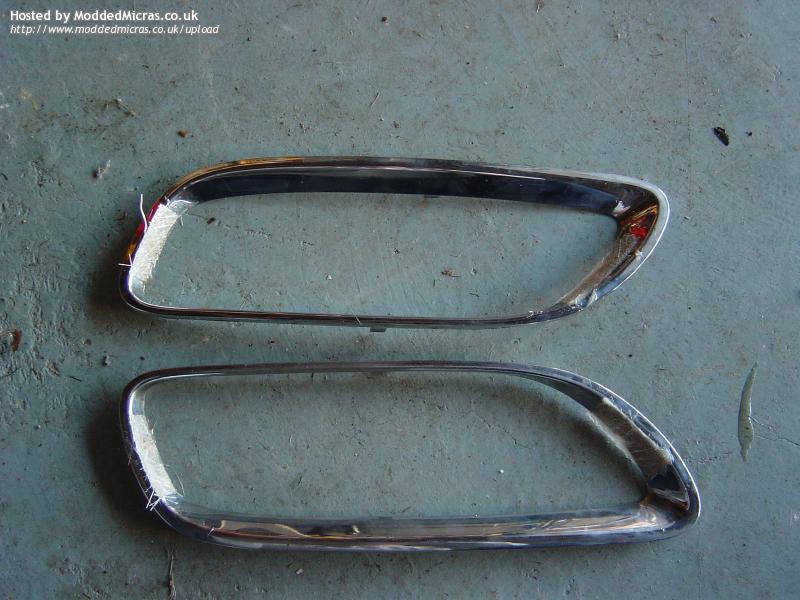

Here is a pic after I sanded down one of the grill sections:
After one coat of primer:
