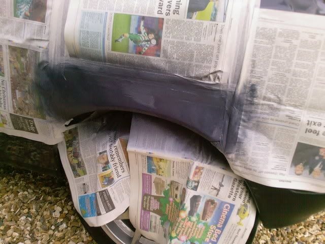

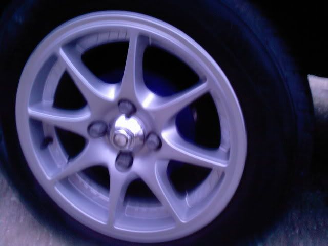

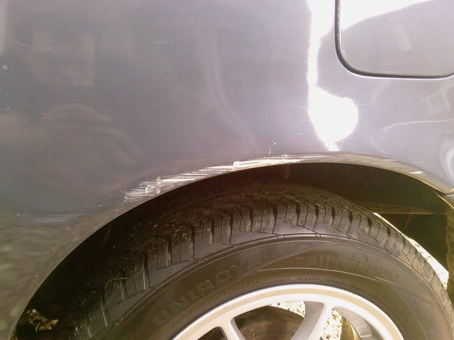

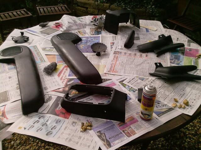

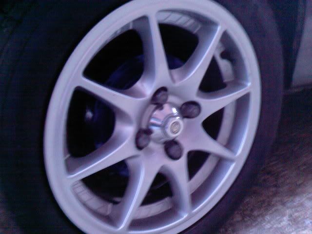

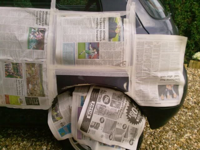

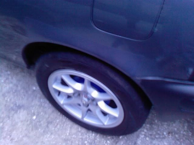

today i resprayed over a massive scratch and resprayed some of the interior parts back, and managed to get the break drums done as well!
PICTURES!
the original damage

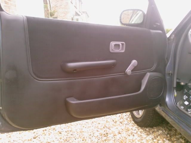

i think the drums came out real nice, but the door cards will need doing again with some real good spray paint i reckon.

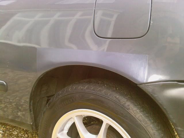

sould have time to put the laqeur on that bodywork tomorrow, and hopefully should blend in with the rest better...
and then do the calipers! :)
johnsams
really your best to mask around the arch, rather than have a square shape, and use a soft edge on the masking, so you get a feathered edge instead of a lip
but hats off for having a go (Y)
yeah i took the masking and tons of newspaper off and thought f***, but i'm gonna drink it off tonight and go to a gig, then give it a go with the laquer tomorrow and try and smooth those nasty edges
