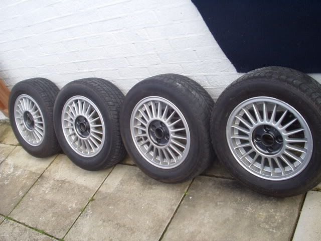

Hiya, i've just bought some OZ wheels with Tyres (185/60/14) for the K10. The Car is a 1991 1.0L model .
I went to trial fit one wheel and found it doesn't. The PCD is 4x100 which is the same as the hub but the Studs seem to be that ickle bit on the short side... lol!

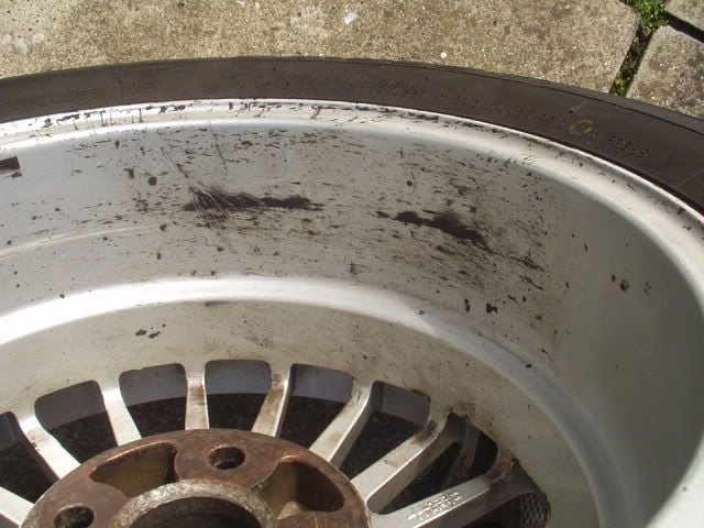

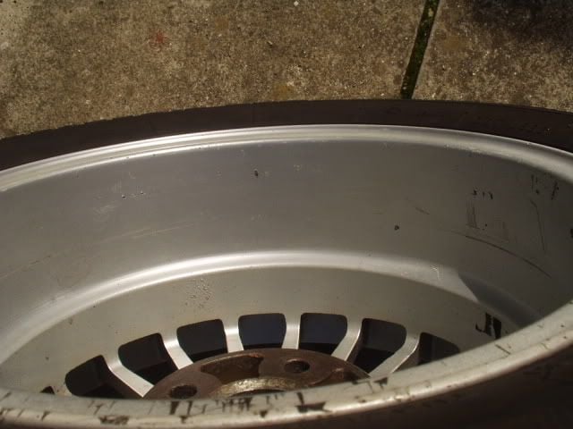

Here's some Photos of the offending items.

personally I wouldn't fit them at all....... Sell them on.
They will have the wrong offset if the studs on the hub don't come through enough.
spacers imo shouldn't be used when you can purchase aftermarket wheels for the micra, there should be no need to use them unless you want to slightly widen the track when having wide arches.
You need 4x100 30-35 offset, 35 being ideal and I think but you'll have to check this the centre bore If I remember correctly is 54.1...been a while since I had my K10.
but please for your own safety, sell these and get some that are a match for the micra, plenty around.

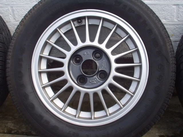

Would anyone know the name of these at all?
I can't seem to find any that look like these....
