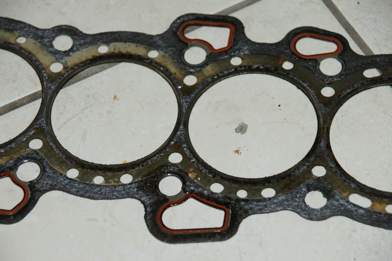

three hours hard working, managed get head gasket out. i am adding some pictures, would you see something suspicious ? I think middle part of gasket where oil and water lines gos, there is look like cracked gasket. just have a look, and say what ya think,

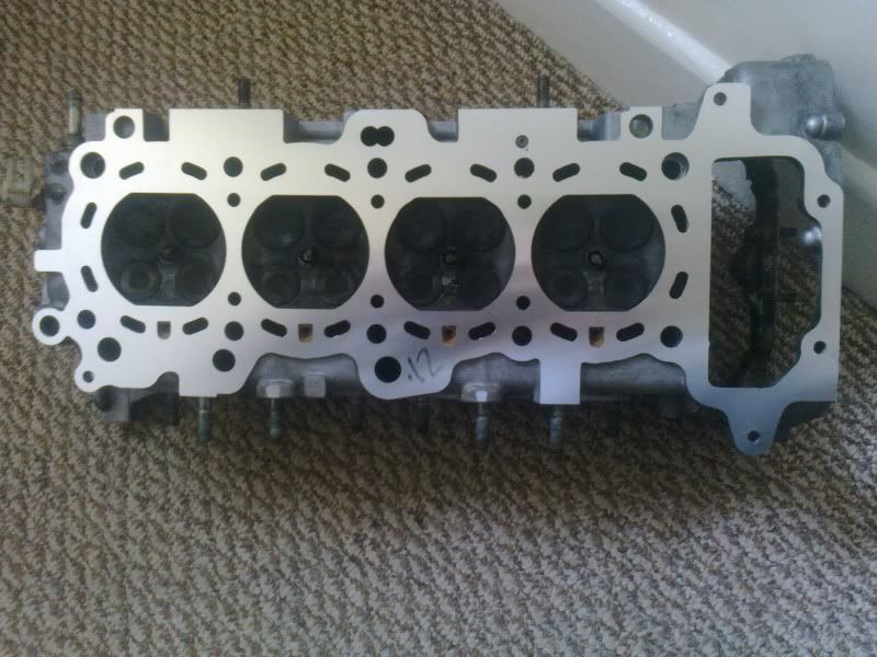

Got engine head back. Nice and shiny :) Pressure tested and skimmed. Al fine.

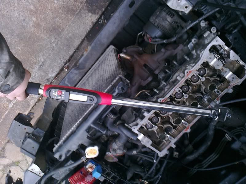

So, some work has been done. Fitted headgasket. As Frank advised , 100 nm, then slacken each bolt, and make torque back to 100 nm one by one, after that each bolt torqued 30 degree, ... actually it make 120 nm.
Spend a lot of time with that bloody chain .... top one. didn't expect itl make so many problems. i hope i fit everything back properly. .... crankshaft pulley on second mark(TDC), inlet pulley mark(hole were pulley notch slide in) look 9 o'clock , exhaust looks 12 o'clock. i hope that marks on chain (silver and bronze ) doesn't play big role , as they were in wrong positions .
Tomorrow goin fit exhaust and inlet manifolds, connect everything back and fire up.
some pictures
torquing ...
