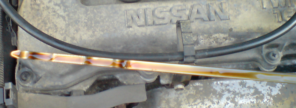

I was doing some paint jobs and other stuff on the car today so I checked the dipstick again and I think I did maybe over fill the oil that day. Is it right that the maximum level on the dipstick is where the indentation is on it? My oil level is a good inch over that point. I've only left the car idling once after I did the oil change for about ten minutes so it's not been driven at all yet.
yeah the indent is the top of the textured metal part.
over the top is not really a good idea if you plan on thrashing it.
There's normally a cross-hatched area on the stick Tezz between the bends. Where's the level compared to that?
I'd loosen the drain nut off and, with a bowl under it, undo the last thread by hand and carefully let half a pint of oil out and screw the bolt back in quickly. Keep checking 'til it's at that last bend :).
Thanks mate, I'd best do that tomorrow. My fault for rushing it at the end of a long day.
I've just took a photo of the dipstick as I'm no good at describing! (This was about 4ltrs btw)
