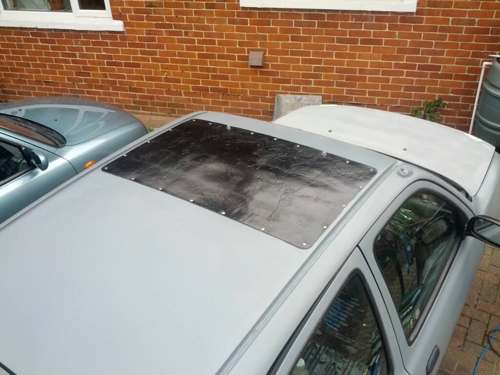

so after that i decided that i wanted to delete the sunroof, it wasn't leaking or anything but seals were green and i dont use it, i want to know if i could manage it because i wanted to do it on the mk4 fiesta so thought now's my chance to try :) came out ok, i basically made a baking tray with the rads made roughly and tried to get that in the gap left, it nearly worked but it was a bit off lol, i was hoping to push it in then tack from middle of the edges outwards evenly but ended up doing an edge then working the panel in and moving along, warped a bit but ive bashed it out fairly well i think, theres one bit that pops in if you push a bit but it forces itself back out so thats good enough for me. the lip further toward the boot i bent flat toward the boot then i simply stuck a big singular piece of sound deadening stuff on, i started from windscreen near the mirror, working along the spine out out to the doors, it worked out quite well as its made the shape easiest to make a new liner, i put a piece of insulating foam i had lying about inbetween the front lip of the sunroof area and the edge of the windscreen area as there was a pocket there which became flat with the foam and deadening.
https://www.dropbox.com/sc/y031bbcehzny2z0/QSPB1Cj-s5
think its come out pritty well i need to sand the roof and do all the filler next then i can paint it matt black :) also got a standard fiat somat arial, just a standard whip ariel nothing fancy but gonna put that in the middle :) with the deadening you can give the roof a bit of a thump and its not echoey or anything thing so im happy enough.
