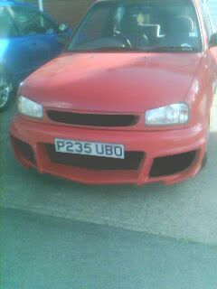

Will do so Nex, Just got phone line in my new crib, just signed up for broadband so will do it all once i'm all set up.
I've only fitted bumpers so far, ran out of paint for the skirts! Need to get some mesh aswell, If you look beyond the bumper it looks a bit pants!!!!
Skirts should be fitted this weekend, it does looks a lot nicer than standard though, Have been getting some strange looks though, hehehe
It's a rubbish picture, but it's the only one i could find!

OMG that looks the dogs!!! you did a better job than that other one, no pannel gaps at all! well done :)
can't wait to see that all finnished up, it will have to be added to the "Nicest k11s in the club" list lol :)

Thank you very much,
The mounts it comes with are total crap though!!!! We took the original metal mounts off, grinded them, hit them with hammers etc, drilled new holes and it ended up really good!!!!
It's come up with a nice finish as well, considering we only used spray paint cans, it does deffo need the mesh though!!! I was thinking black mesh :)
The rear was mor of a pain in the rectum though, there is only places to mount it on the sides so it dipped in the middle. so we just put a screw though the bottom into the boot latch area. The rear had a nicer finish though, 2 layers of filler primer (sanded down after each layer) 2 layers of red primer (sanded down after each layer) 2 layers of Nissan Flame Red AJ4, lightly sanded after the first layer!
I'm also going to change the grille, hack the middle out, re-spray it (it's well discoloured) then mesh the middle!!

with the grill done too thats going to be such a bad ass car :)
i have the open mouth second edition grill to and it it's a nice touch. also fill in the badge it makes a big difference.
black mesh would work sooo well. i got some crap mesh from helfrauds and sprayed it black and it looks sooo cool :D also with the red neons behind it you get little red dots like an LED display and it actually looks quite effective.
