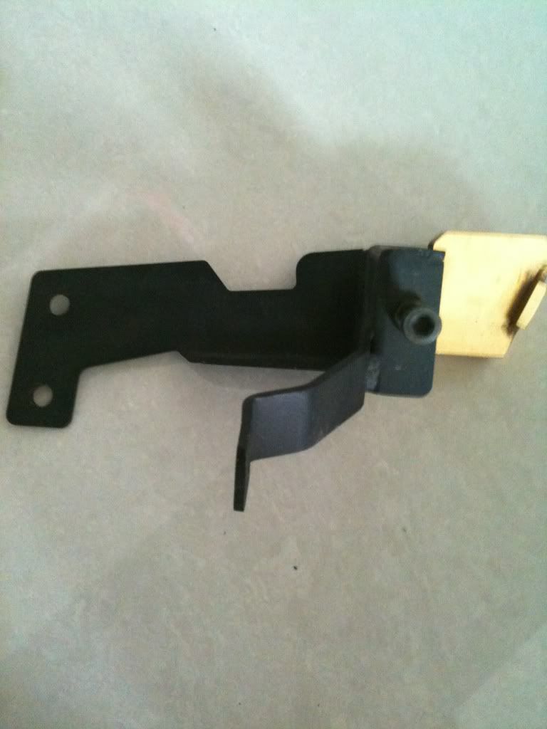

Hi,
I've bought some stuffs off yahoo Japan auction some time back... Finally they arrived at my place after a few months...
Amongst the item, one of it was a Nismo brake Cylinder stopper... Anyone heard of it or had one installed in their ride?

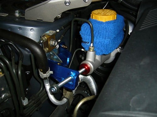

During hard braking and forceful pedal operation the firewall flexes out where the brake master cylinder is located. This results in decreased brake pedal effort and feel. With the installation of the bracket/stopper kit to the strut tower, the front & back motion of the firewall where the brake master cylinder is located is secured, resulting in increased brake stopping operation. never installed one but thats its job

This is about the best pic I can find to show what their function is.
3914759638_673c76644c.jpg[IMG]
CMF_SSUK
» CMF Member
Member since:
Posts:
Blasted flickr images, and edit fail on the forum lol.
As I was saying, this is about the best pic I can find to show what their function is.

Thanks guys for the info and help here...
Anyone fitted the Nismo one before? As the assy looks somehow different from the one in the pic, I have no idea how to go about fixing it up...

The issue with those booster brackets is they are entirely in the wrong plane, so offer very little in terms of additional rigidity. The master cylinder will rotate upward, which is why there is a factory brace in plane inside the car to counterect that, (see picture). It's weedy but it does a very good job all the same, (once bled the brakes with it disconnected by mistake and the firewall flexed like hell!).
Power wise, 100kW+ at the wheels is easily achievable for the 1% that do mod their Micras even a mediocre turbo setup, they're everywhere these days. 80kW+ at the wheels is also easily achievable without a turbo if you're running quads, more if you up compression and do headwork.
