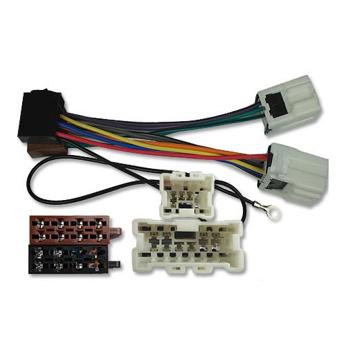

also have you connected right behind the head unit? I know the ISO plug for the rears is kinda seperete
like so
when i bought th ISO from Halfords there was two connections on the plug. i connected up both connection. Is that what you mean or have i missed some minor rewireing i need to do behind the head unit. sorry im very new to this thing
Oh brilliant. But that look like what im doing exactly minus the plug, where can i buy the plug from? I really dont know where im going wrong.
