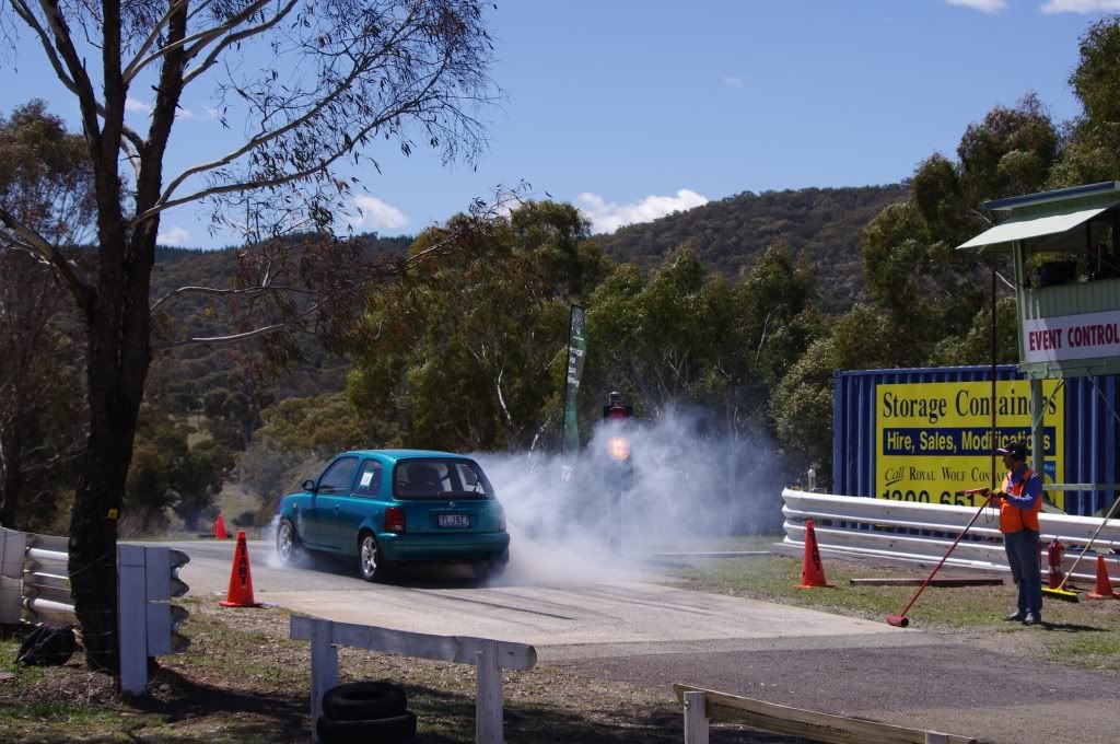

I am currently on the lookout for an LSD or pulsar gearbox as wheelspin is a bit of a problem!
It's going on the dyno on Saturday for a checkup then straight to Sydney to get a power steering conversion kit, then hillclimb on Sunday.

if wheelspin/torque steer is an issue, a pulsar gearbox isn't going to resolve the problem mate - got a n15 pulsar box in the slayer and even with semis, it'll still spin hard when u give it some.. the daily ****box isn't throwing out the same kind of power figures, but the 31V box in it just won't let the wheels spin - they fully want to though!

Sorry I was talking about a N13 SSS pulsar, wouldnt bother upgrading to a non-lsd box.

Made 93.3kw @ 7psi on saturday, and was significantly slower than climberjoels n/a LX on Sunday lol

I'm pretty sure I can get it to redline in 1st gear without the car moving forward (using the handbrake) Might try a launch at the next hillclimb using this method and just releasing the handbrake to take off...
