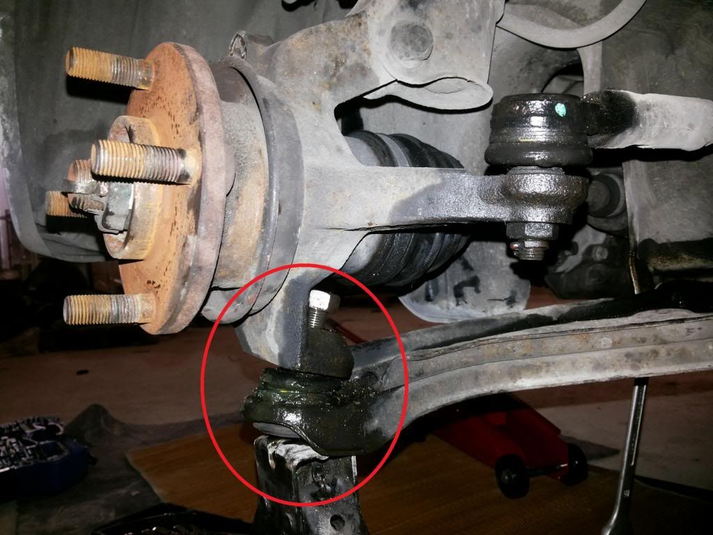

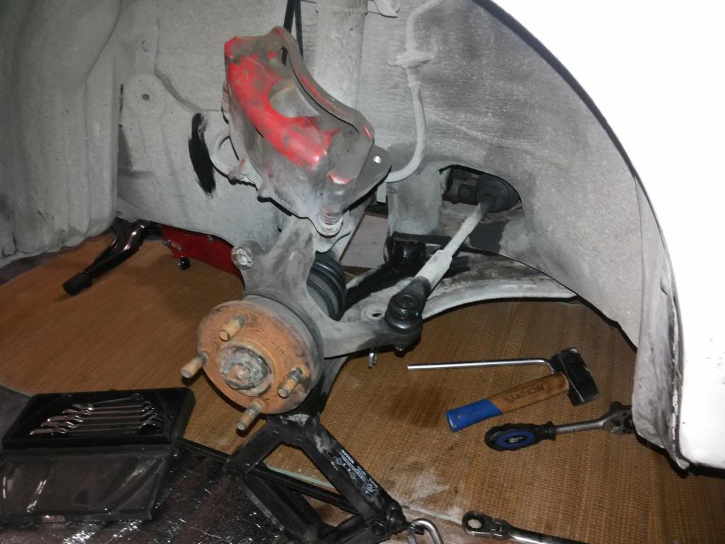

Hi Guys sorry to bother again, have jacked the car up and unbolted the first wishbone. yet I have difficulty in getting the bolt clost to the tranny out although the nut has been removed. and the mount with the balljoint. although the pin has been removed and the nut has been loosened, i cannot understand the correct way to get both parts out.
Above, I'm jacking the ball joint in hope of relieving the bolt near the tranny since it seems to be taking some sort of weight or stress, since it budges slightly and makes noises as if it's scraping. although the nut has been removed. The other prob is how to get the part of the ball joint out since I tried hammering the wishbone down but it seems the same kind of taking some sort of weight. I tried unjacking, but still its not making much difference.
Above is the balljoint bolt, with nut unscrewed but the ball joint seems slightly tilted, and am not sure if that's whats restraining the wishbone from coming out from this side.

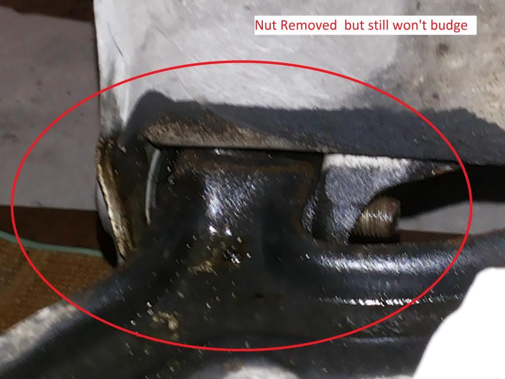

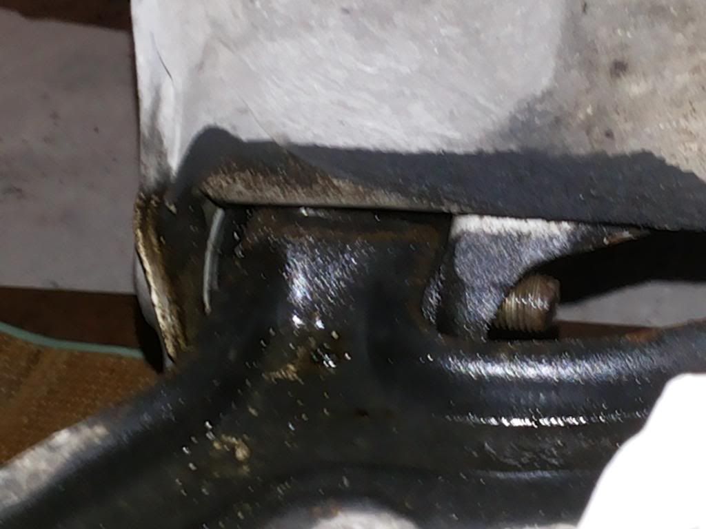

Above is the bolt as mentioned earlier close to the tranny. with nut removed.
Guys youre my only hope since if I dont manage I'll have to put on the bolts again with the old wishbone in. So i can drive the car until i find a solution. thanks and happy christmas to everyone at the club!
The photos below are for your info. would appreciate your help since I need to use the car late this afternoon. you're the only ones I can rely on.

the bottom balljoint is taper fit ian, and is the other bolt rusted into the rubber mount ?
No thankfully rust doesnt seem to be the prob. other bolt seems ok in terms of rust. I've manged the budge it a little but its too stressed kind of its like taking a lot of weight or something. Im refering to this one bel;ow :
and the balljoint one if its taper it should come out easily.. any specific way or just hammer things out?
the bottom edge of the wishbone with the whole rubber thingy, the two bolts holding the mount have been undone ok. some hammering all it took. its the only end of the wishbone that has been removed from the car. now the balljoint one and the one opposite it close to tranny are the problem.
is the bolt springy mate ? will it turn ?, and i usually hit the balljoint surround with 2 hammers to jolt the taper free
yes it springy... is this sign of it will snap? o_O
let me go try and kick the **** out of the balljoint surround with the hammer
let me go try and kick the #### out of the balljoint surround with the hammer
thats because its fused into the bush ian, if you cant free it off you end up having to grind the head and tail of the bolt off and levering it out
you could use a balljoint splitter on the balljoint

The video here explains what Frank presumed was happening, the springing effect due to the bolt fusing with the rubber bush. BTW would using an impact wrench get it loose?
I replaced all my bolts with stainless steel bolts
You'll want M12 x 70
If you turn the bolt you'll hear the insert turning inside the rubber
They've either rusted together or the bolt itself has bent :)
