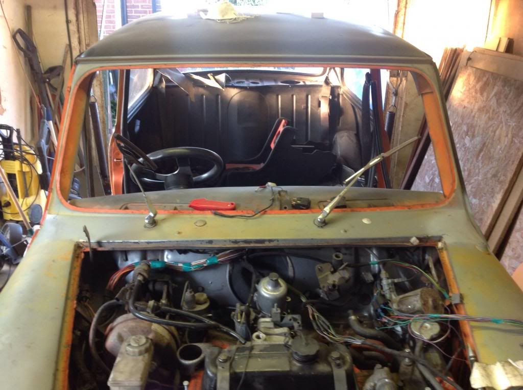

Stripping engine down today (well trying)…... after timing everything up dizzy out, tensioner off etc etc, when undoing the cam sprockets the spanner holding it slipped a little and i managed to turn the engine now its out of timing, just wondering what my options are? i was hoping to put the tensioner back on and rotate back to TDC and start again seeing as i did not loosen anything
Thanks for looking
Knew i would be asking questions when doing this mwaaaaaaa
You can reset it when you reassemble it glen :)
Cheers Frank, weather beat me today gonna get on it tomorrow i put the tensioner back on gonna reset and try again. Whats best was to hold the cams down, can't remember how i did it last time :)
thinking about what you said Frank might be a noob question but could you in theory just strip the engine without setting to TDC as long you set it when put back together
yep if the engines gonna be all stripped, ur gonna have to set the crank to tdc and align up the timing chains anyway ;)
