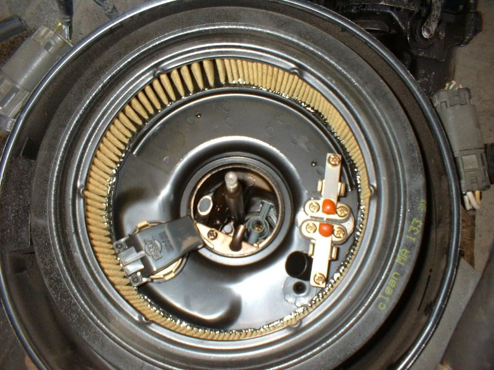

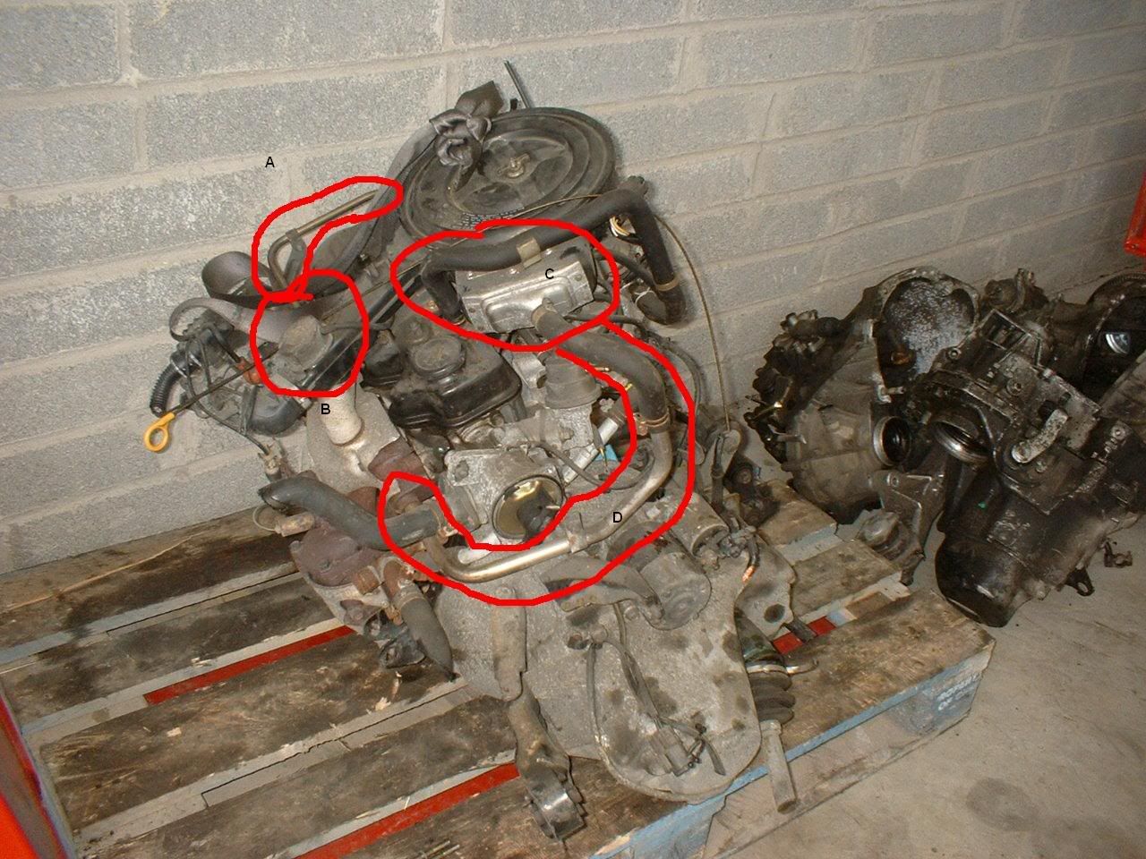

ok, can anyone tell me what the parts labled ABCD are and also whats that in the airbox....

It's all stuff for the exhaust gas recirculation.
Specifically,
A: Tractor Pipe 2
D: Tractor Pipe 1
Haynes goes into it.

Yeah, as Andrew said, A and D are tractor pipes 1 and 2, exhaust gas onies. B is the thing which controls the flap to alter the air flow otherwise from the nose of the airbox, or from the pipe going to the exhaust manifold shroud, its just instead of having the manual lever like on most other K10 engines. C has a little rubber flappy one way valve thing in it, and some other bits of stuff.
I may be wrong, but being its got all that stuff on it, it might have the ECC carb on it - how many electrical connectors are coming from the carb, and how many pins do they have? If it is the ECC one you might need to change it, or get the ECC unit that sits under the passenger seat.

if i was you get rid of it all, you'll pull your hair out before you get the ecc system to work in a non ecc car, it aint just unplug the box under the seat and replace it with a ecc one, theres ten times more wires going into a ecc box than a non ecc one.
give up with all that ecc crap and get a non ecc carb, inlet and exhaust manifold, non ecc electronic dizzy and stick it all together.
You shouldnt need to change the manifolds, just the carburettor and distributor, although you will end up with a lot of redundant sensors and stuff.. I agree getting the ECC to work would be a pain, especially being you probably dont have all the sensors, like speed sensor in the dials, the vacuum sensor thats screwed to the bulkhead, switch behind the clutch pedal etc..
Ok well im sure that the car i got it from is about the size of my TV by now so what should i do? Just look for another Ma12 to get a carb and dizzy from or will my Ma10 one's work at all?

Yeah you can use the ones from the old 1.0 engine, should work fine, I did that when I put the old super s engine in the 1.0 super. It is a strait swap, its easy, calm down :)

Oh, thanks for that! The MA12 i bought came as it is in the pic above, no dizzy cap or leads, can i use my dizzy cap r do i need to get the ma12 dizzy cap? And is ther any difference in ignition coils?
