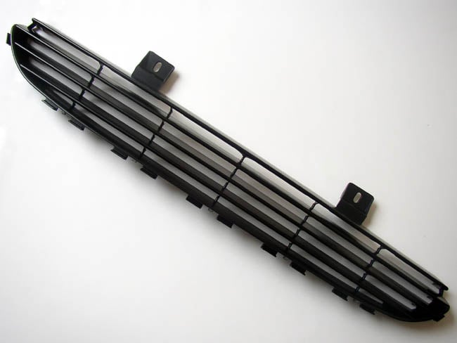

If the weather is dry saturday, i'll be going to bridges to find me a new bonnet. I have a front and rear bumper in my garden to fit, and i've also bought my first chav mod for the car, which is a 'sport grille' to replace the broken standard one. It's chavvy but who cares :p Also got new front and rear number plates to go on.

ahh thats alright then. a lot of the time they are cheaper than buying a standard grille lol
That's why i got it! I've also got bog standard black bumpers to fit instead of half colour coded. The colour coded ones actually cost £10 more each and only come in primer, and i can't be bothered with spraying them up. Waste of money - bit like this car really!
