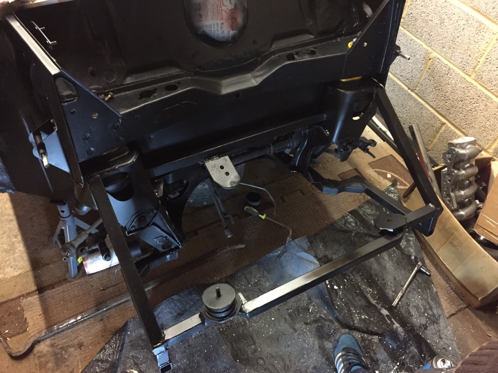

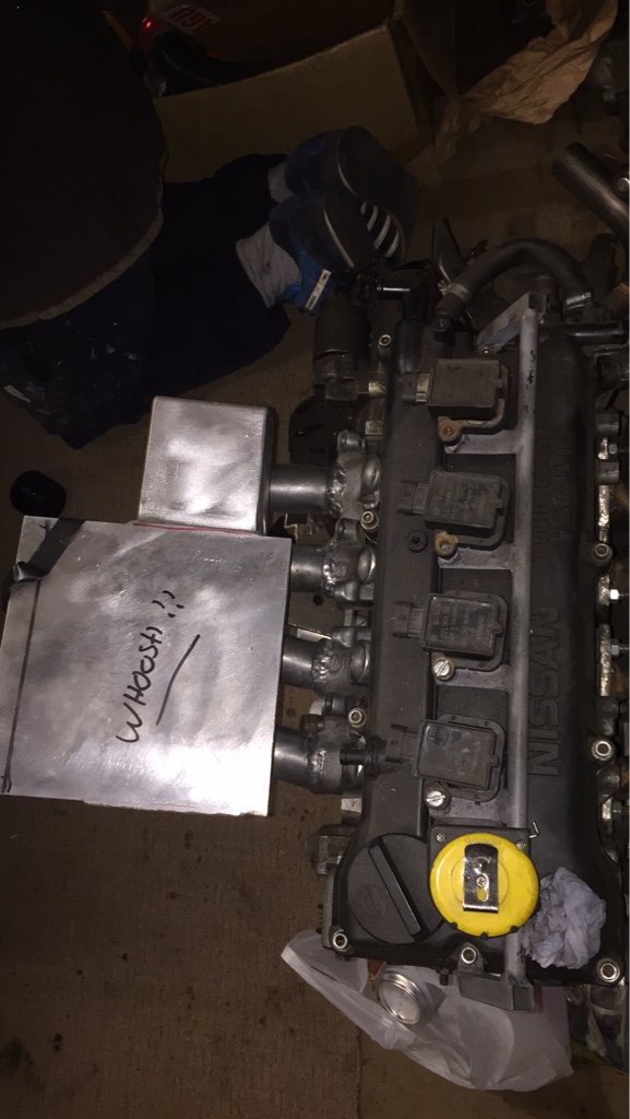

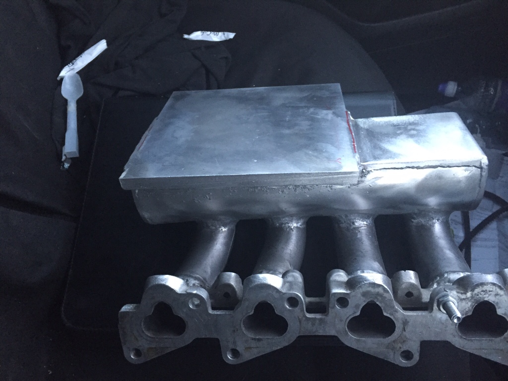

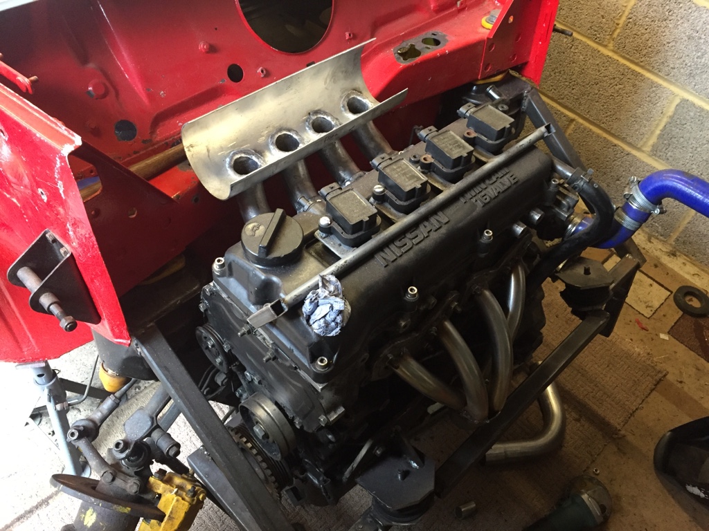

Thought I best update this....
I ran the Throttle bodies for a few hundred miles, but I eventually got tired of the consistent induction noise, especially on long motorway journey to work.
So decided to fit a specially designed long runner inlet manifold & plenum with a 48mm Rover Throttle body and TPS.
This setup felt equally as quick as the ITB's but a lot quieter and the engine felt very torquey.
I've just done some port work on the inlet and drop down to a shaftless 45mm billet throttle body and moved it closer to the plenum for better throttle response.
And after a full engine calibration it's making 116bhp & 101ft/lb on a calibrated dyno
