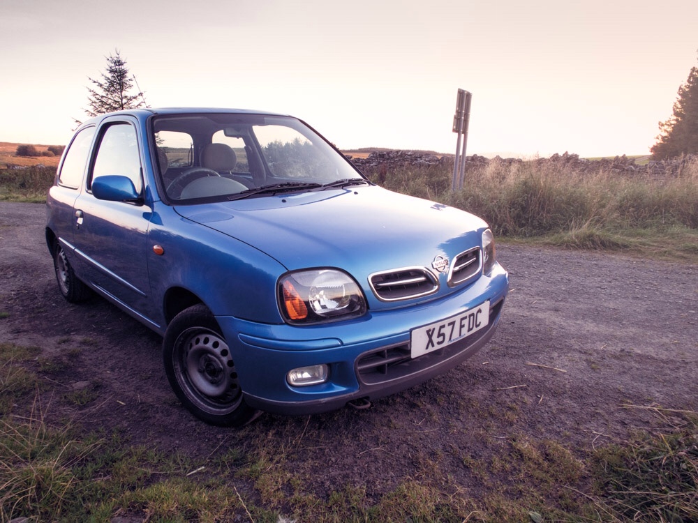

Don't think I posted this picture from an amazing sunset drive the other day. Looking good for her MOT on Thursdsy!
PROJECT PASS FIRST MOT
