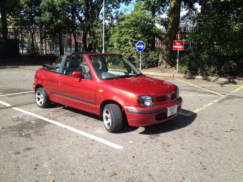

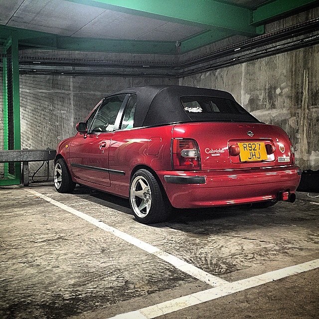

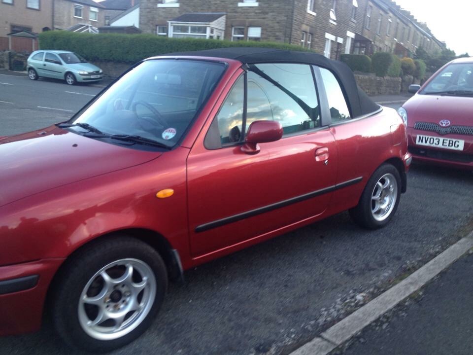

Hi let me be the first to do a new topic. This is my March Cabriolet as she is right now
1.3 Manual
16x8 Rota Cups
BSR Coilovers

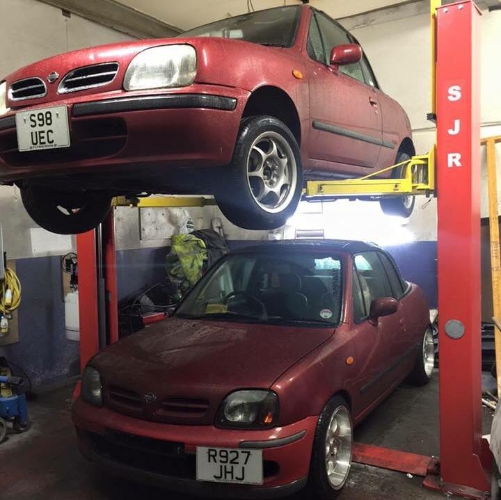

Top one in below pic is going to be a trailer ;-)

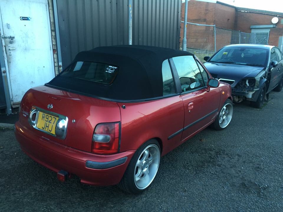

Bought my 2nd cabriolet because the first one I front ended, repaired kind of but with the 2nd being manual it was a no brainer.
how I bought her
transferred my starmags over to her

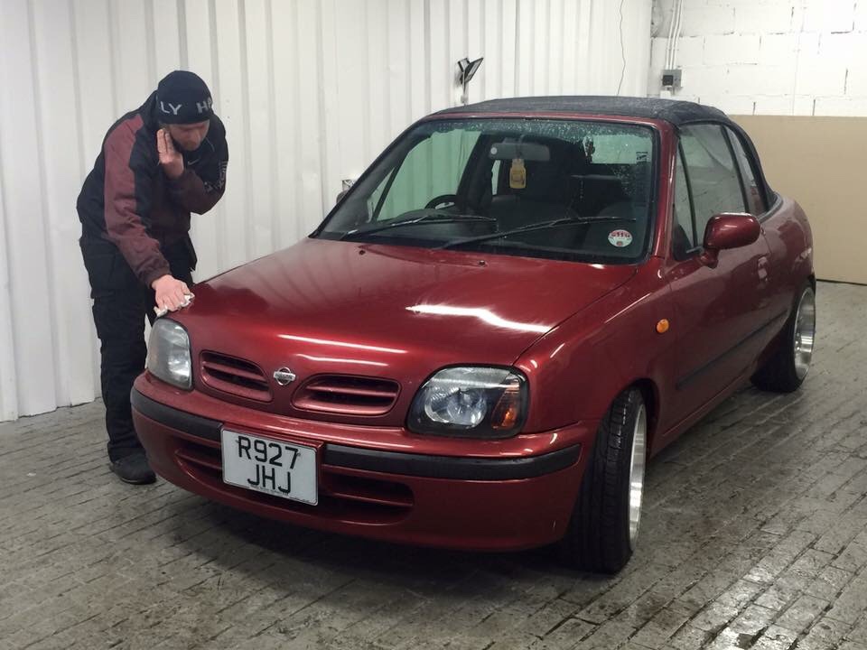

had the roof retrimmed as some of the stitching had worn off due to age and was leaking in.

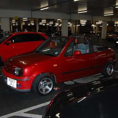

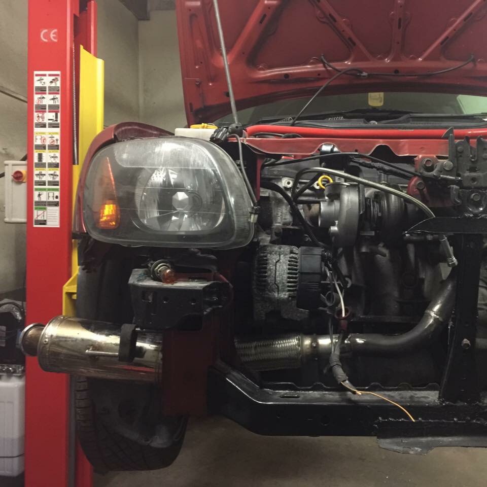

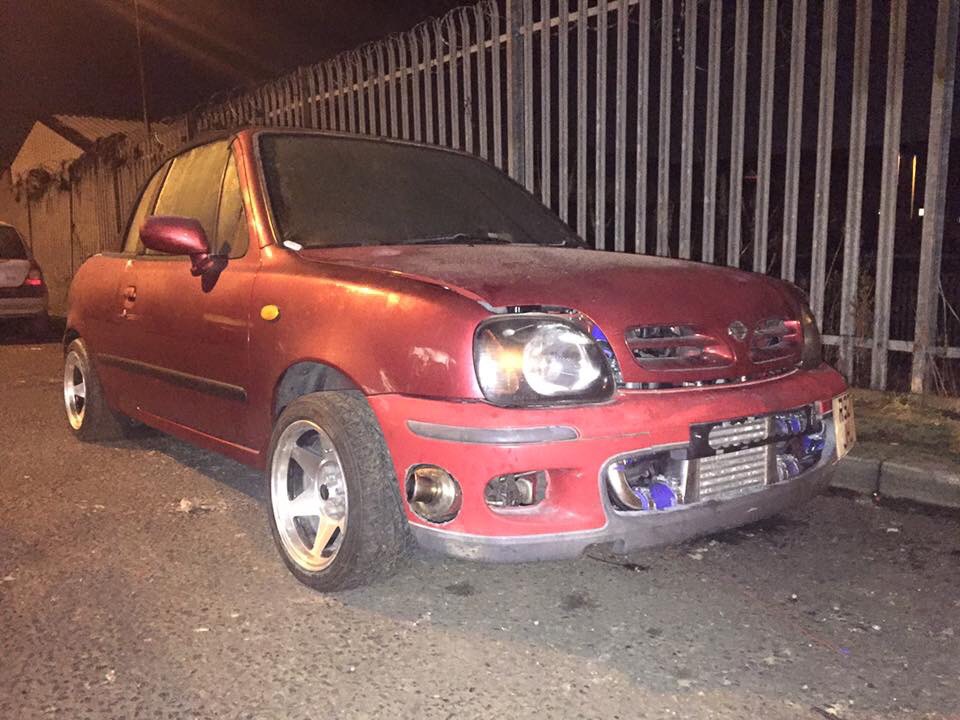

then I decided to turbo it and changed front bumper for a k11c model
custom front exit exhaust whilst doing the turbo build
At this meet it grabbed all the attention

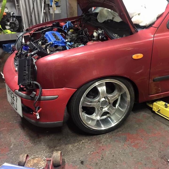

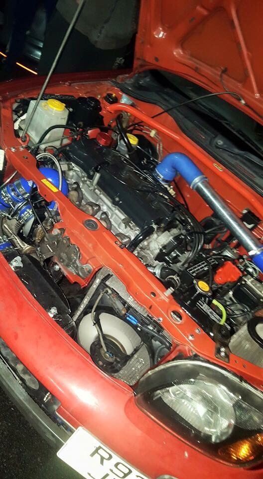

At that meet though I did blow the engine :-( so out came the engine. I blew the turbo as well!! So it's got a standard 1.3 engine in it at the moment.
bought new set of wheels. (2nd hand but new owner) and fitted the BSR coilovers. Sat way too low so adjusted them. Looked good but couldn't turn at all lol!

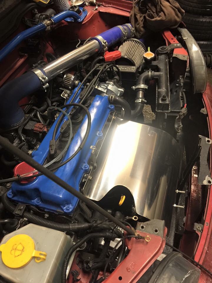

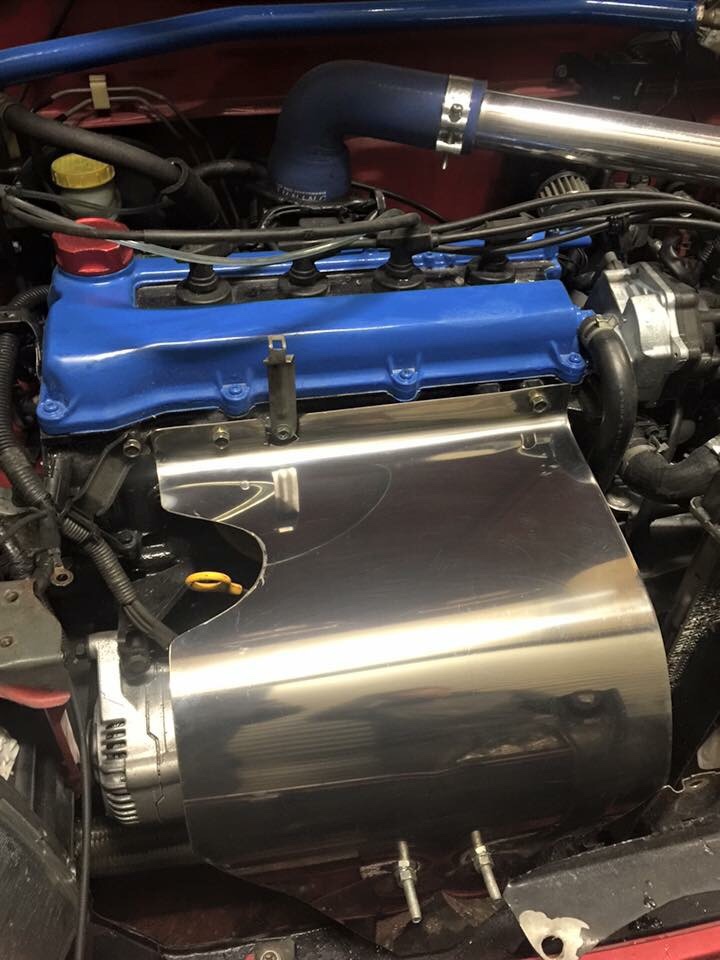

had to adapt the exhaust to fit the turbo manifold as I had no turbo! Then covered the mess with this custom stainless steel heat shield
as you can see I also painted the engine black with blue rocker cover and other blue bits.

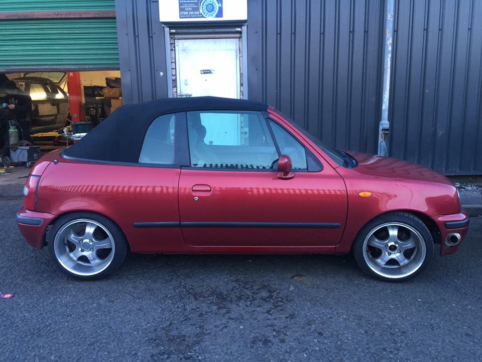

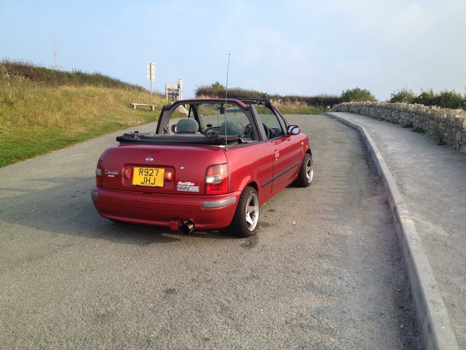

Original bumper back on with exhaust cut out

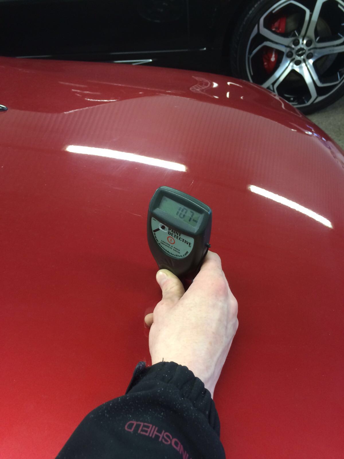

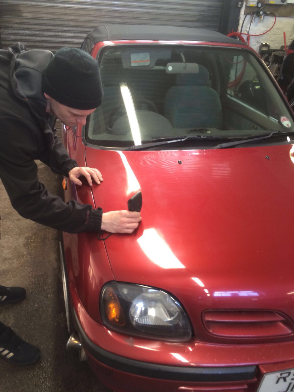

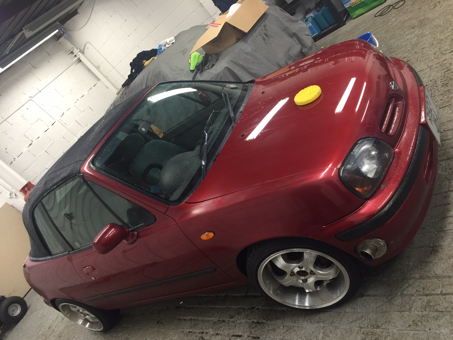

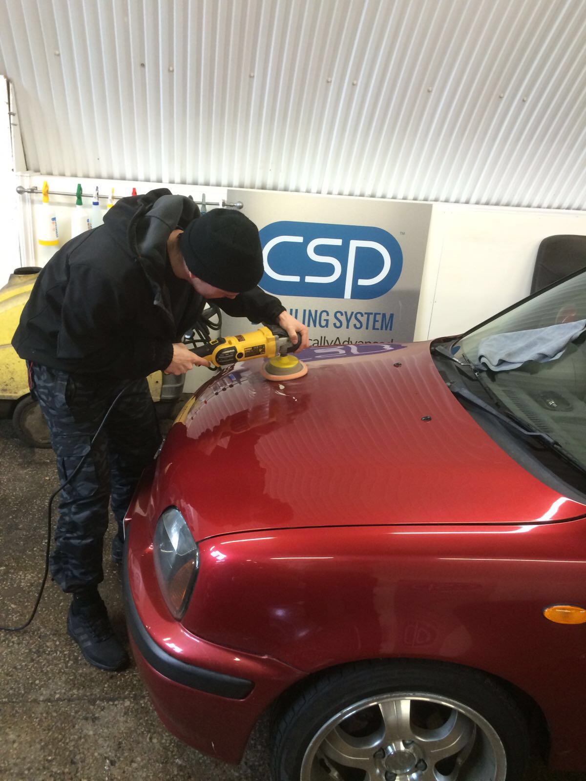

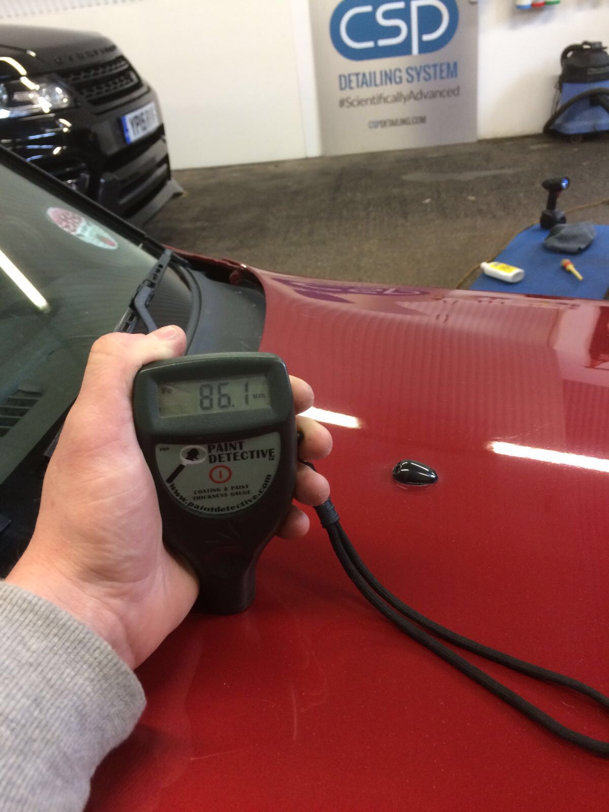

How she sits today. Going to spray that rear surround same colour as the car or might keep it chrome as the cabriolet will be painted white soon! This is due to the paintwork being so thin in the first place when we detail it we might go through the paintwork! (Used a paint thickness gauge)
Looking good! Although I must ask: you're going to make a trailer out of a cab?!
Yes. Cut it in half in front of the b pillar.
Don't know whether to have a roof for it or not lol would have to be custom
You chopping it because its knackered ???
I never fully repaired the front end after I rear ended someone. The rear sills next to arches need work and I've no use for it. I always wanted to do the car and half trailer project and with this one it will prob be the only one in the world made from 2 cabriolets.

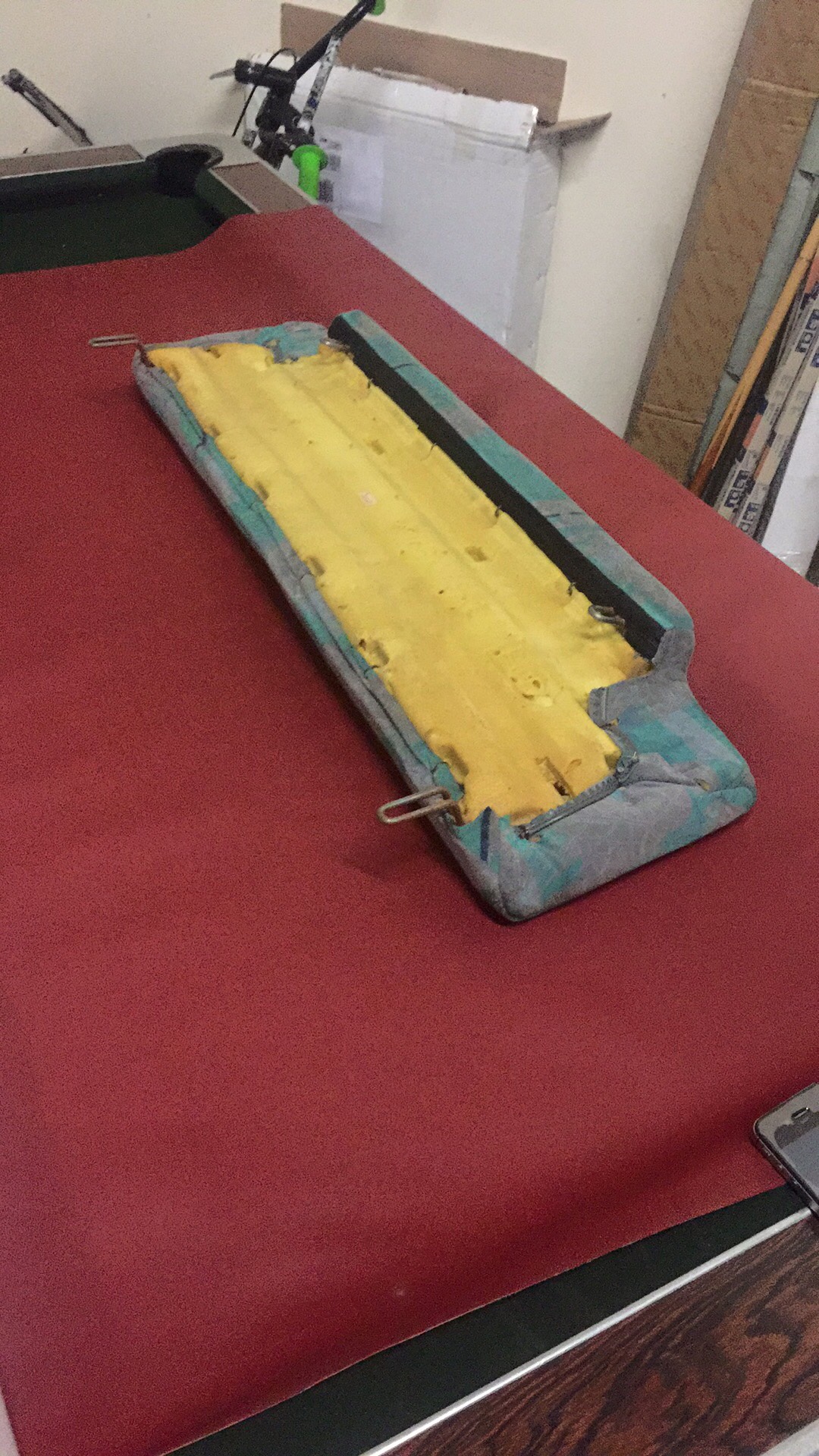

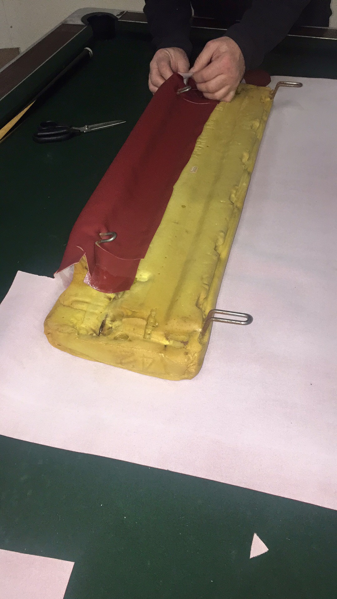

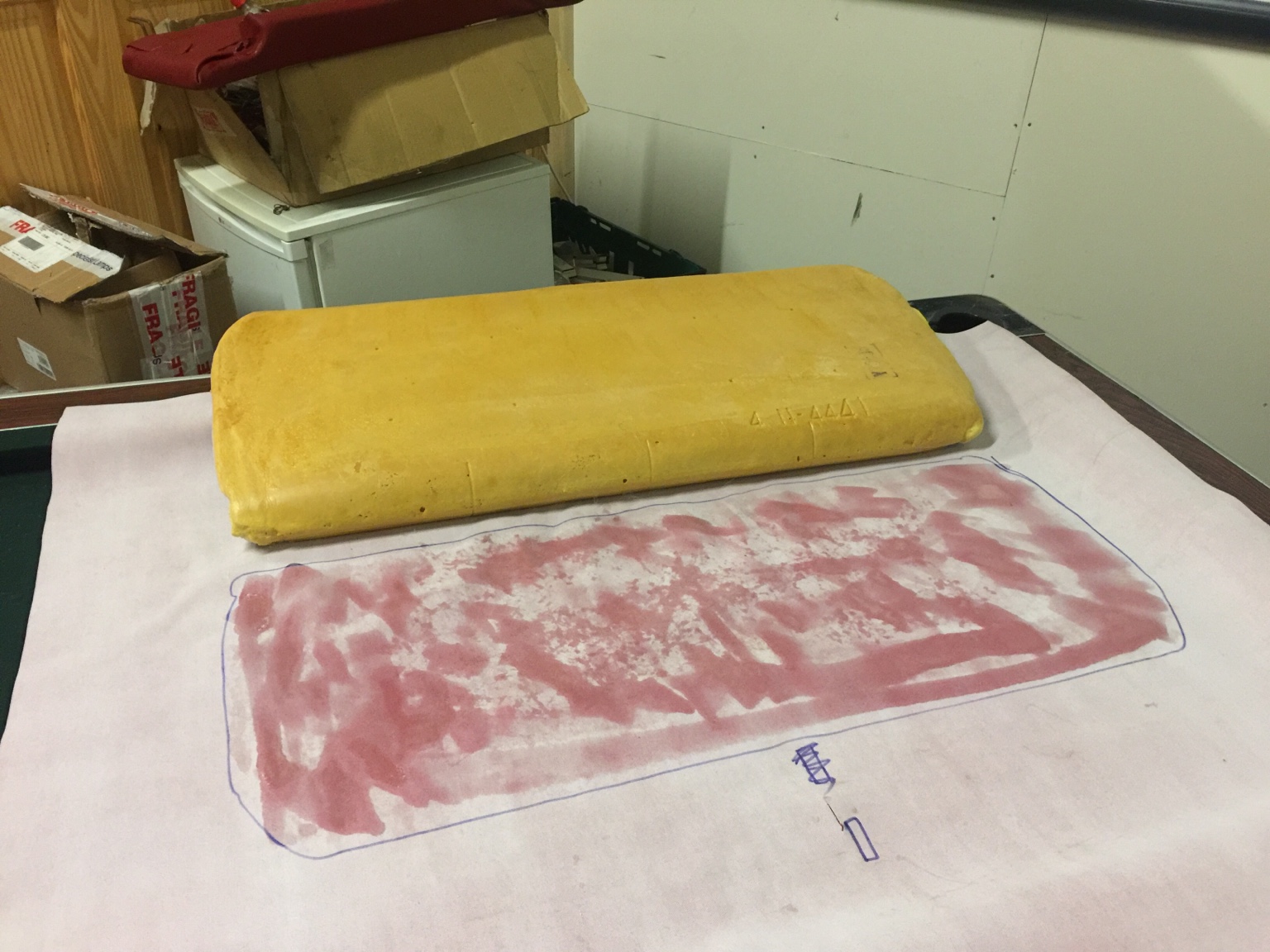

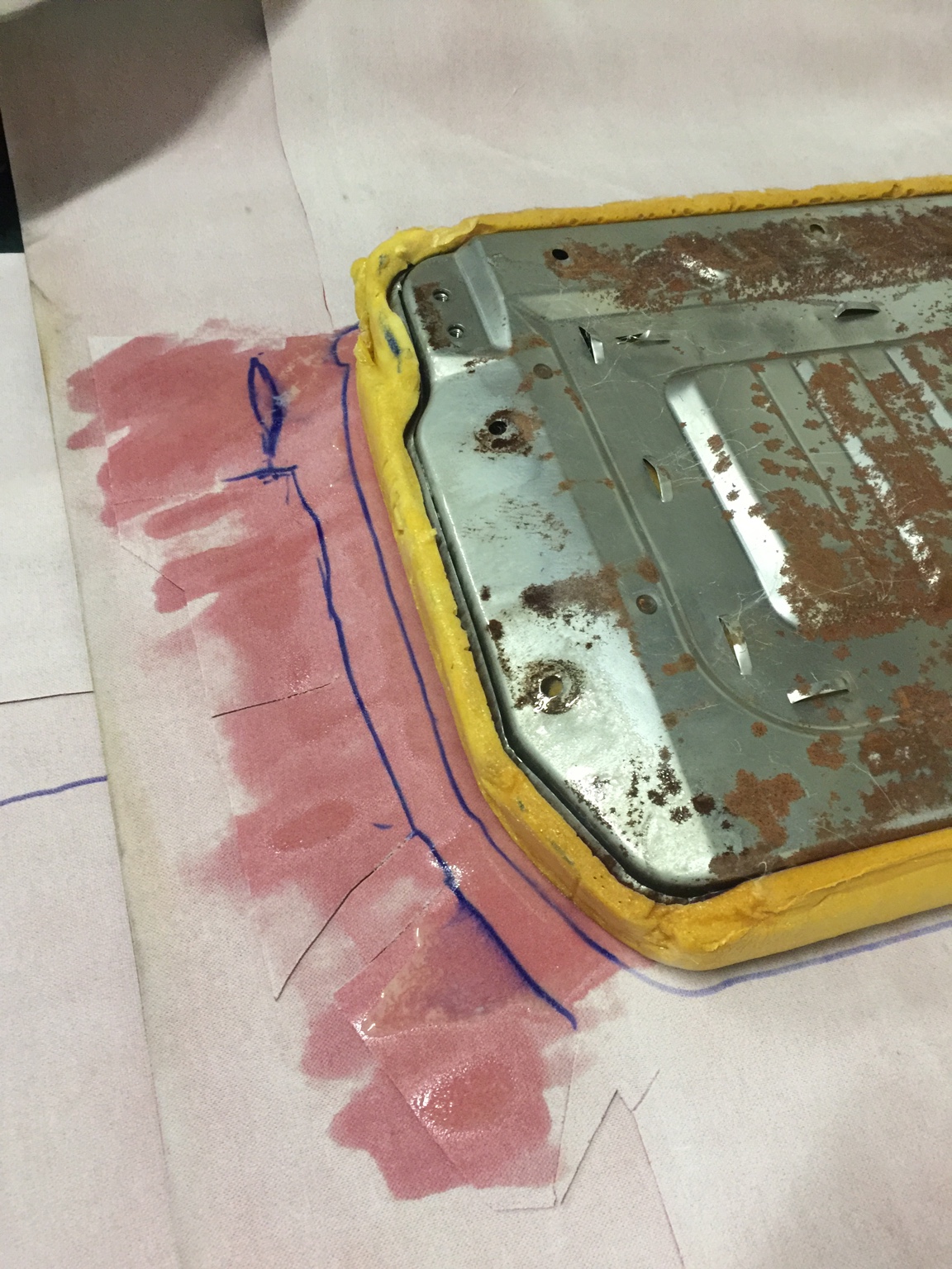

Ok the other cab I'm using as spares for templates for retrimming my seats. Now I've never done this before so watching and getting tips off YouTube videos. If it doesn't work I will get it done proper.
Anyhow here we are. Rear seat is in 3 sections, a top fixed bit a middle drop down bit for the boot loading access and the bottom fixed bit that you sit on.

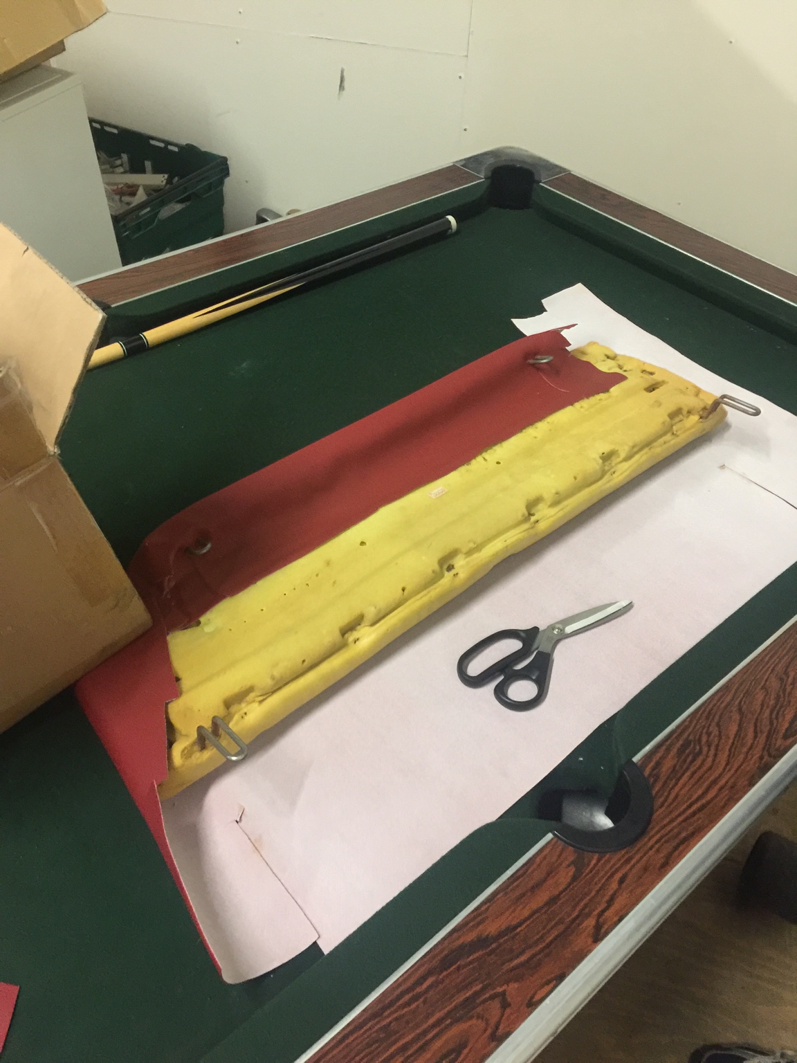

For this I'm using evostick carpet adhesive.

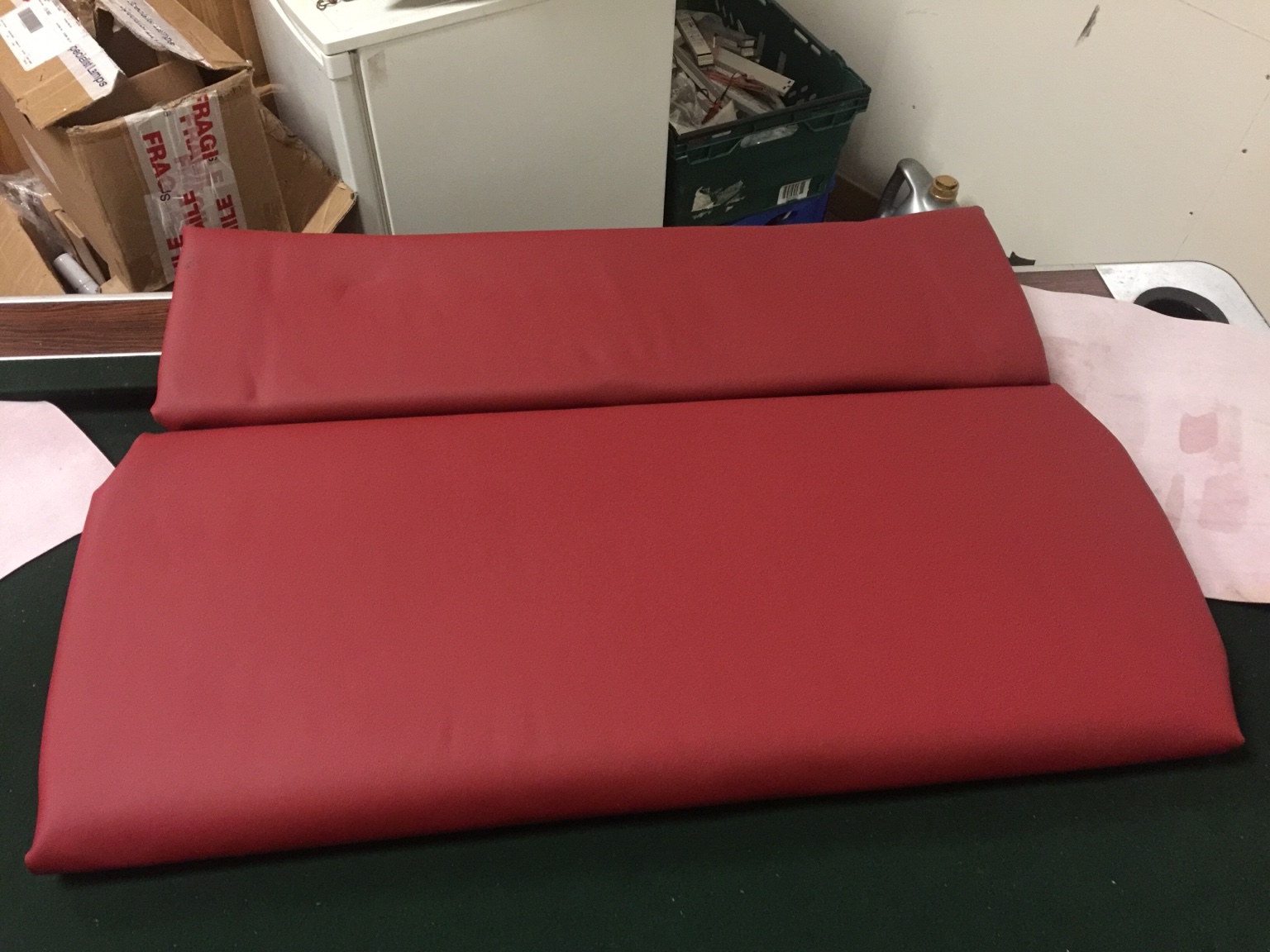

So these are my top fixed rear section.

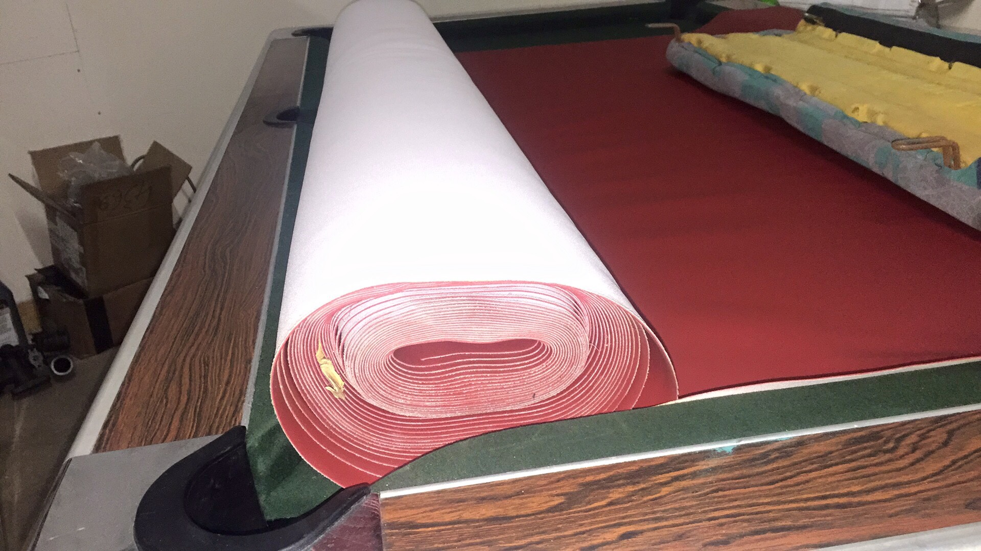

Here's my roll of material. Old school members will remember this material from my first ever Micra. Yep it's 10yr old and still looks like new haha.
Note: I've removed the original cover so I'm on foam only.
Making sure it sticks down.

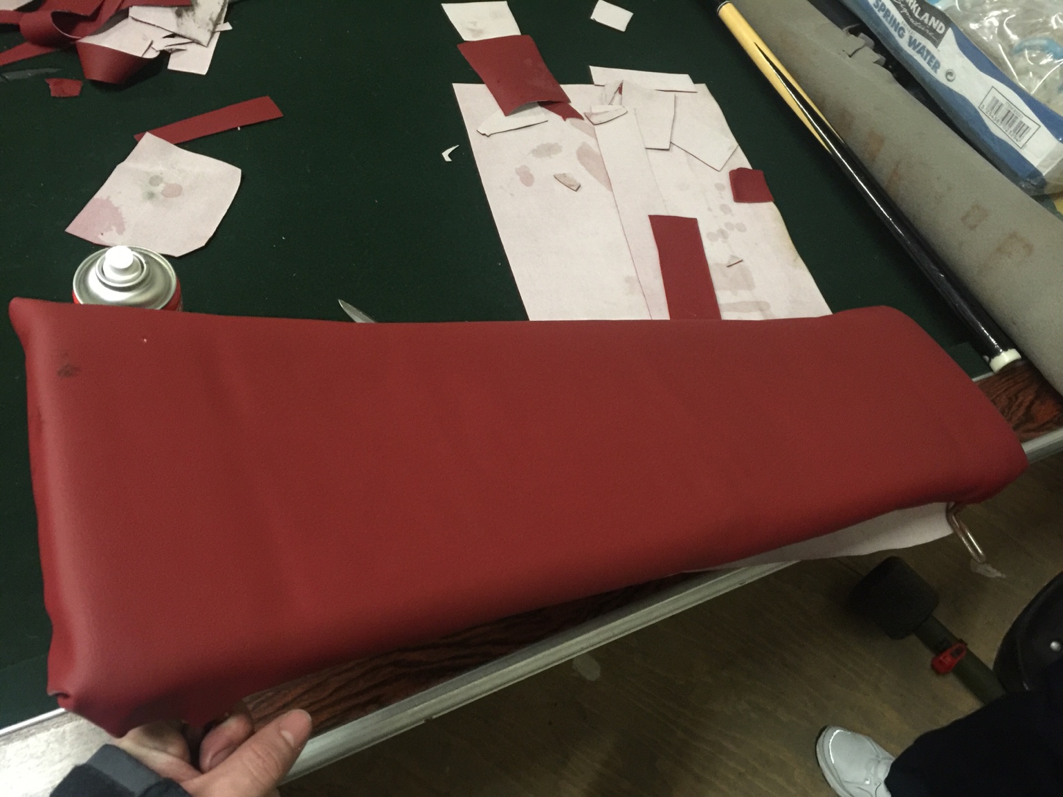

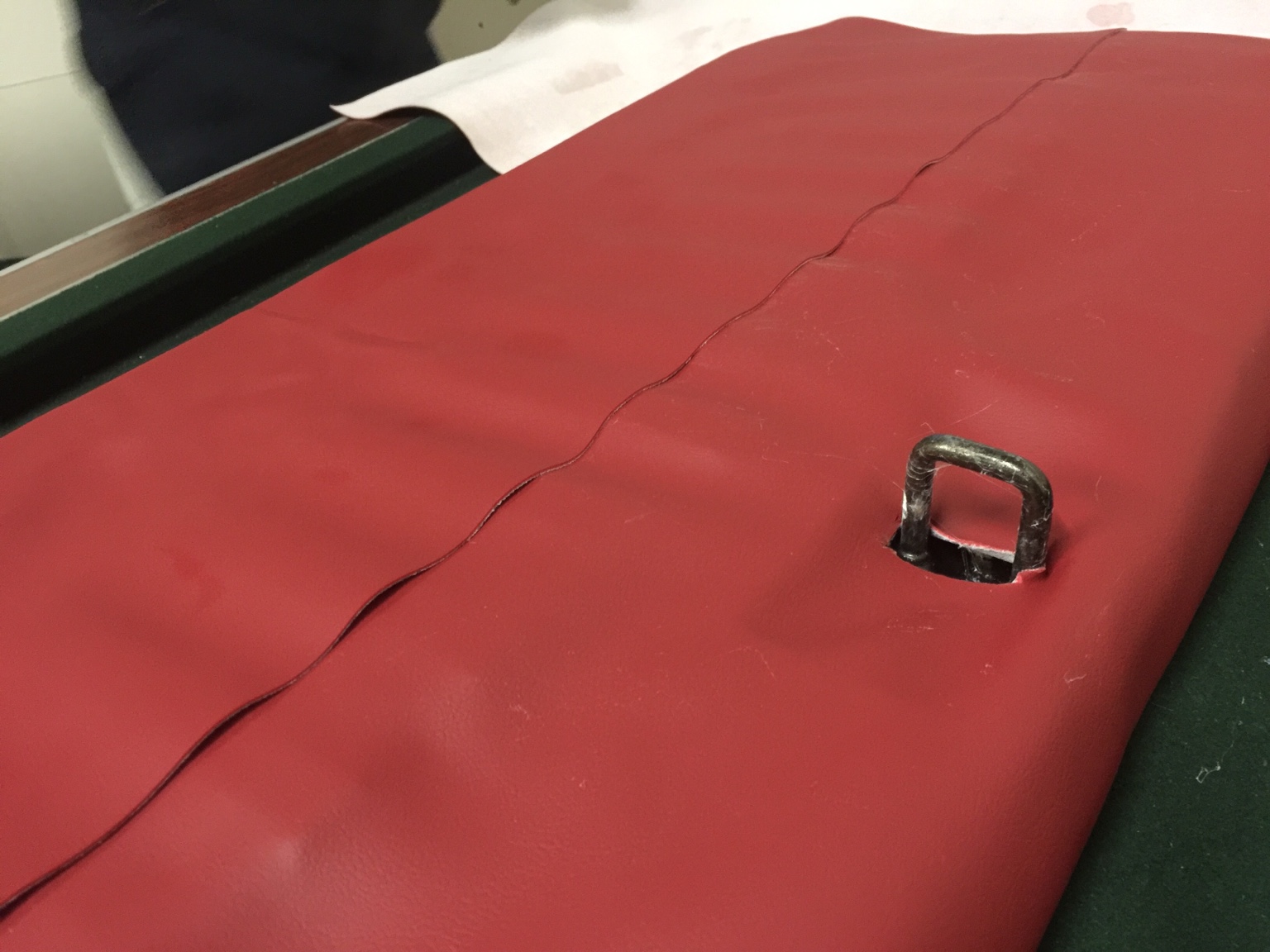

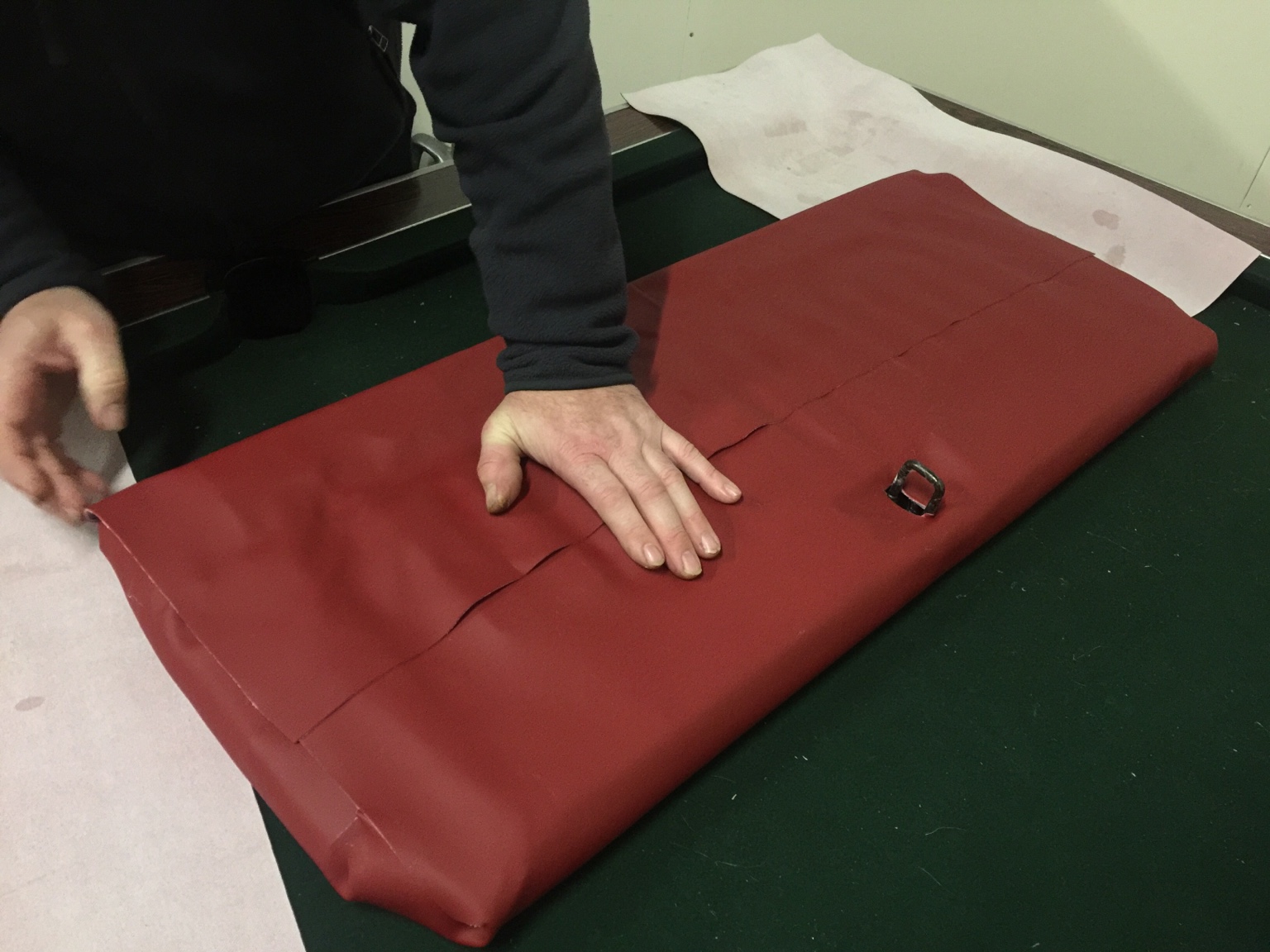

Here is the finish. Now this has a bubble in it but since this pic it has levelled out and is looking good. I'll get a pic of this tonight.
Found the pic of it better than above.

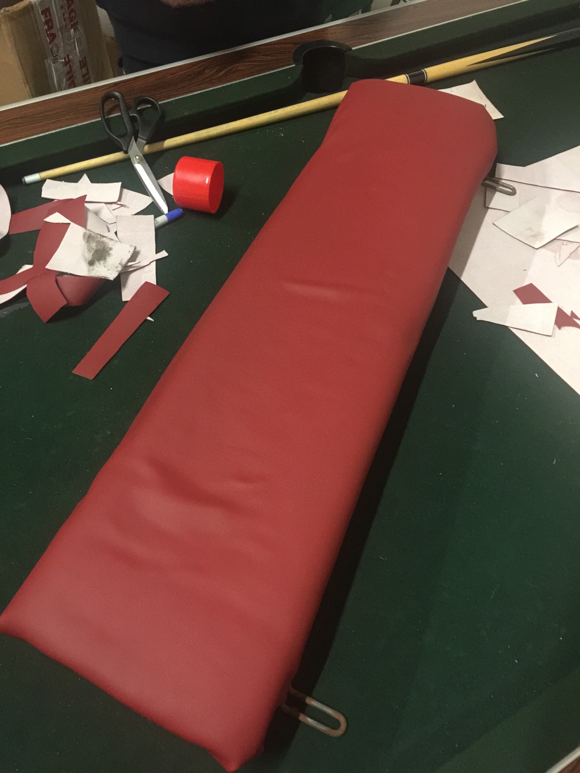

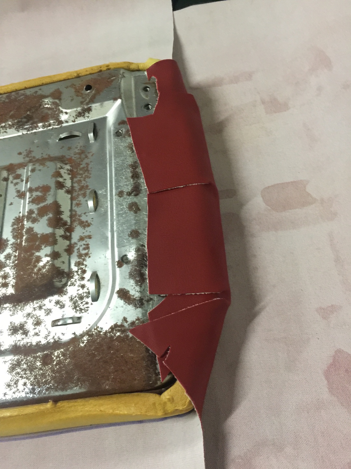

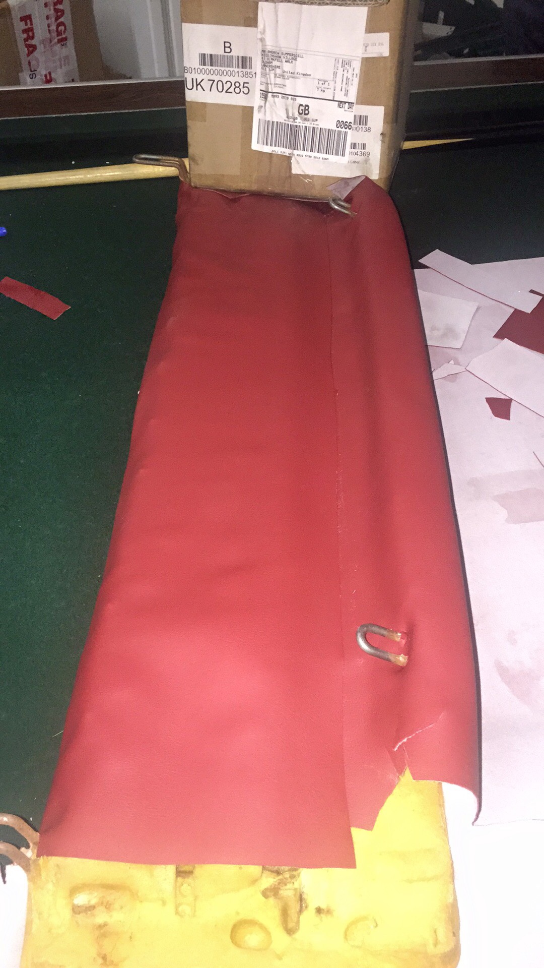

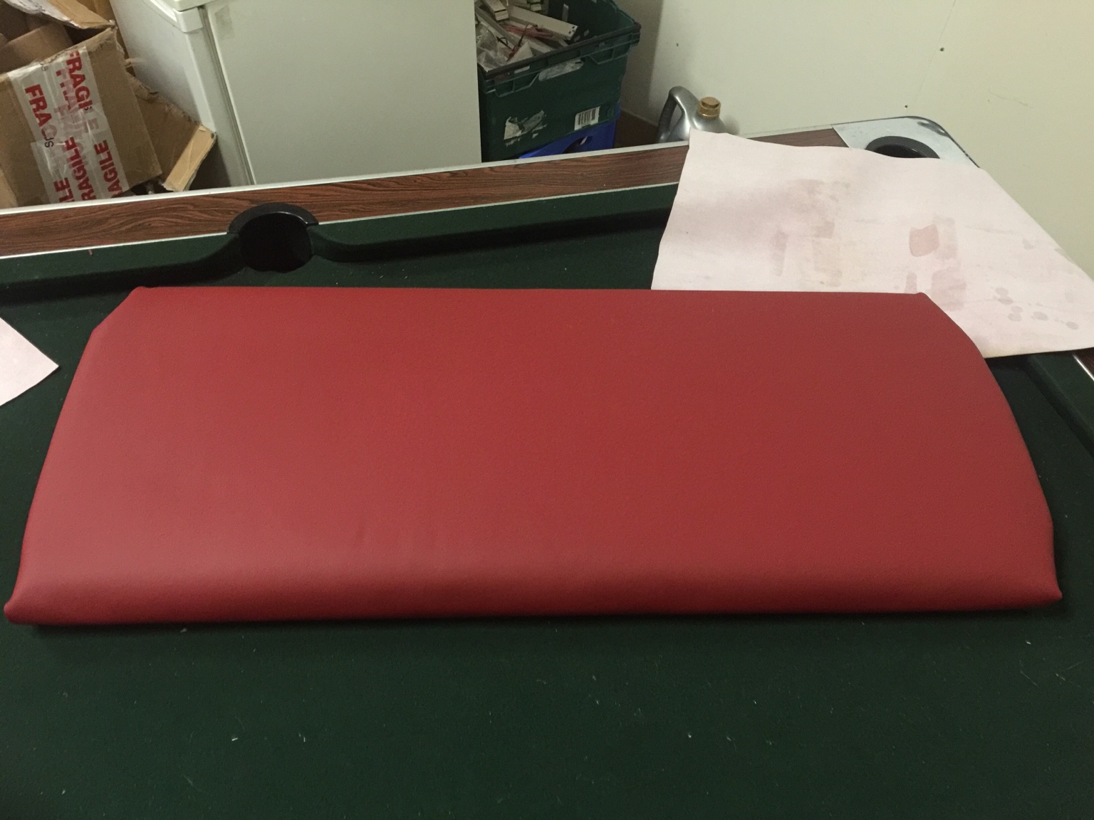

So I started on the fold down section which is a lot easier as a) it's flat and b) experience from the last one.
The rear of the seat which needs fully covering as it is seen from inside the boot.
And now I put some weight on top of the rear to make sure it all sticks for a few days then I'll get a pic of the front of the seat.
