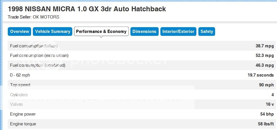

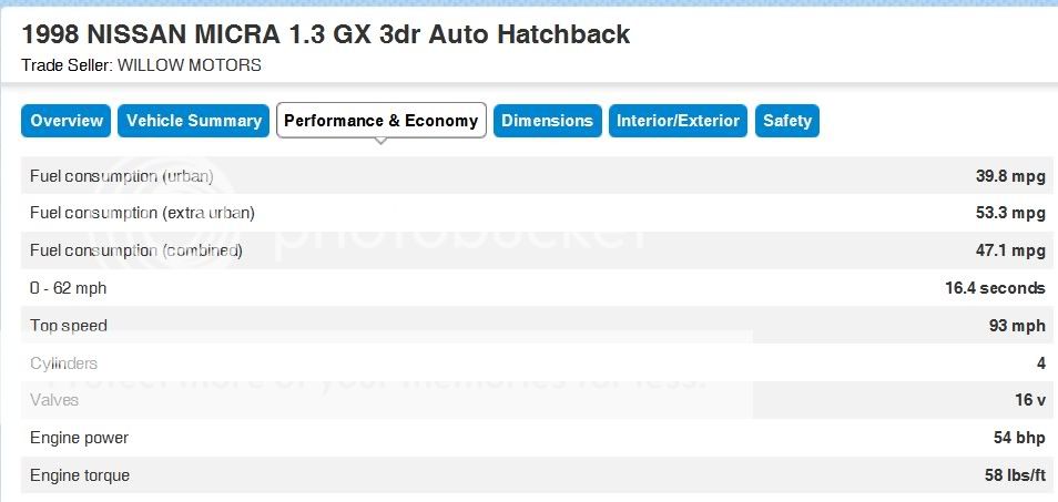

I looked on AutoTrader and have found the following performance / MPG figures. Just wondering how accurate these figures really are?
The plan is to use the car 50% in busy town centres where traffic crawls and 50% on A roads. Once in a blue moon the car will see a motorway and 70mph :D
Any advice / suggestions?
Thanks folks. Do you think AutoTrader also made a cockup of the MPG figures? How can a 1.3 be MORE economical than a 1.0???

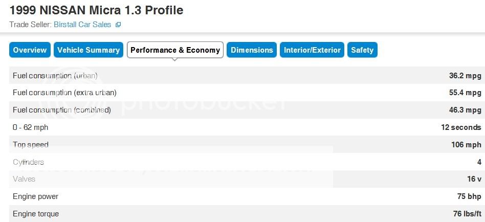

Found this on another 1.3, I am guessing this is the better / more accurate picture of MPG and BHP?
the 1.0 might be slightly better in town, and the 1.3 better at cruising, but cvt k11,s are getting very thin on the ground tho :eek:
i'm pretty sure Ed said the 1.0 and 1.3 fuel maps are the same, just with the 1.0 running a little more ignition advance through the range - that would give the 1.3 better mpg as its producing more hp for the same fuel being used......
