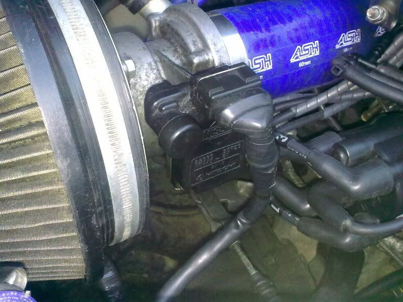

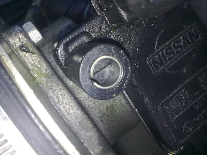

The st also has a CO adjustment at idle on the airflow meter (only found this out recently thanks to Ed)

You can see in the pics the adjuastment on the AFM this will need to be adjusted with an emmisions probe in the exhaust.

PASSED! today no advisorys, didnt need any parts for the brakes just cleaning up, and the emissions screw was turned slightly apparently and given a good run and passed no problem. very happy. just a little worried if it runs too lean on s/c and turbo now? :S
No man it only changes the fueling for the emmissions at idle so it wont go lean
