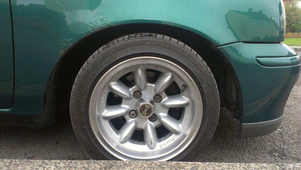

I quite like the look with those BBS'! :D
Got any side pics?
I thought the centro bore would be too small though?
I'll get some up for you tomorrow when its light. They fit fine mate just need extended bolts in rear which I have but havnt fitted yet. Have them and a bit of money your way for your superlites ;)

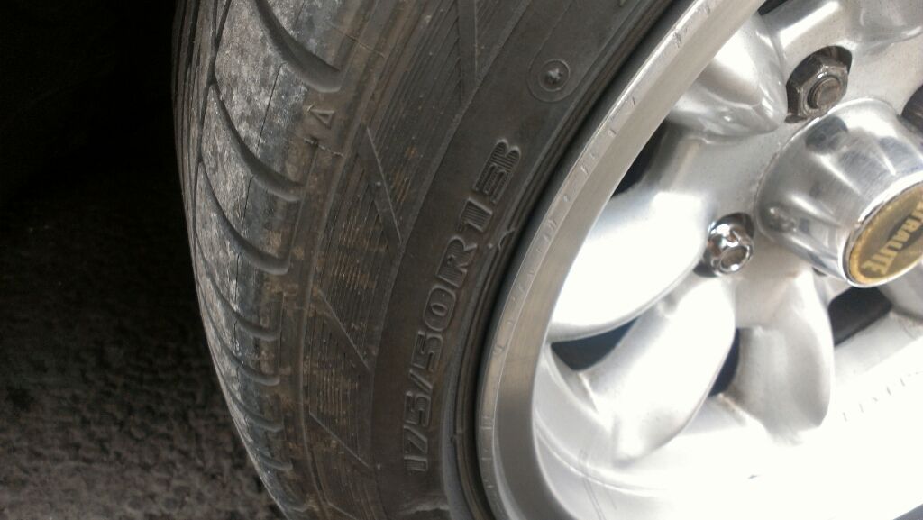

Ah 175 lol. Turns out that wheel only had 6psi in it. Doesn't make a noise now cheers.

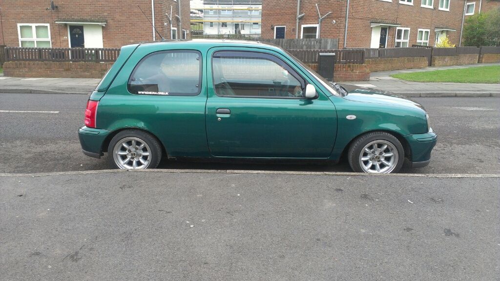

I think with it being lowered it makes the wheels look better
Any chance of some side on shots of the front & rear as I'd like to see what the arch clearances are like.

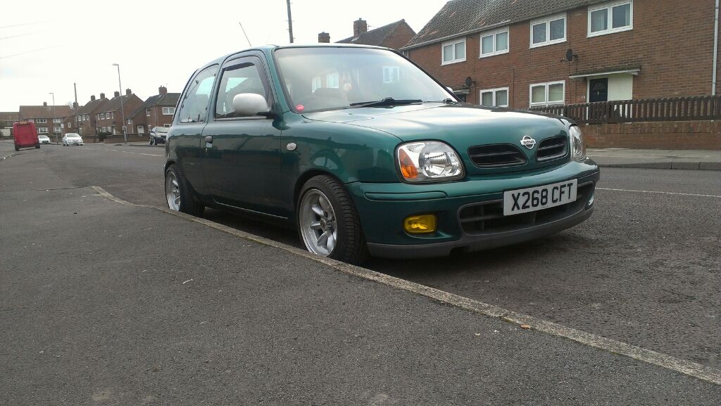

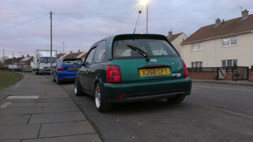

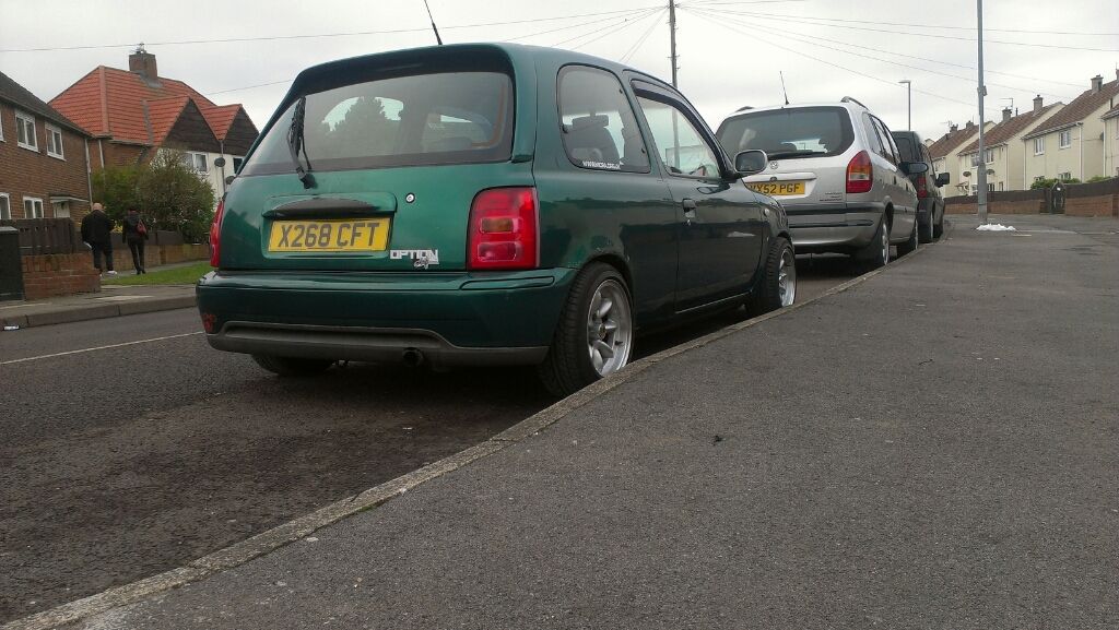

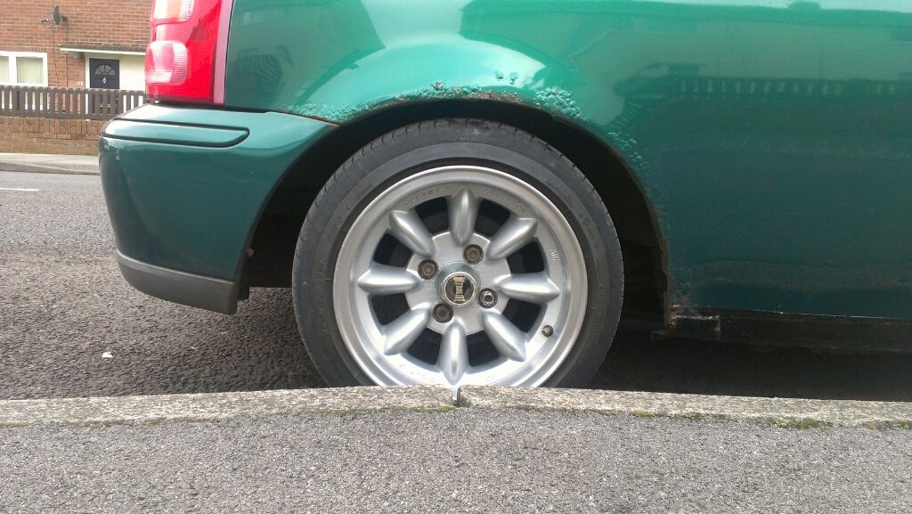

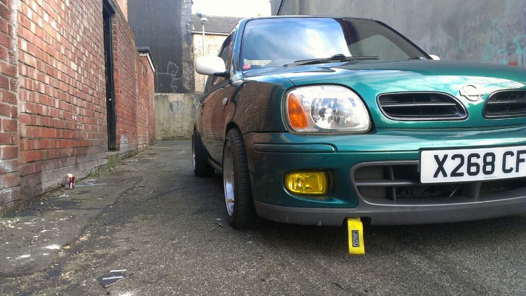

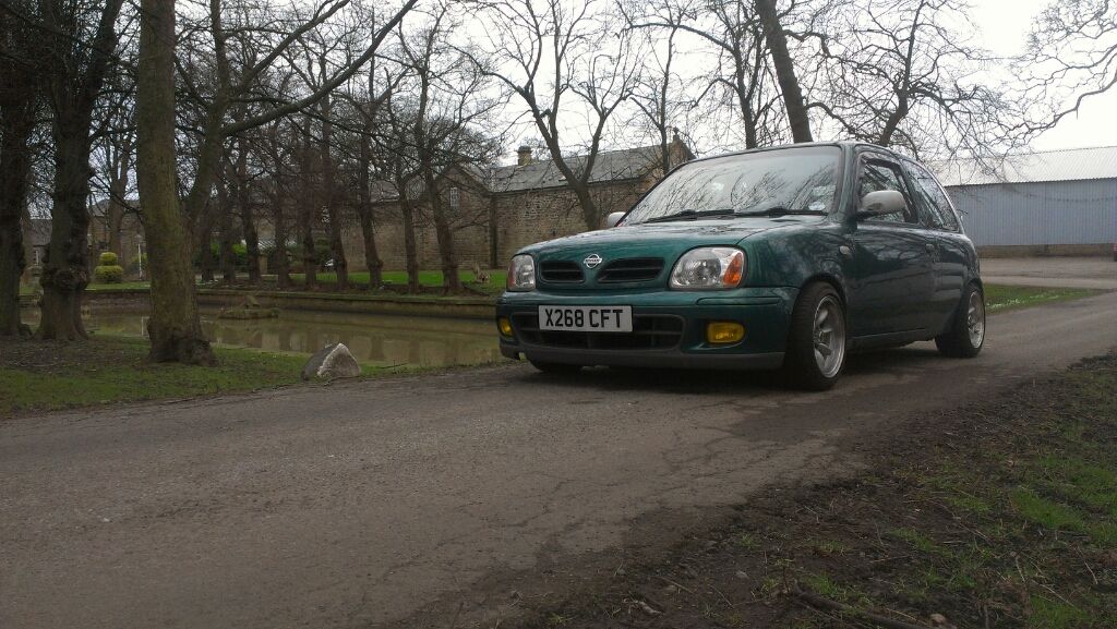

got a load of day time pics of darcy and her new wheels. the arch gap looks worse on pictures than in real life. its sitting so nice however it will be going lowere to the meet the tyre. and please excuse the rusty arches lol. will be resprayed at some point before jae 2013

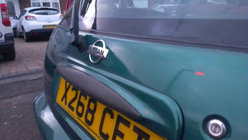

put the rear nissan badge back on. going for a nice simplicity look now

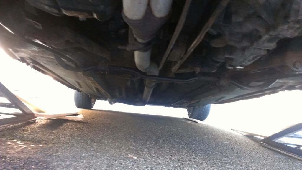

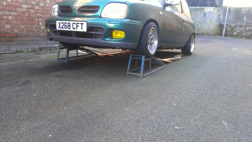

was sick of my exhaust blowing so since it as a nice day i took it too pieces, sanded the joints, exhaust paste then put them back on . sounds alot better now

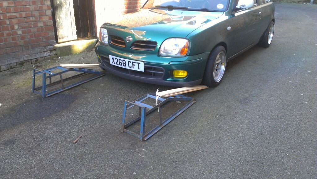

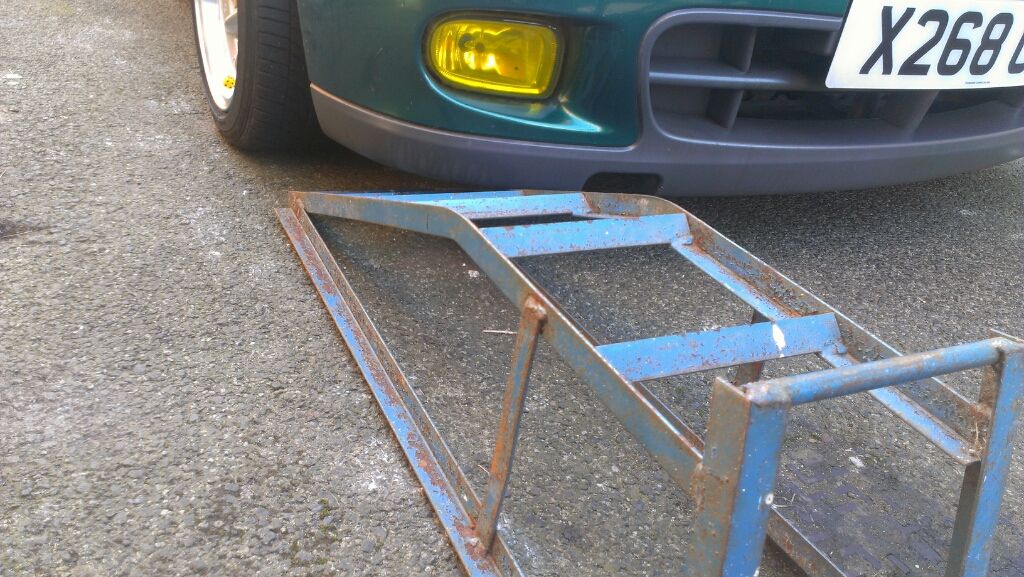

first hurdle was getting it on the ramps
just a unrestricted pipe :)

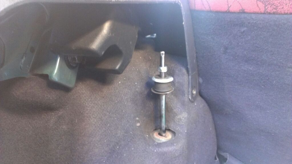

then i looked in the boot to find the new shock absorber like this. i think the problem is, is the spacer that sits under the bump stops and shcoker cover is making its way up the rubber to the top so i have put a slightly bigger spacer on and see how that goes
another problem i found as i took both off to compare

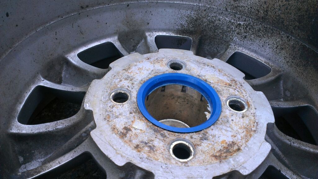

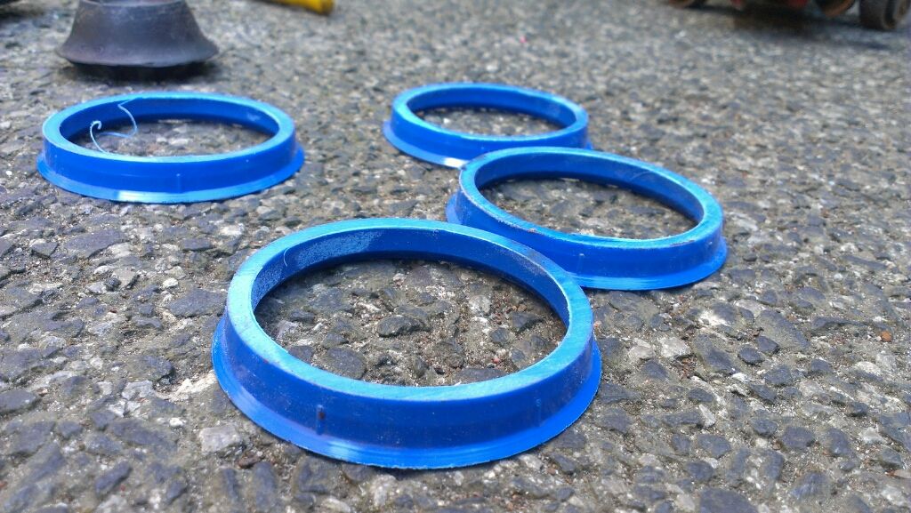

got some spigot rings with the wheels but they just didnt sit flush with wheel. took them to work and got them on a belt sander till santisfied

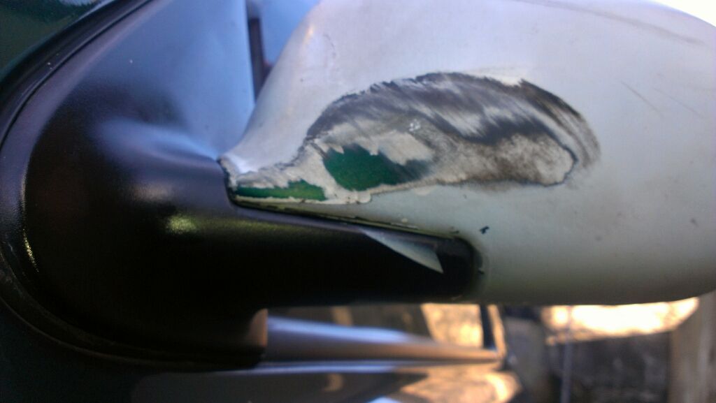

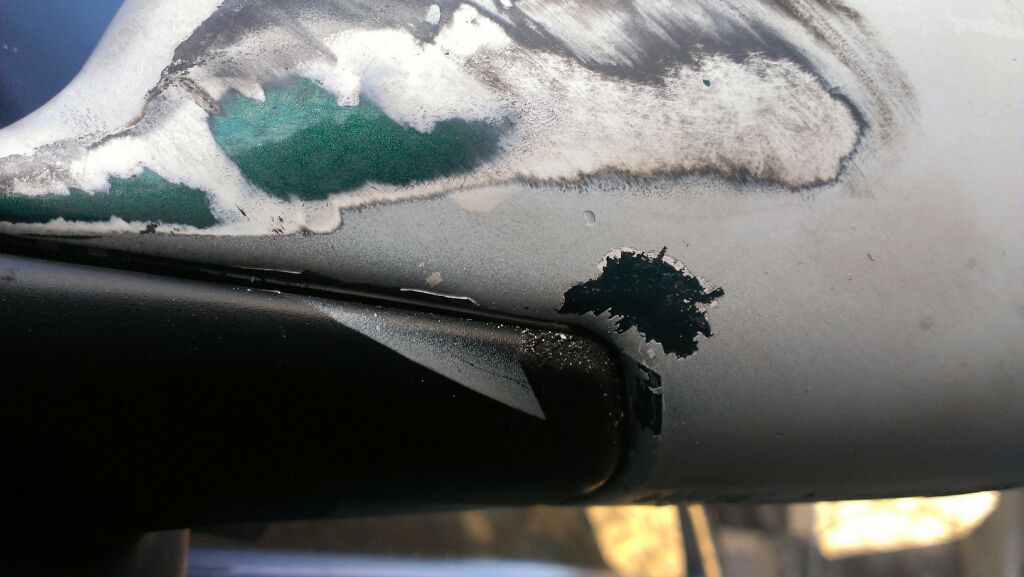

this is where a lorry wheel hit wing mirror with previous owner, ive noticed the green is still underneath and shiny. is there a way to get all the white off without damaging the green?

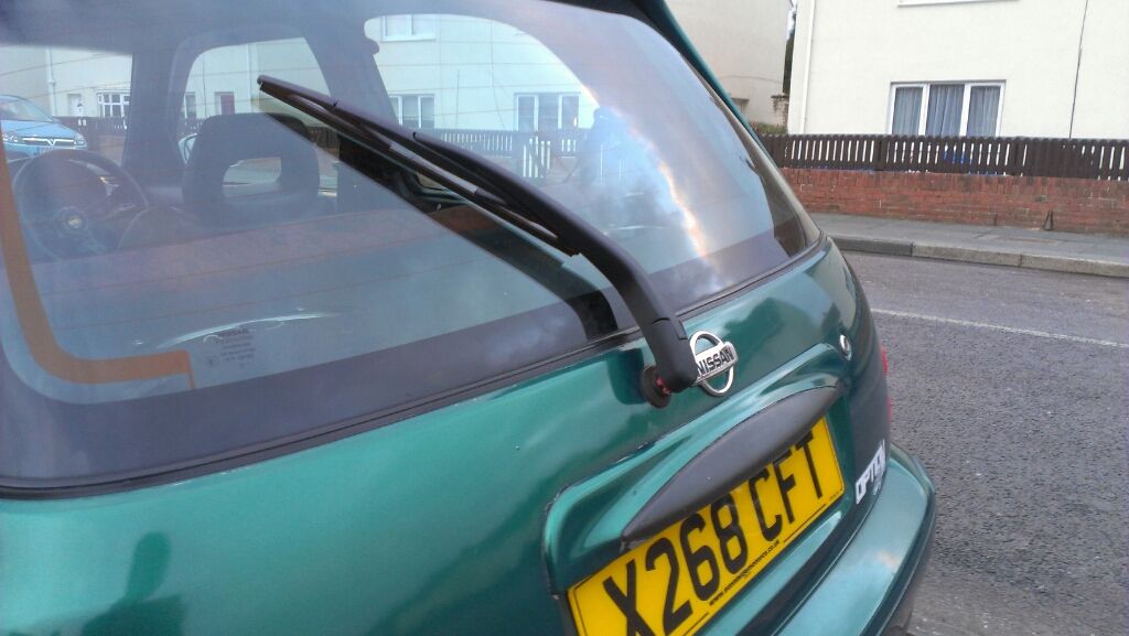

nissan note rear wiper
