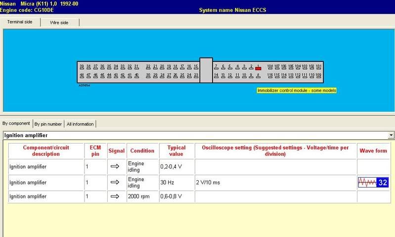

Use the ignition output from the ecu if you get that stuck. Thats the same signal pretty much as the tacho. You NEVER need to wire into the distributor on the K11s, yet so many do it.
BTW, your datalog appears to be getting noise, hence the high rpms.
I was hesitant to put it on the distributor but i didnt know any other place to take it from.
Is this it Ed?

I thought i was pin number 2 and not number 1 as highlighted in the diagram above. Which one do i use for a 1996 nissan micra sr?
Someone to confirm this please, which is the tachometer?

jabran, whats pin number 3 say? (the blue dizzy wire goes into pin number 3)
