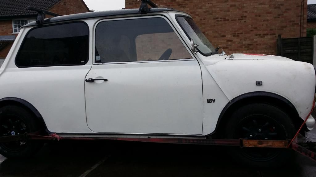

bought this
Ohs what's that I hear you say, a micra??? :)

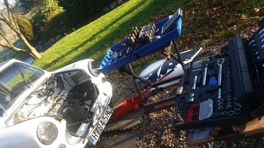

Tidied the man cave ready for some fun
Stripped the engine ancillaries

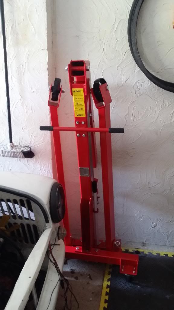

Bought this manly beast (planning to sell it afterwards if anyone's interested
It's quite compact too which is handy as my garage isn't the biggest :(

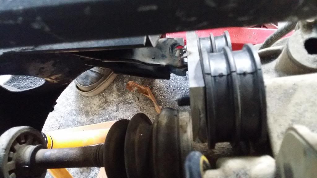

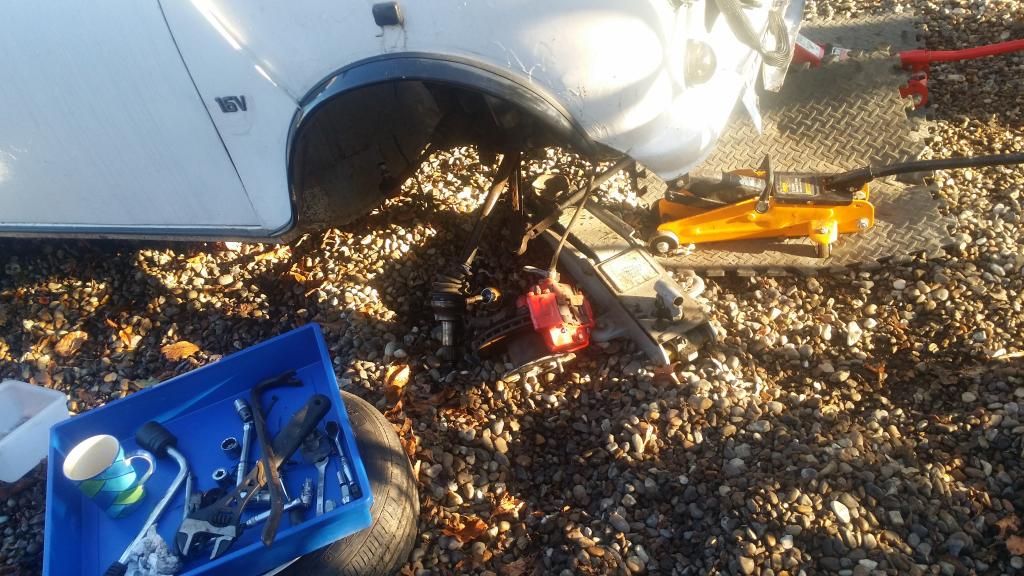

Stripped the suspension
Driveshafts and hubs out

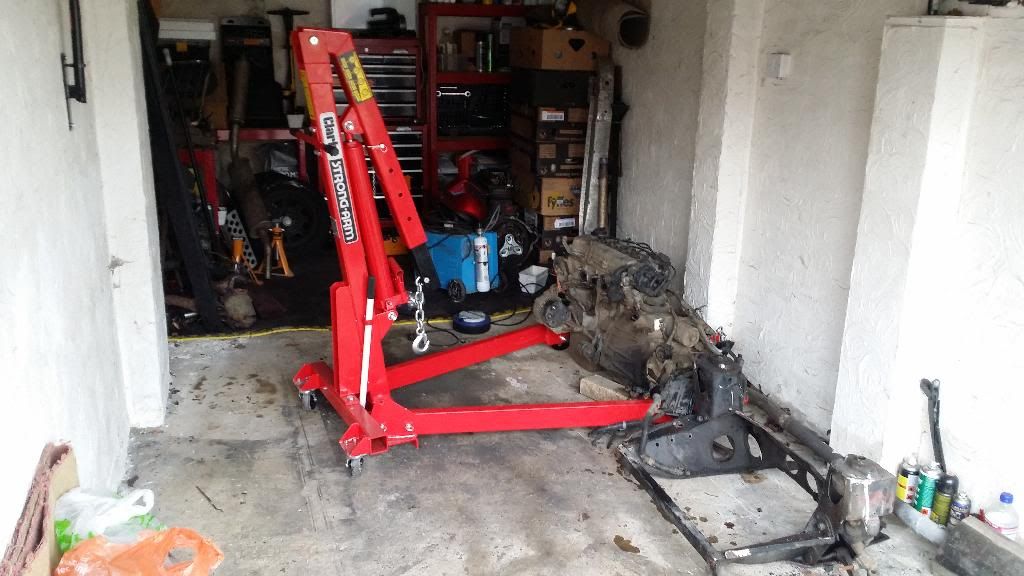

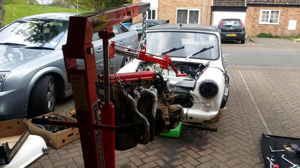

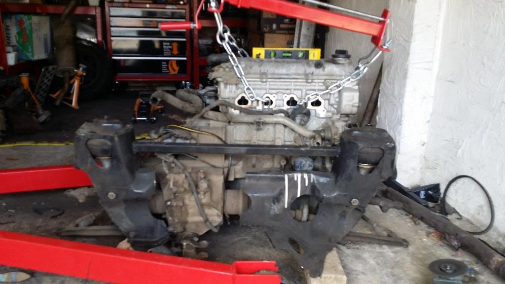

Time to bring on the crane
Out she be coming putting up a fight the entire way, noooooo she cried haha
Hanging around
And back on the floor

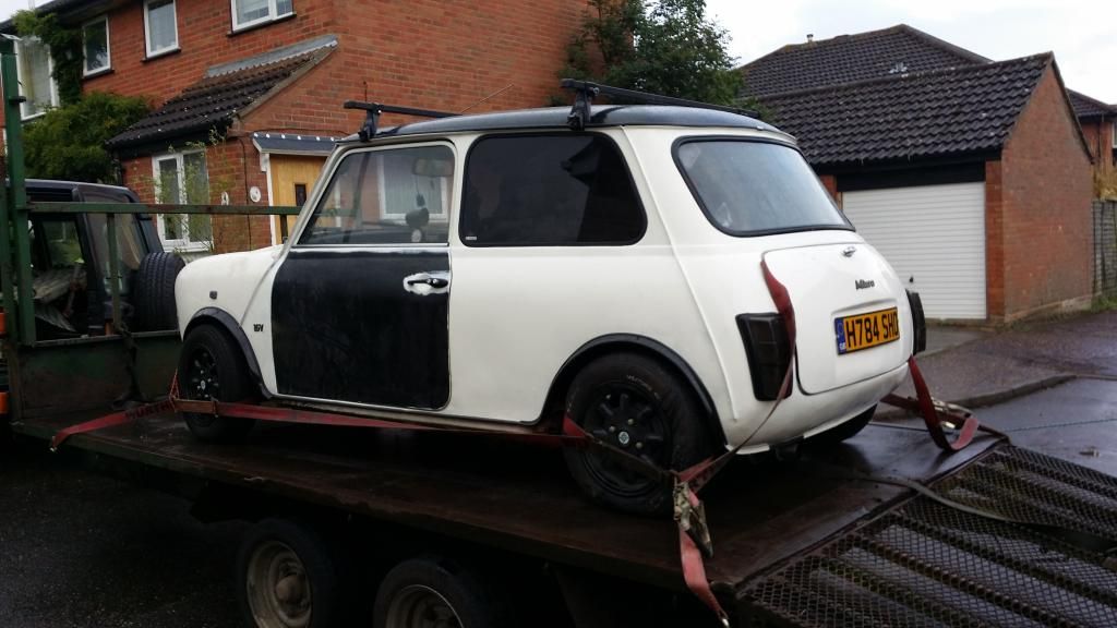

Rolled her outside with great difficulty and she's now up on bricks
And there's the micra in the garage ready for round two :)

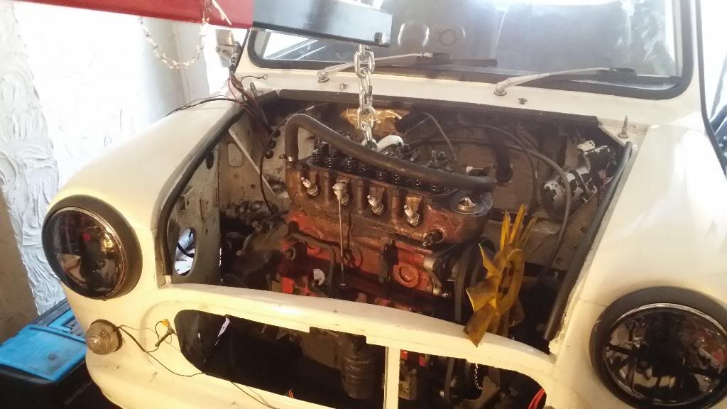

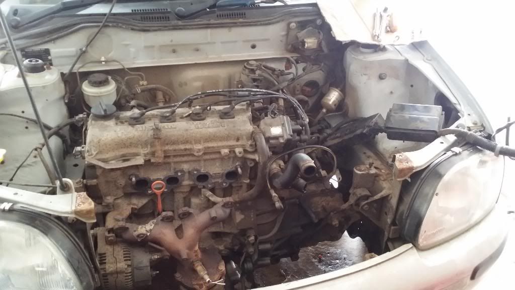

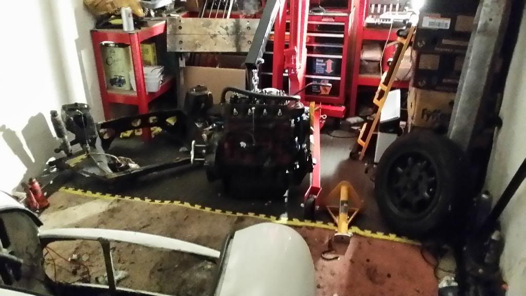

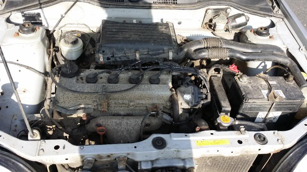

Engine in the micra stripped out ready for removal :)
It took me about 4 hours to remove everything. Half the bolts snapped! Soo annoying

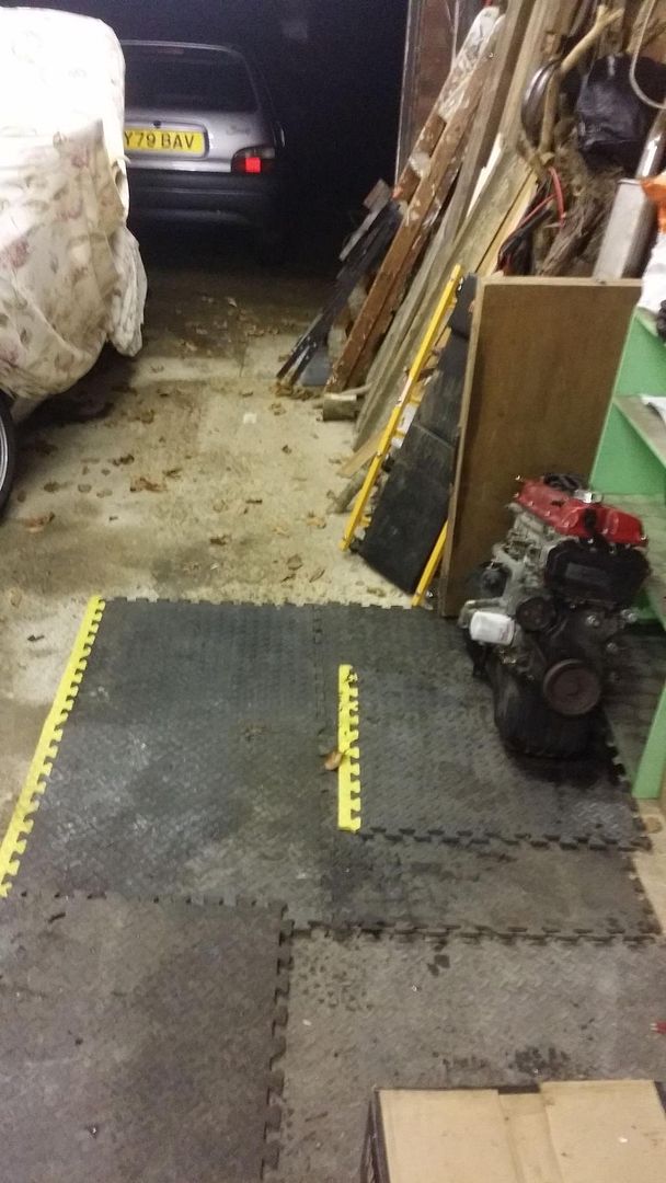

Garage once the micra engine was out and the car rolled out
Micra left out on the road
Mini up on blocks, poor car looks so dejected sat there :(

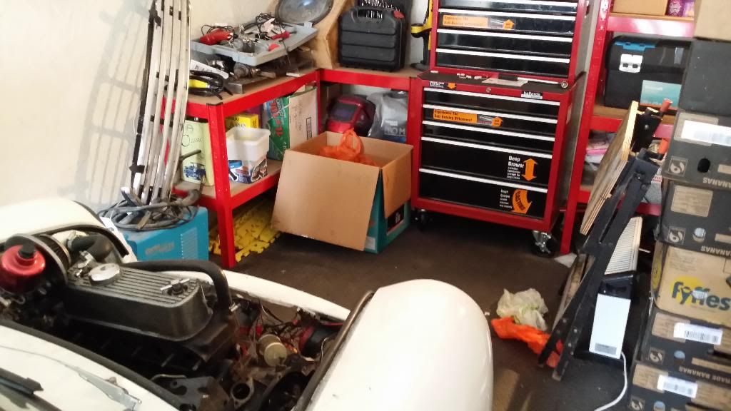

Garage all arranged ready for some fabrication :)

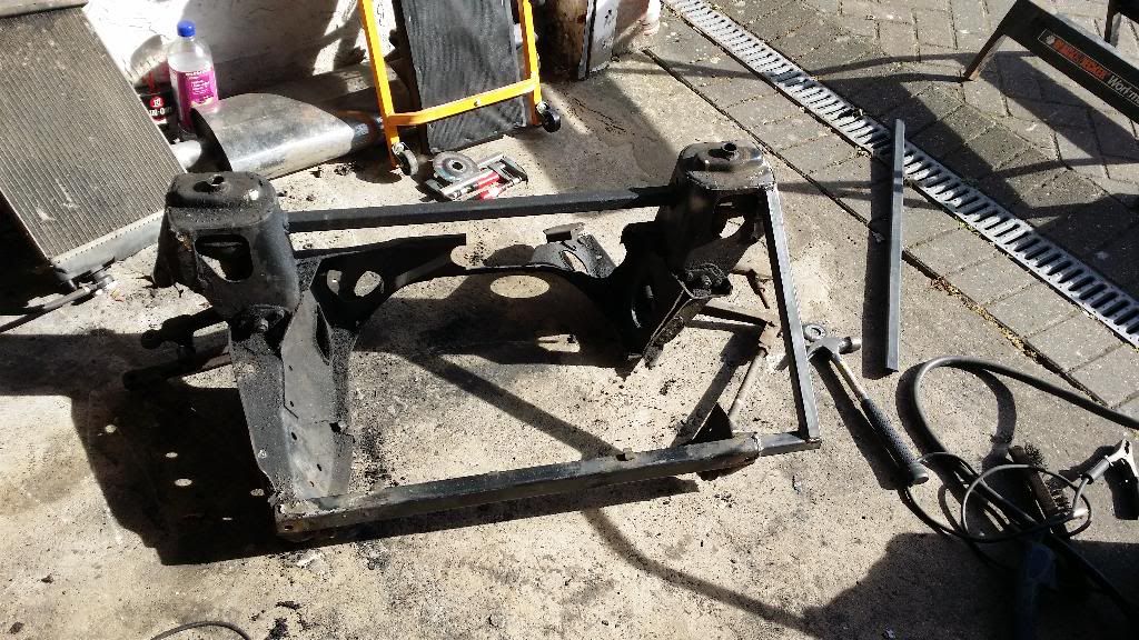

Making the frame

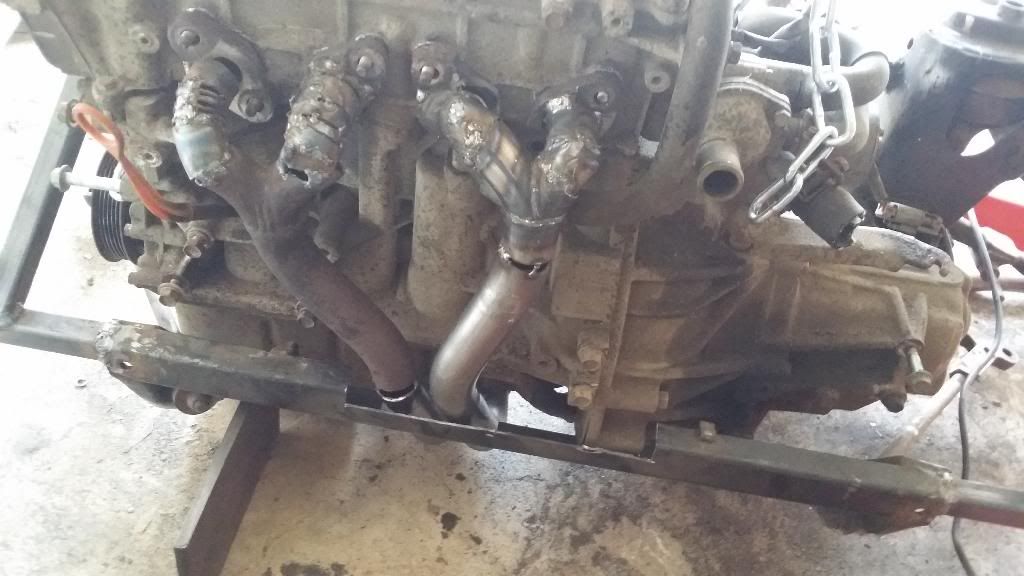

I've started fabricating the exhaust manifold for the k11, got it all modeled on the mini lcb so I can still fit standard mini exhausts in the future, it's made of two lcbs morphed together
Now all tacked together and starting to look like an exhaust

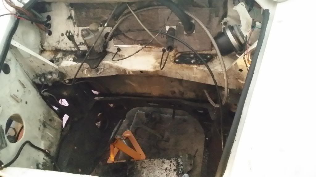

Crane bought out again to see where I need to cut

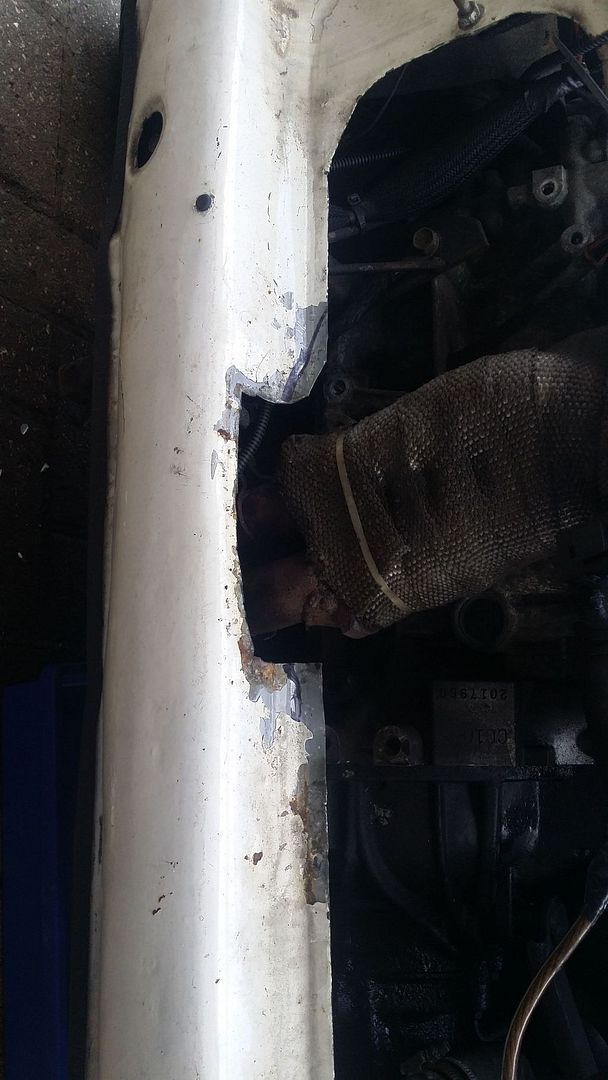

Reinforcement bar welded to the turrets to make up for the hole that will appear to clear the micra diff

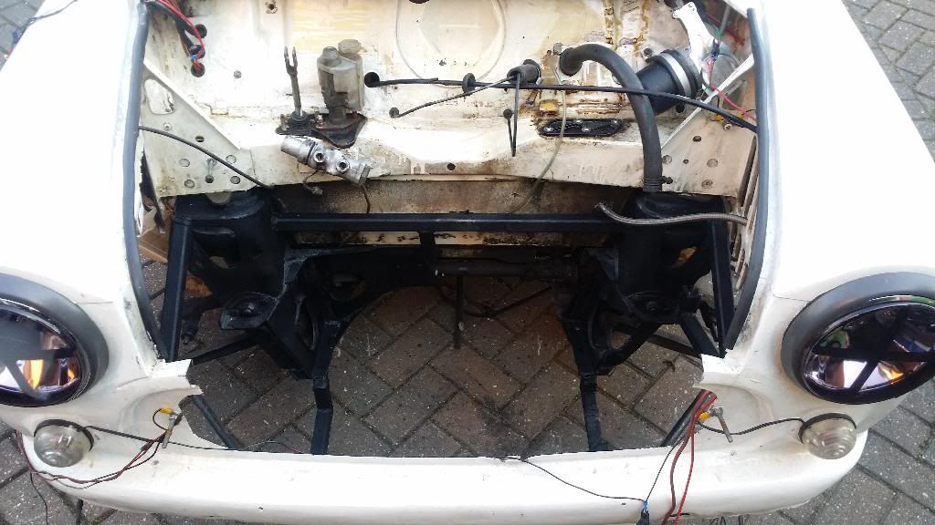

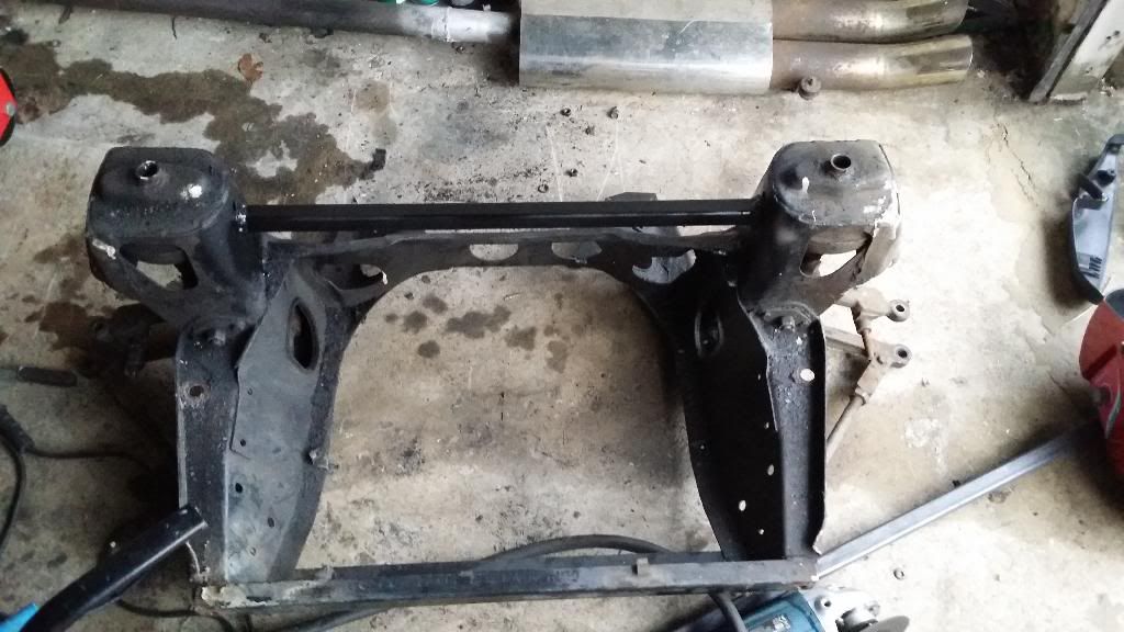

Made a start on the subframe :) got the first side done and cut out
And the other side
Engine fits which is always a winner!
Pretty snug on the drivers side
I had to trim around where the passengers side inner cv is to give it some clearance
And it's nice and level sitting in the frame also :)
It will clear the bonnet, I've got about an inch clearance when I measured it
And I've trimmed the original front of the frame to clear the exhaust which I've yet to finish welding up

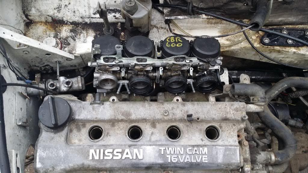

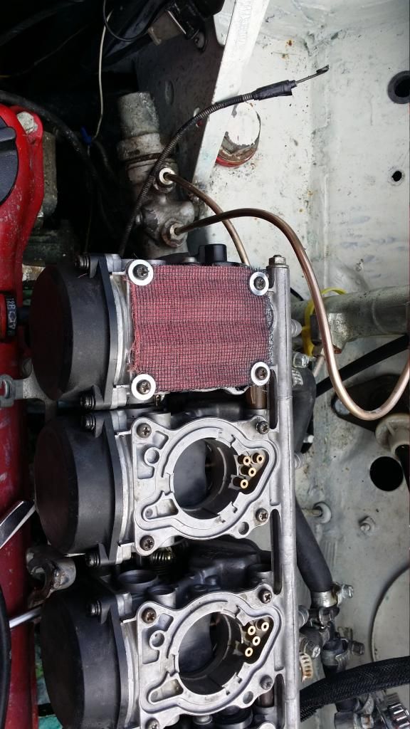

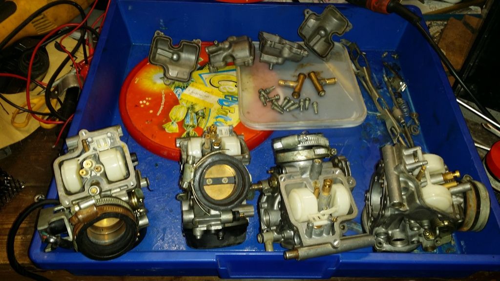

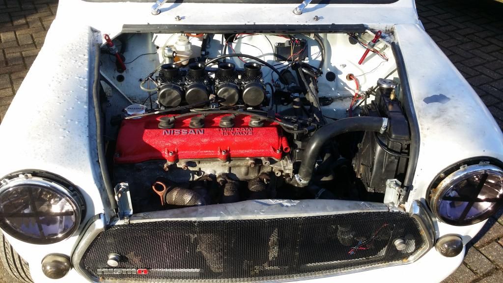

Bike carbs have arrived :) got them at a good price too which is nice

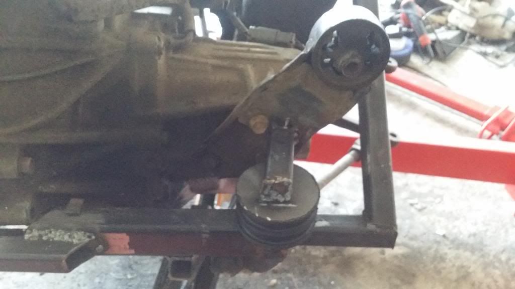

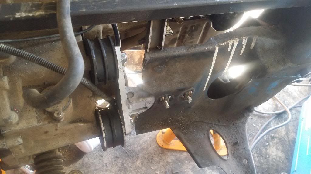

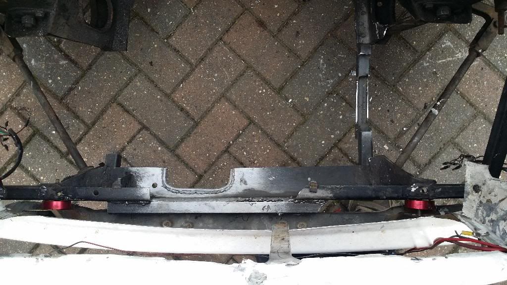

Started on the front engine mounts. It's difficult to think where to put them that will be stable and strong yet you can still undo the bolts!
Closeup of the ps one
Close up of the ds one
And the rear mount
I chose those positions because they are the most out of the way of anything, plus they are using the standard mounting points the micra used so should be strong enough :)

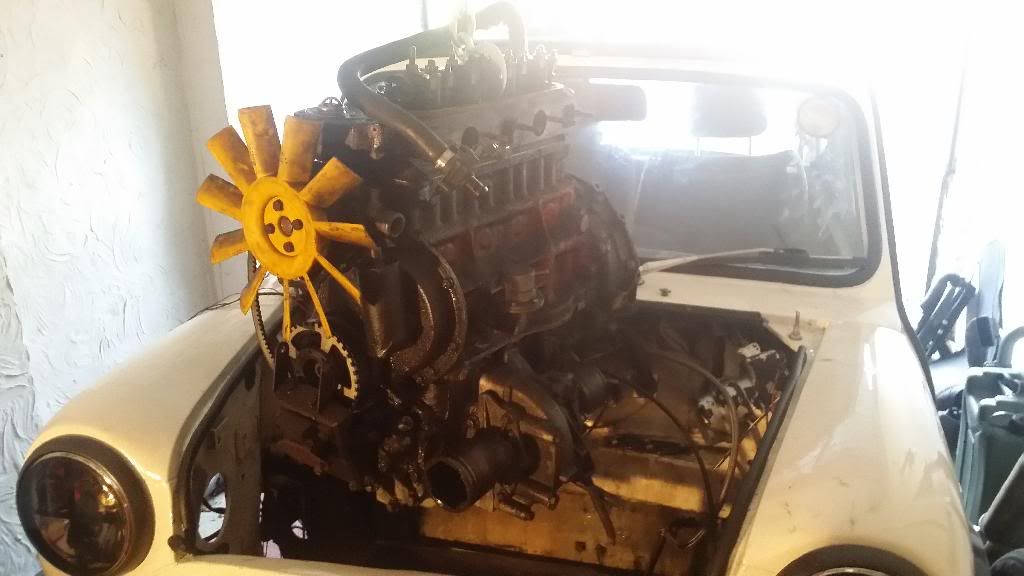

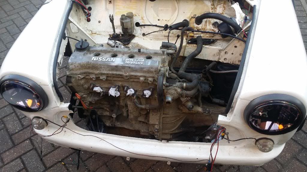

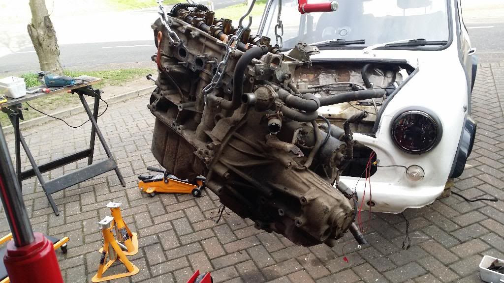

Engine hovering in the air :)
It's trial fit time :)
Had to trim the lower leg to get more clearance

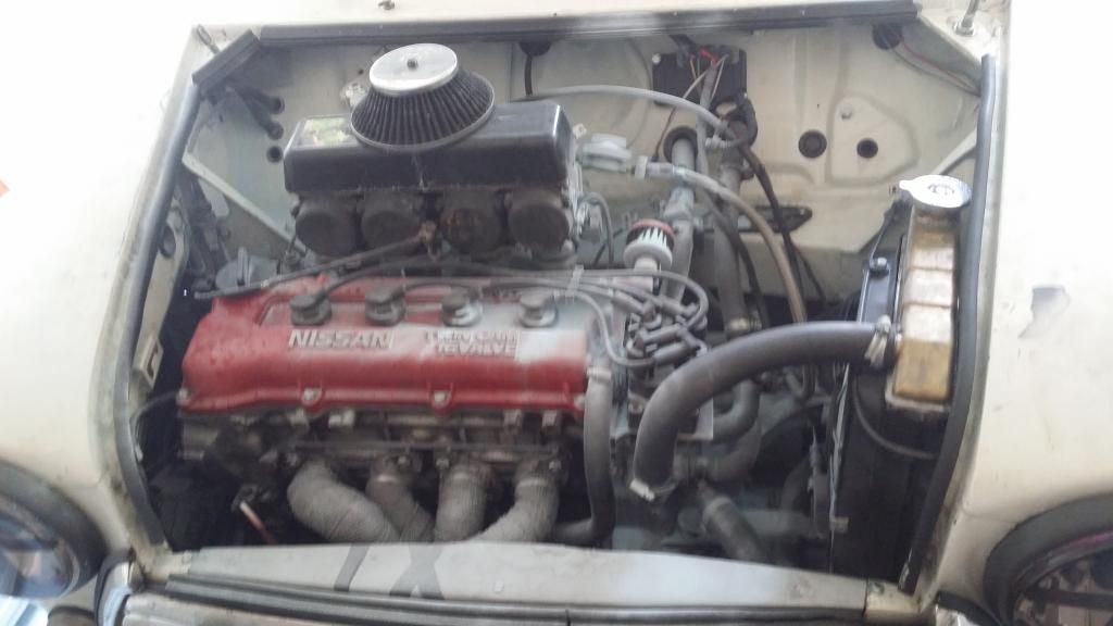

And there we are, mr engine tucked into mini.
It took me almost and hour the get the engine into the car without damaging the car (doing all this on my own)

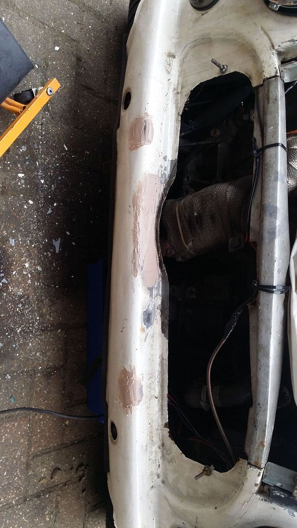

I decided to trim most of the inner wings, I know physically it can be got away with but it's going to mean most work to do on the car will be an engine out job. I'm also going to make the front slam panel removable so she's easier to work on
Exhaust trial fitment and everything clears
Carbs in their rough position
Tightest part

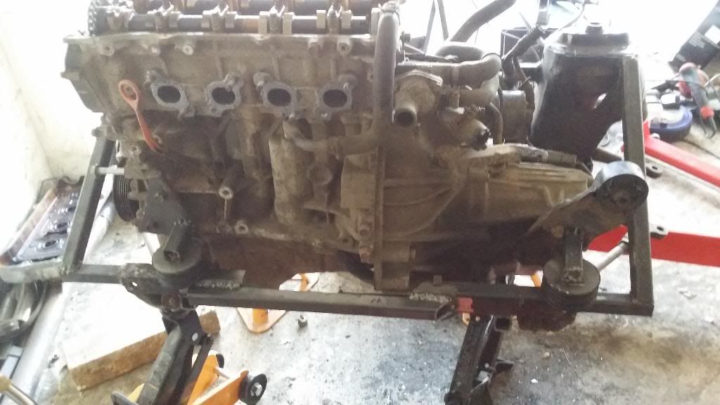

So that's day two. I got the frame in the car and the mounts on the engine, bits and bobs need trimming but nothing too drastic which is nice :) onwards to day three
Day three
Engine and frame back out again for final welding and strengthening

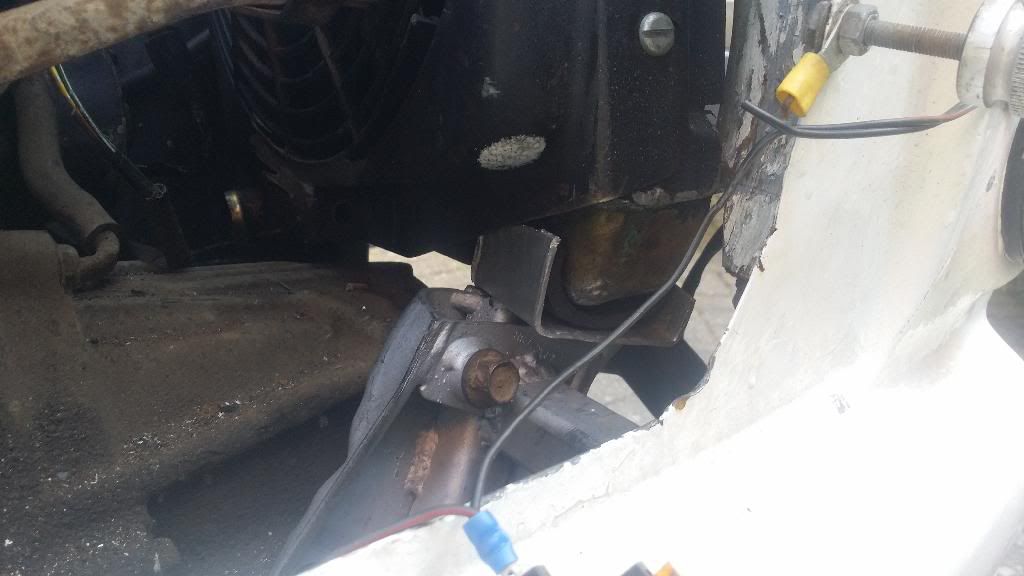

Engine mounts beefed up
Tacked together the lower leg on the left
Frame in primer
Frame painted :)
And frame back in the car, scratched everywhere which is mildly annoying

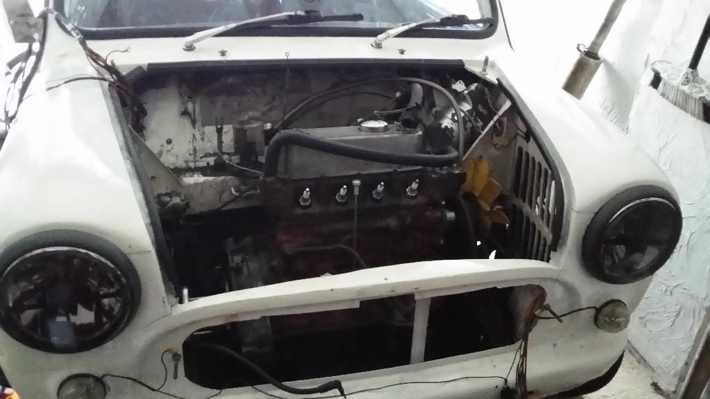

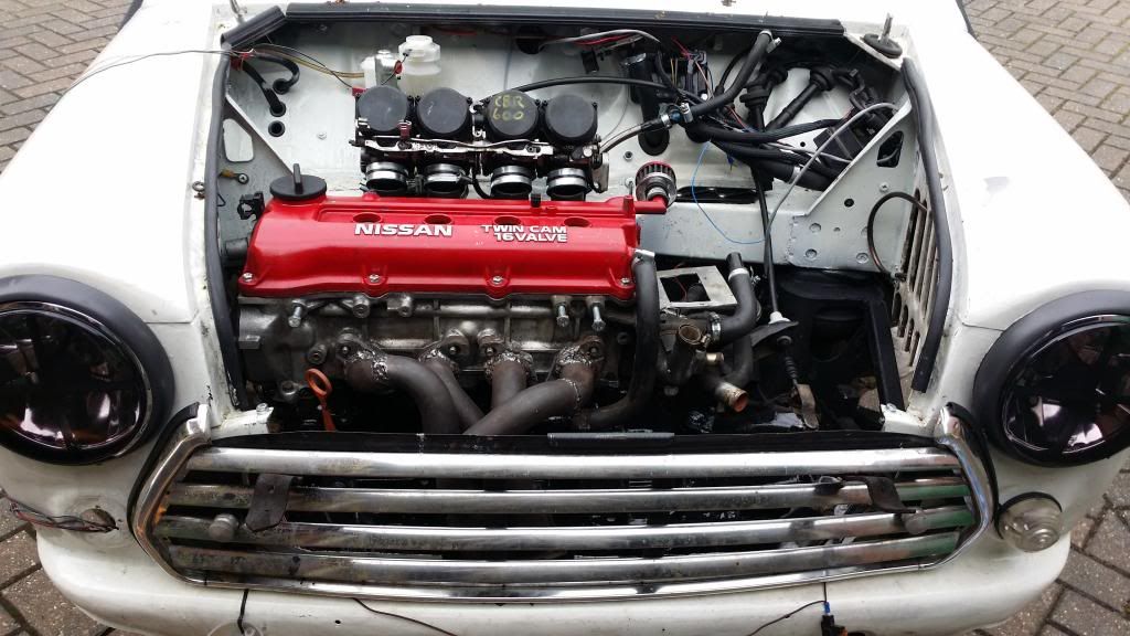

And voila engine back in the car
So that's day three
In conclusion folks the engine is now solidly mounted in the subframe, everything clears and lines up nicely.

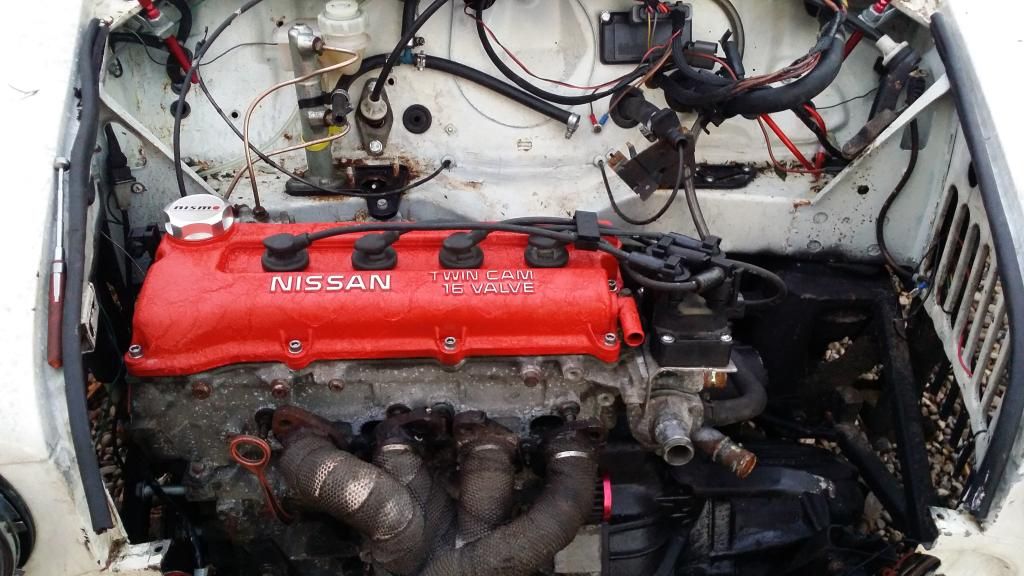

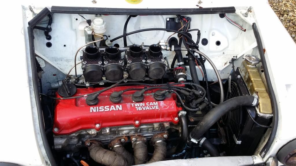

Clutch, inlet manifold and painting
So people, next update :) today I've been cracking on with the cluch, inlet manifold and gear shifter :)

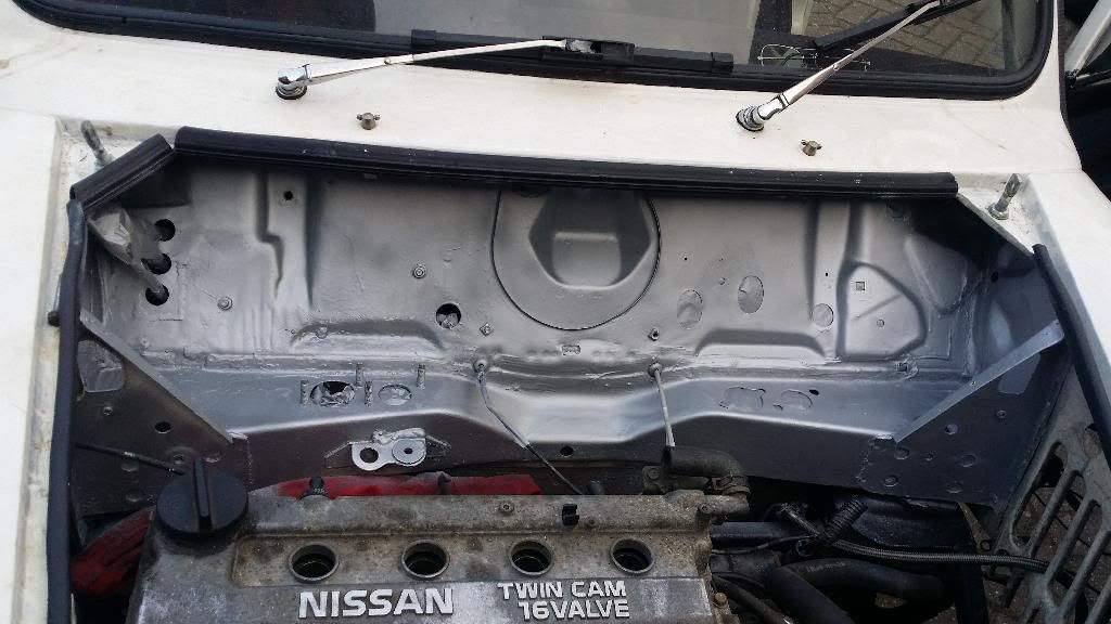

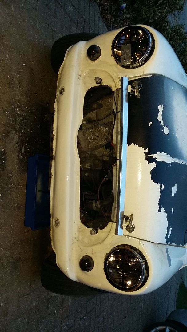

Also finished primering the bulkhead :)

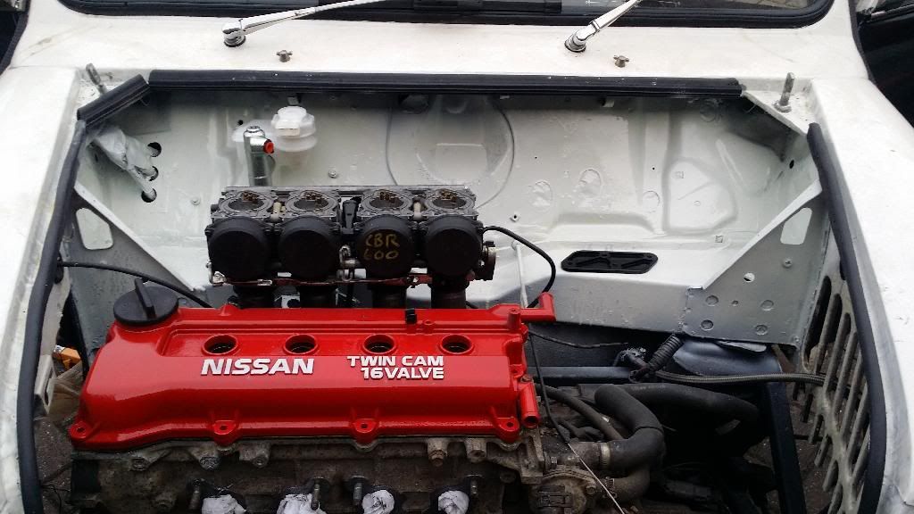

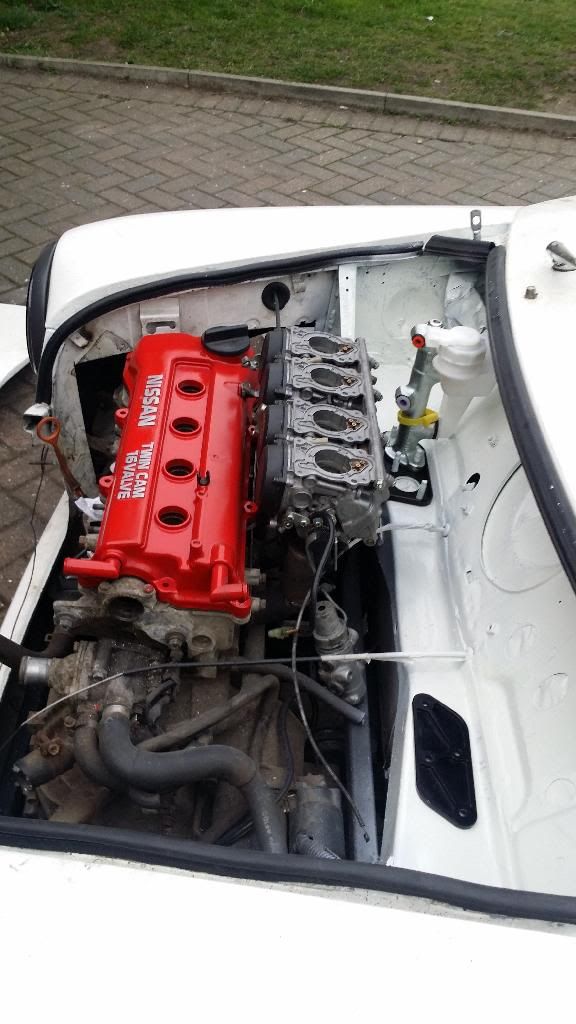

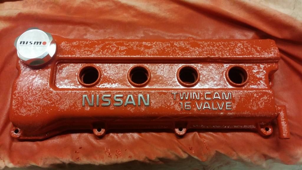

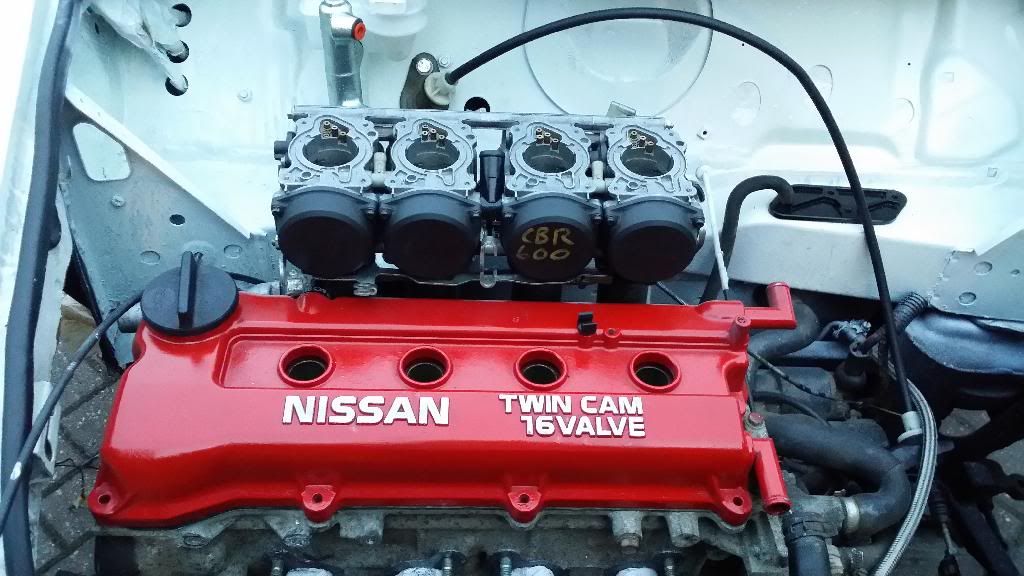

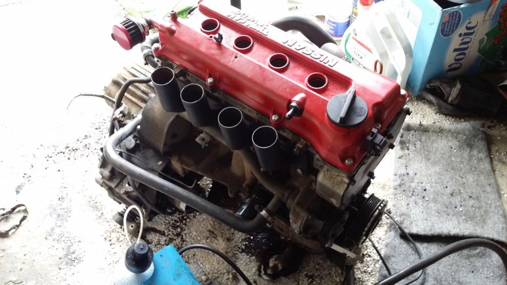

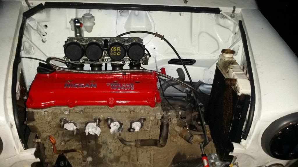

Bit of cheeky radiant red for the rocker cover :)
Bulkhead painted and bits and pieces put back In place, all looking pretty awesome tbh

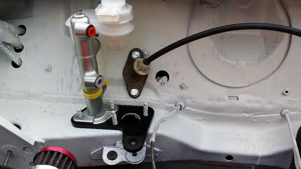

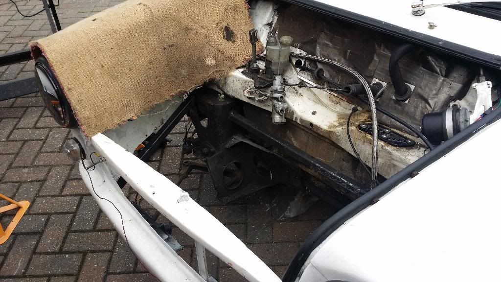

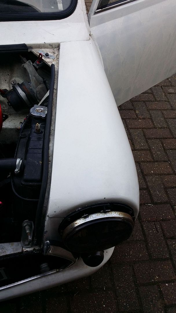

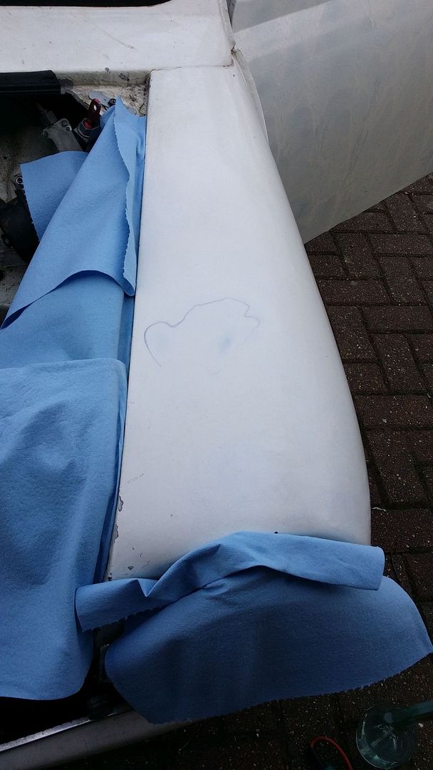

Plenty of clearance between the carbs and brake master cylinder

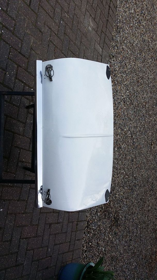

Not so much for the bonnet, looks like a bonnet scoop may be in order :)
New rad position also
Made a start in the clutch
Tacked together and working nicely :)
Clutch arm removed for final welding

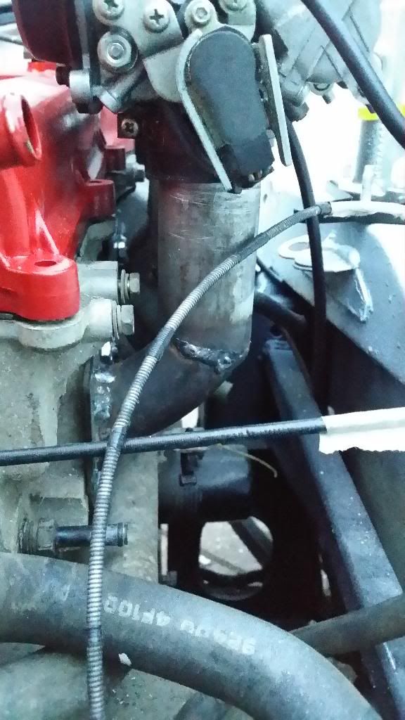

Inlet manifold fully welded up
As I've left her tonight

In regard to the engine mounts, I've since strengthened the rear one but when I change to the 1275 micra engine I'll redevelop it again

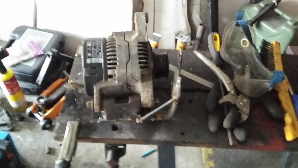

Alternator bracket redesigned, thanks for spotting this out people.

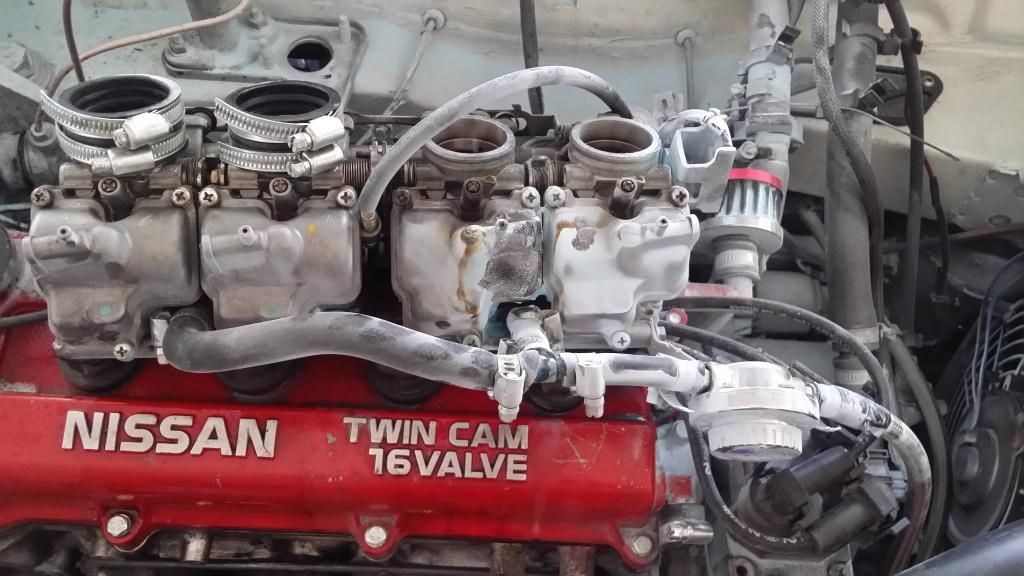

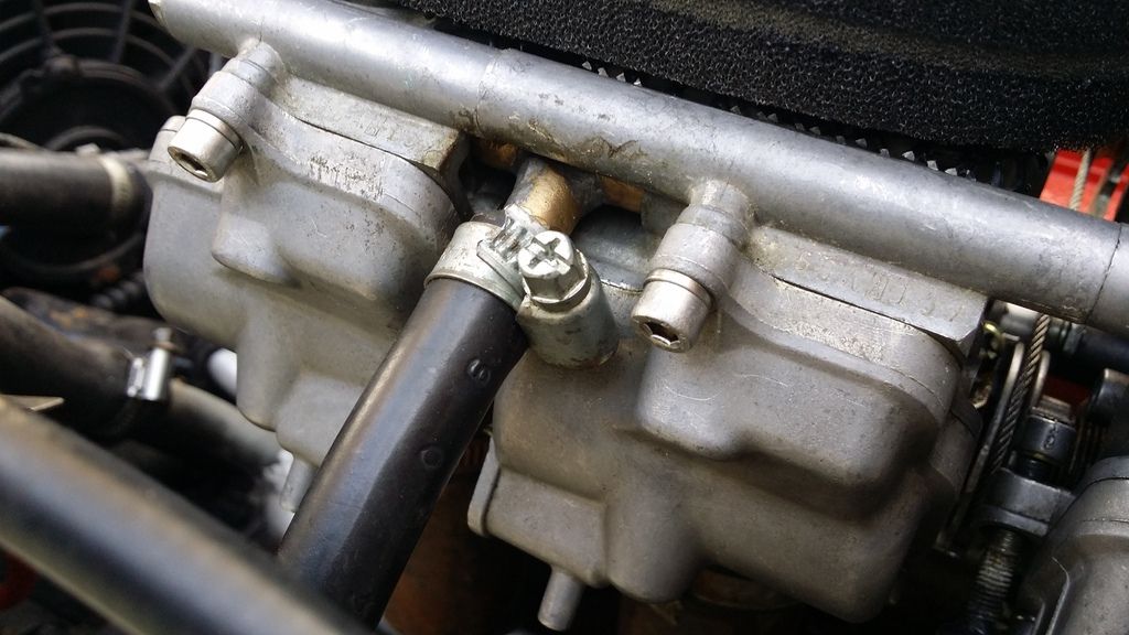

Carbs fully plumbed in, all cable and fuel pipes connected
In regards to tuning the carbs l jones, I've left the manifold bare metal for the time being and is bonded to the block with just instant gasket so I can remove and adjust the angle if needs be, however the engine is running sweetly at the moment so I think I may get away with the angle they are at, I've got my fingers crossed but I do have room to adjust the carb angle if needs be

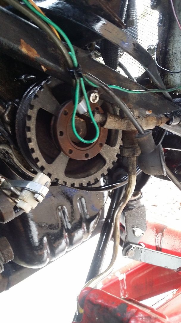

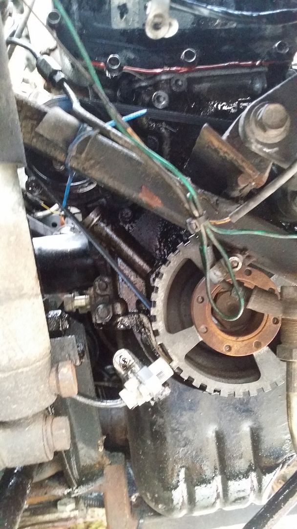

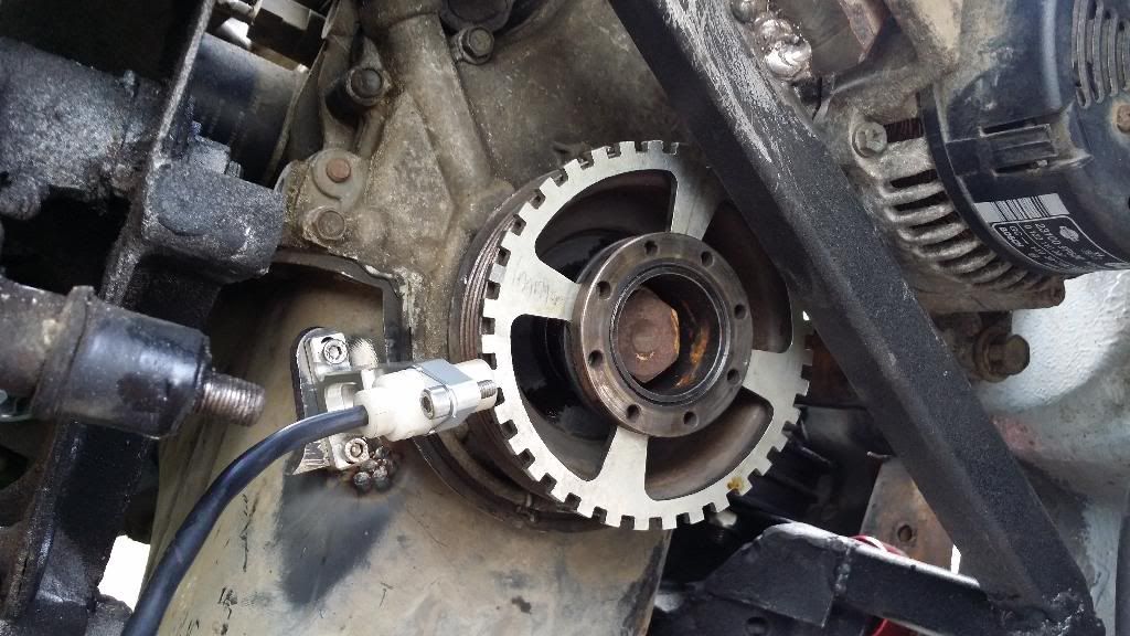

Trigger wheel fitted nicely
It's using the specalist components mini trigger wheel and boss, it fits nicely to the micra hub with a penny washer to align it up

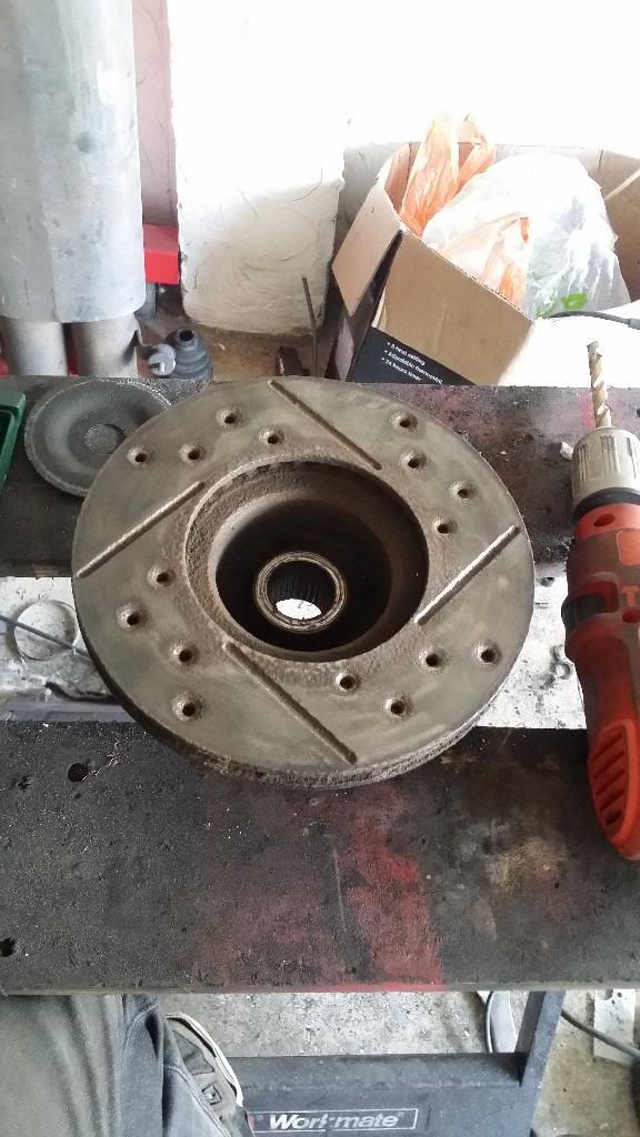

Cleaned up my brake disks

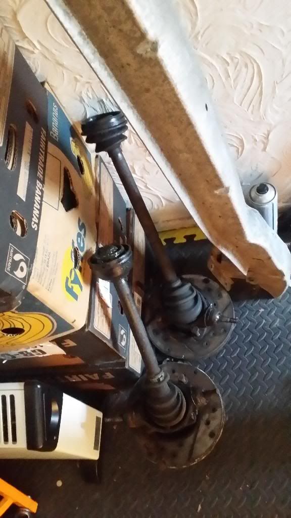

Driveshafts have also now been sent off, hopefully should be finished some time next week so I can out the hubs and wheels back together :)

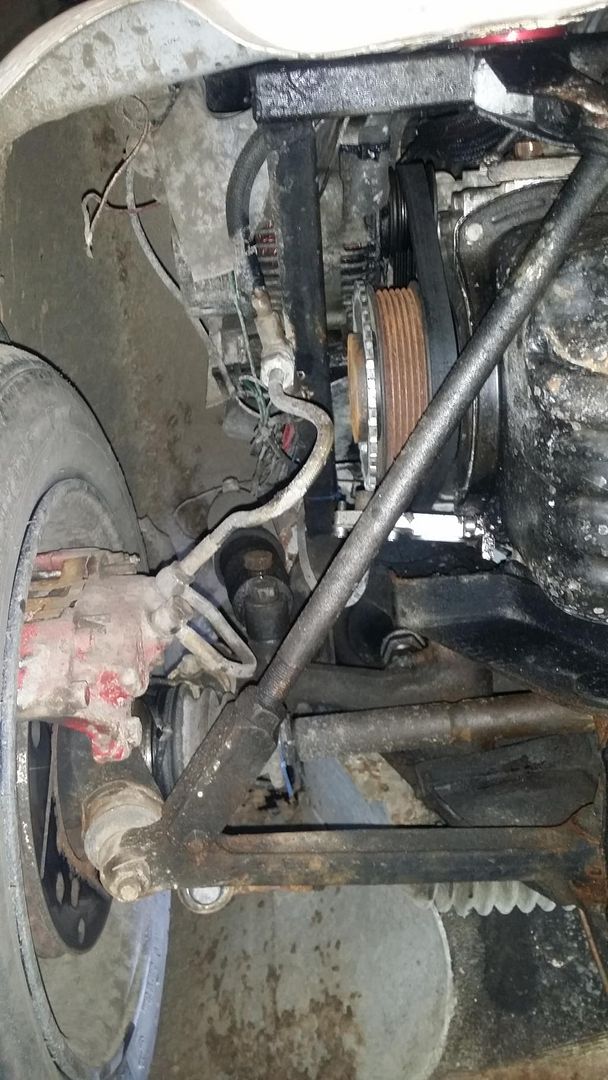

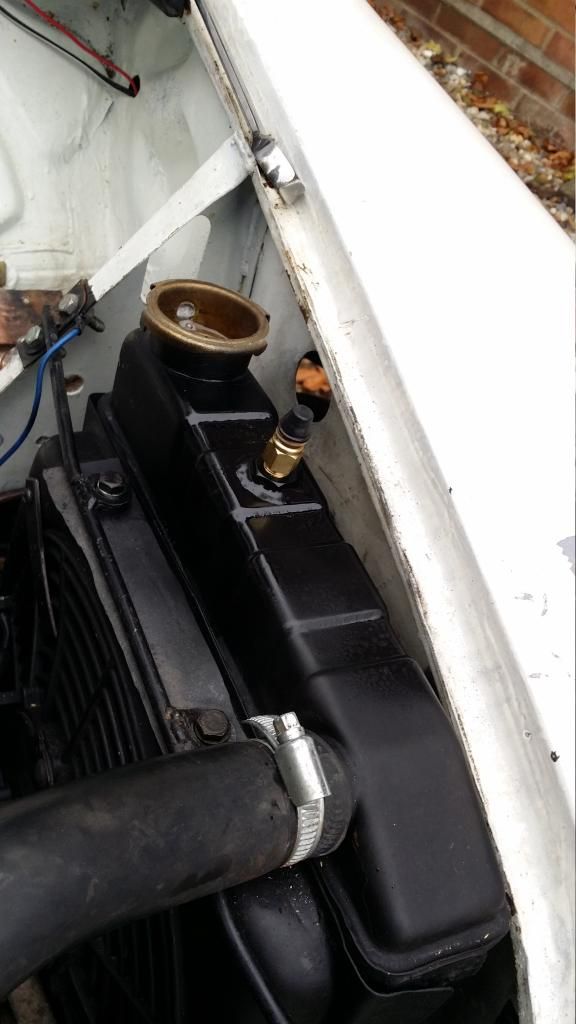

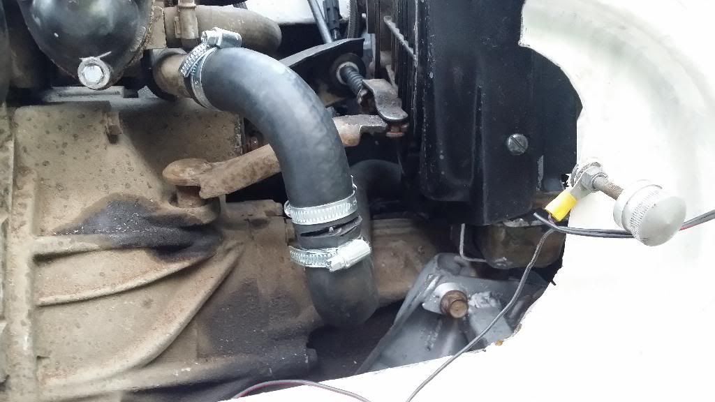

Lower radiator steady made, rubber lined to protect the rad, nice clearance all round too

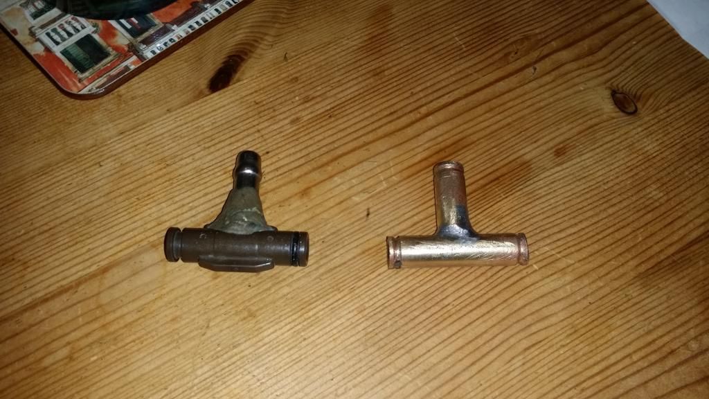

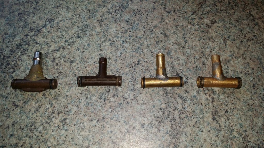

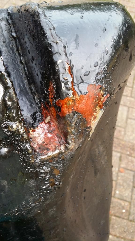

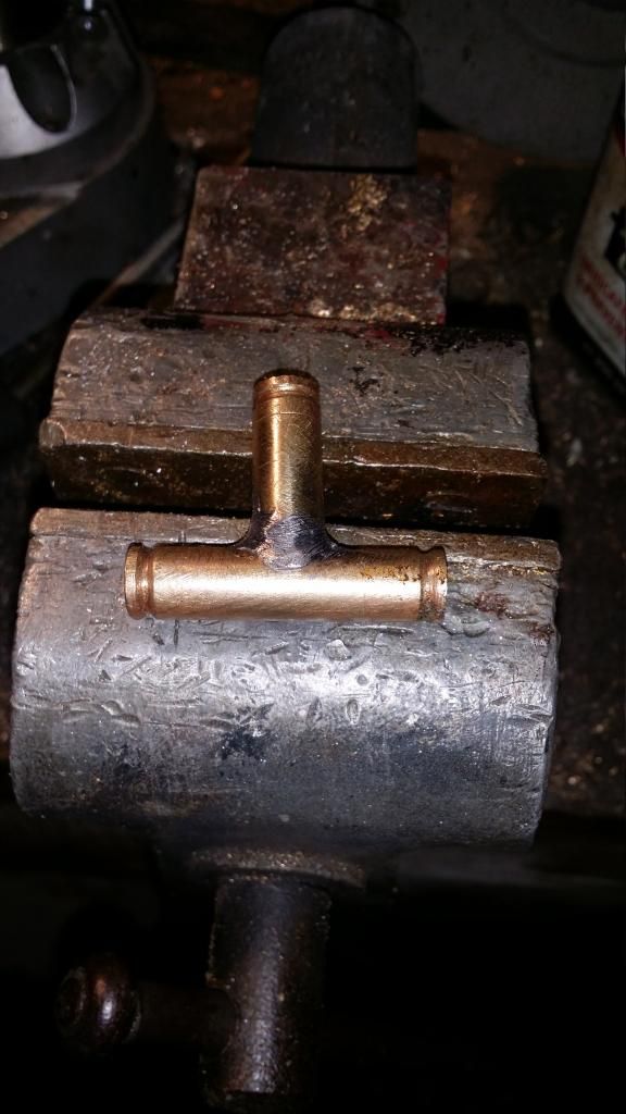

Rad leaked :(
Had to take it all apart and find out why, my soldering was fine but some bolts I used were too long and went into the cores, stupid me, all soldered up and fixed now, rad no longer leaks!

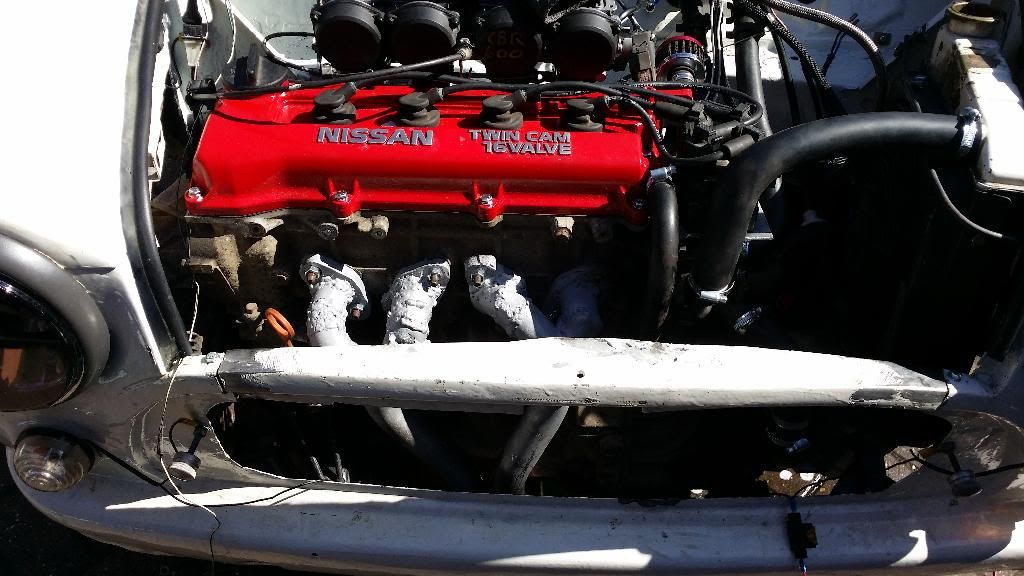

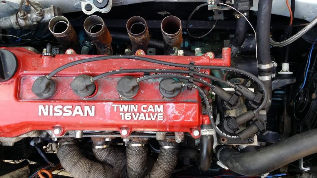

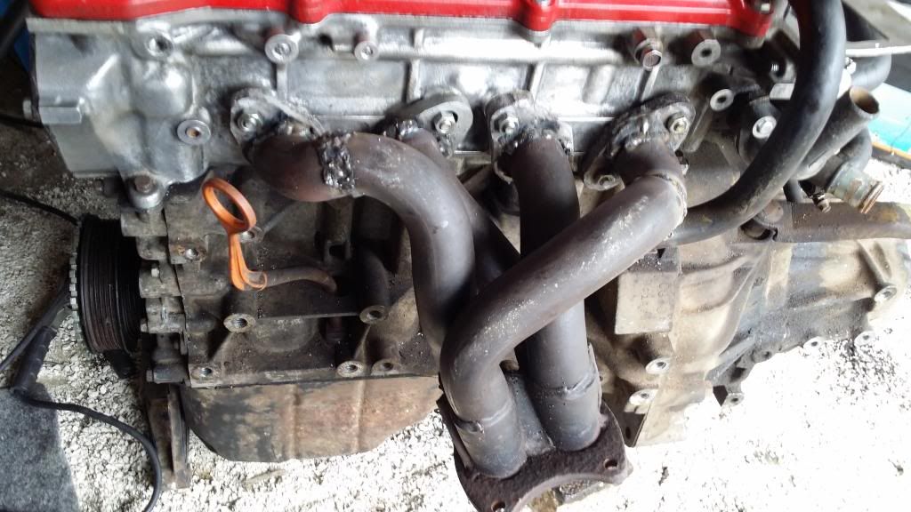

Exhaust welded up and fitted, looks awful but the flows good, I'll change it for a k series when I get a 1275 micra engine

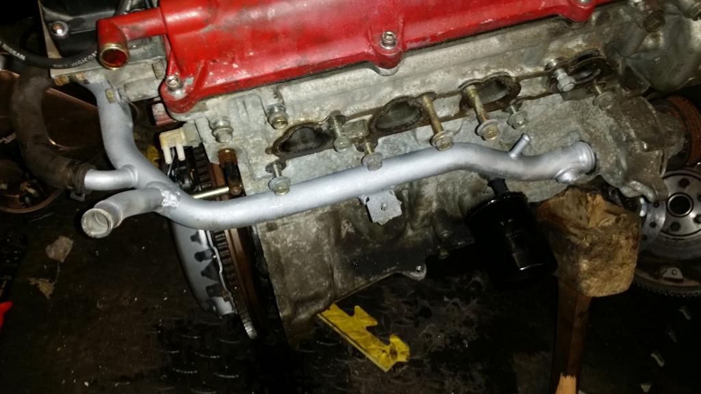

Sorted out the coolant hoses and connectors
Mini part fitted to give me a nice angle to work with for the coolent system :)
Another pic of the finished exhaust

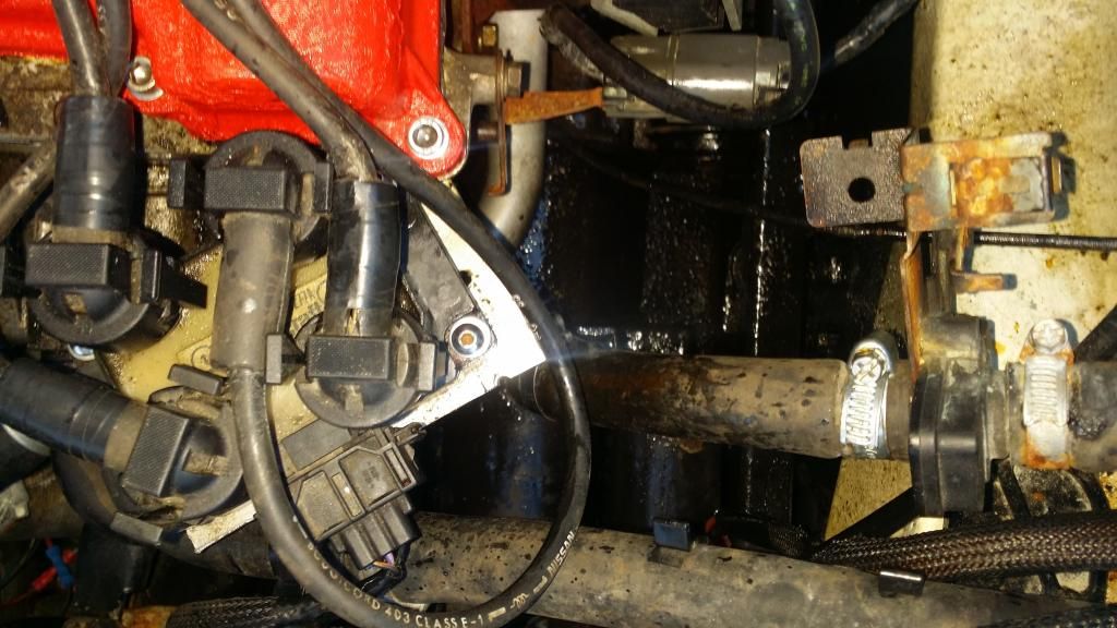

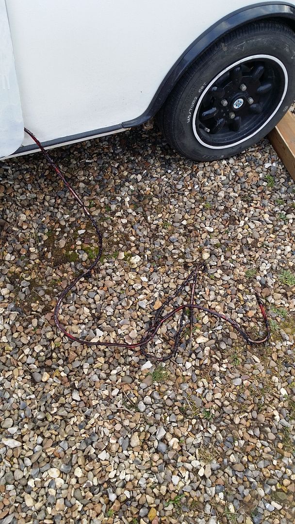

Megajolt system all fitted, all wiring soldered, heat shrank and covered in expandable braiding so looks well tidy

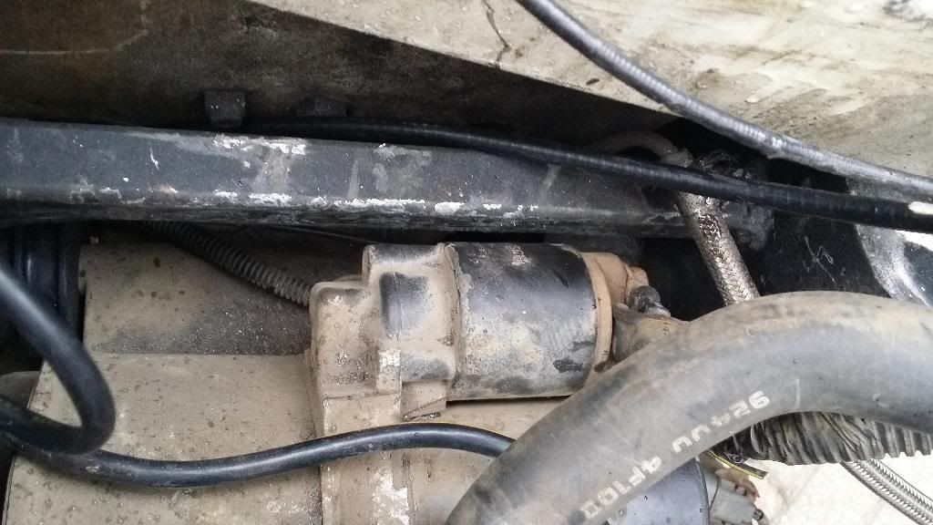

Starter motor all wired in also
New washer fluid reservoir and pump, fitted in the wing out of the way

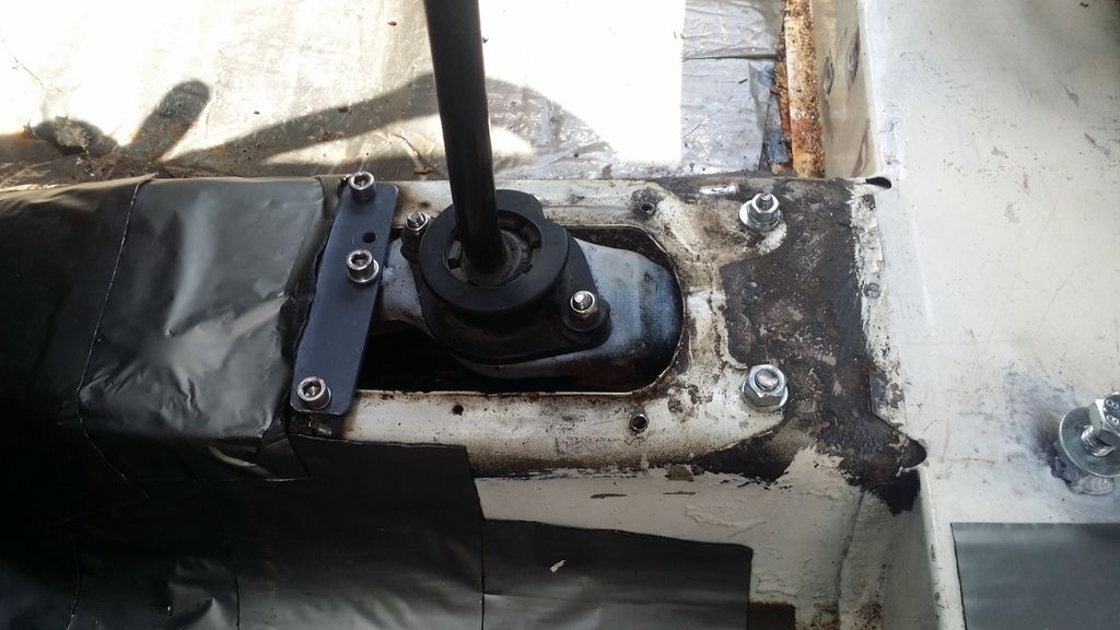

Gear shifter mechanism sorted and shortened
Megajolt plug given a home
Megajolt fitted

Driveshafts - once picked up and fitted will be done

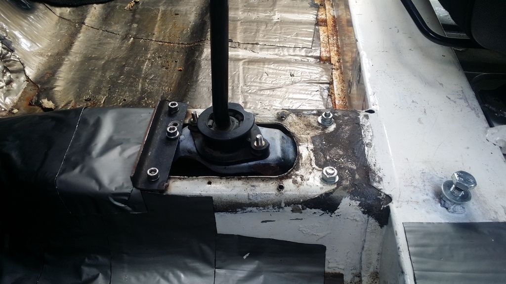

First off I've finished the gear shifter and put the centre console back in, it's modded to give me a shorter shift too which is nice

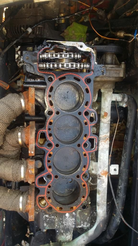

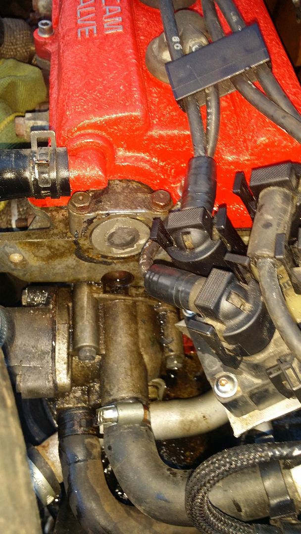

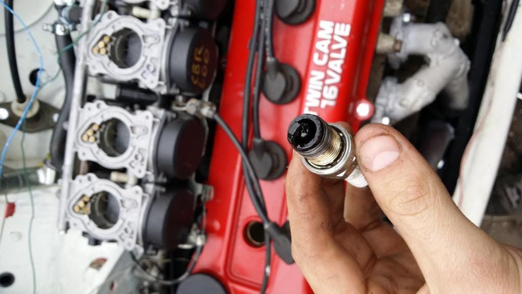

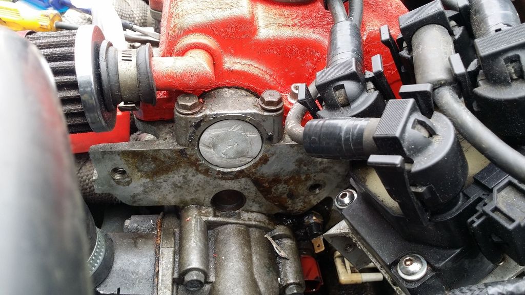

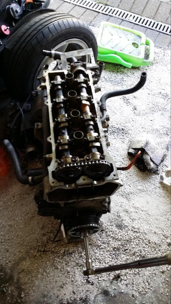

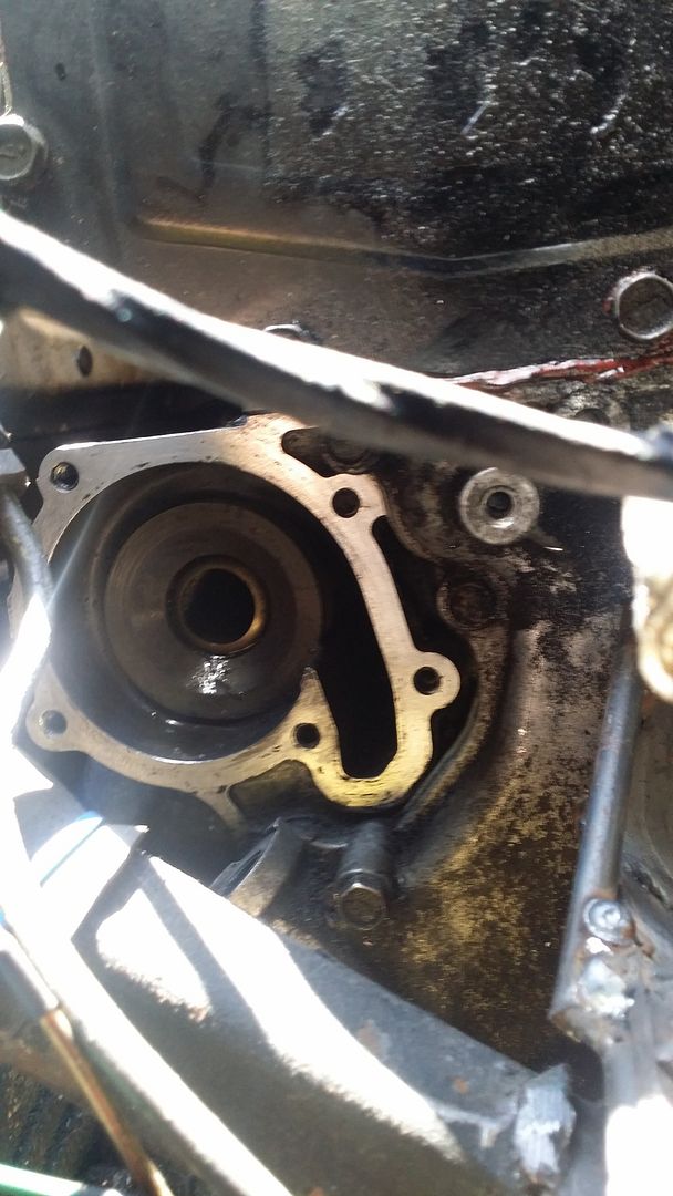

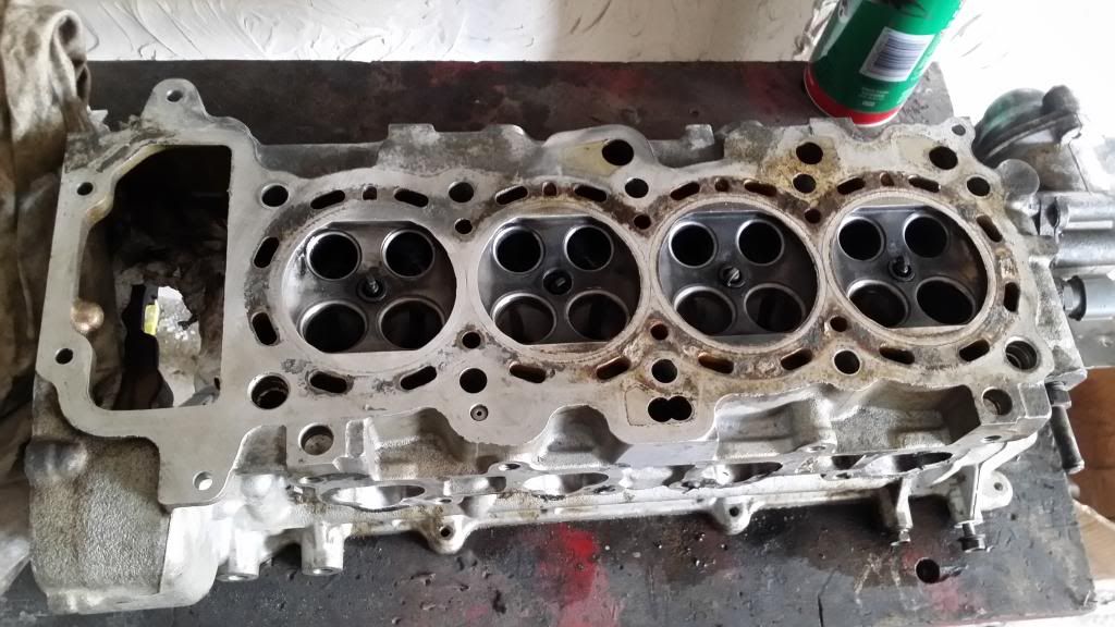

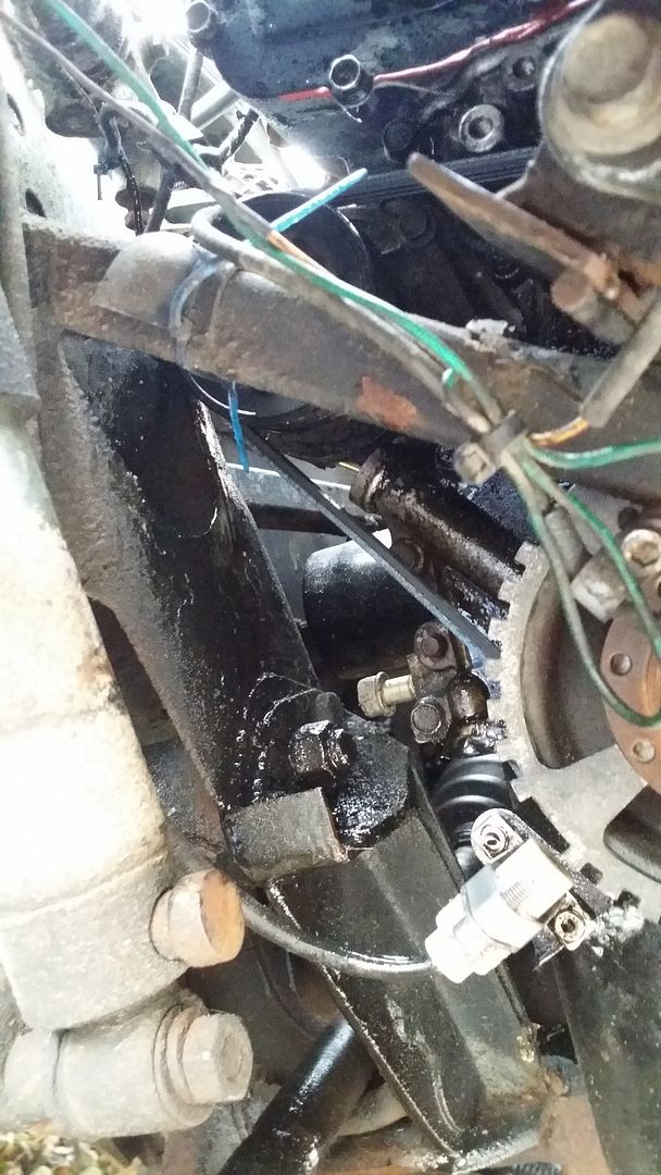

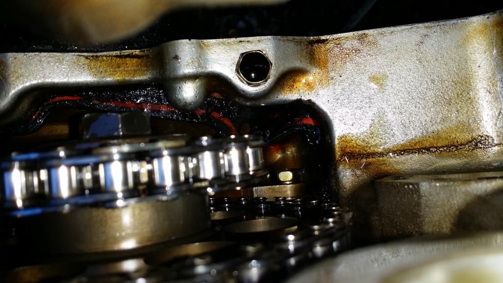

However on the first warm up run I seem to have gained a bit of an oil leak/petrol leak from the engine
Pulled the plugs
Exhaust showing a mix of oil and petrol

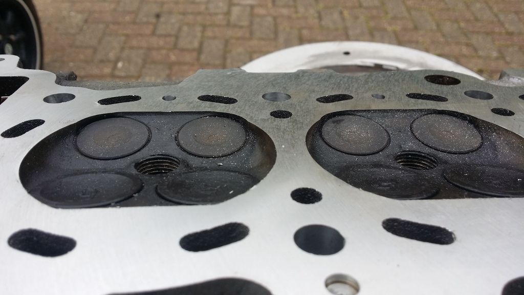

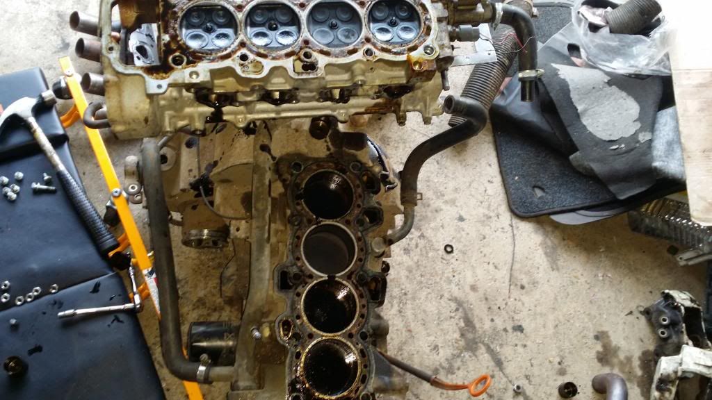

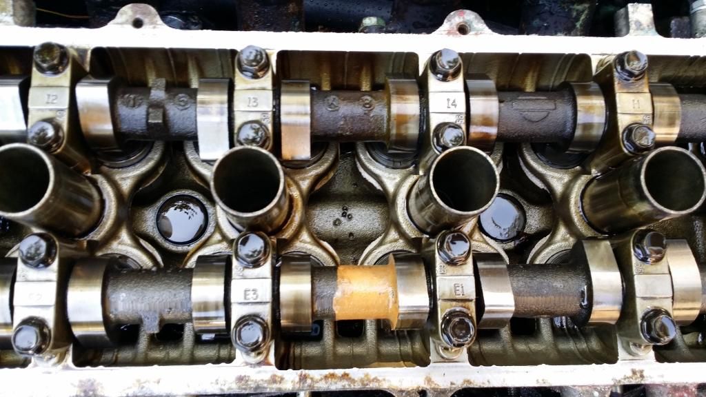

Oil in the combustion chamber :(
So engine out :(
Started to cleanup the brake calipers ready for painting and new hoses

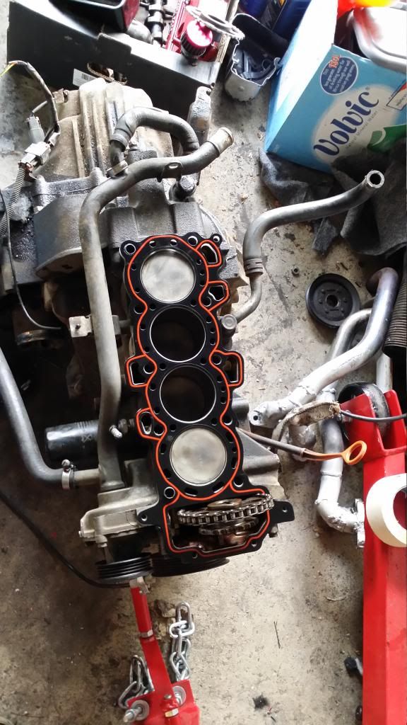

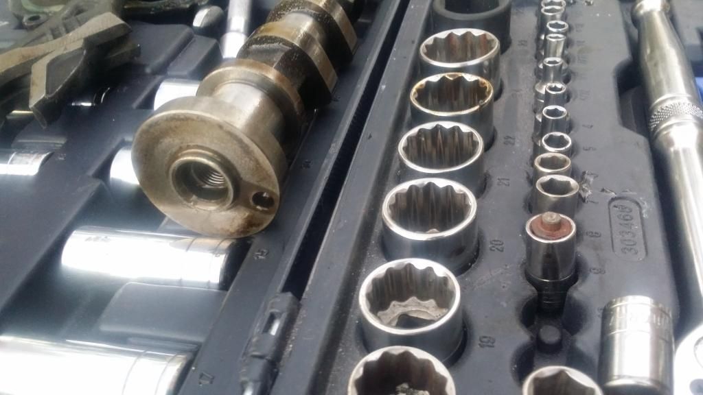

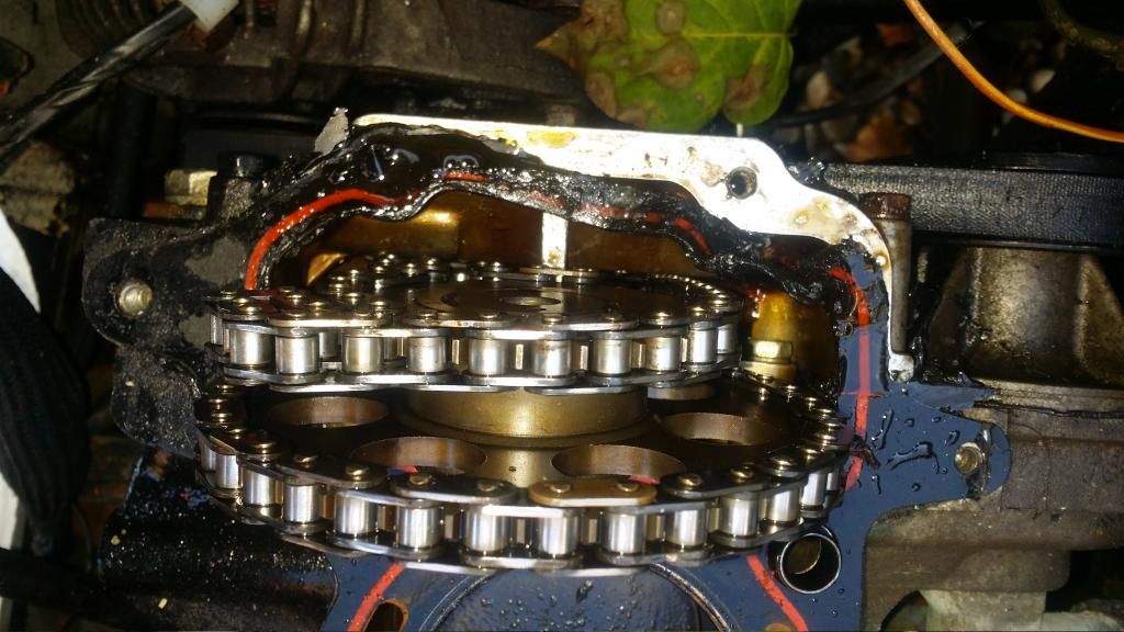

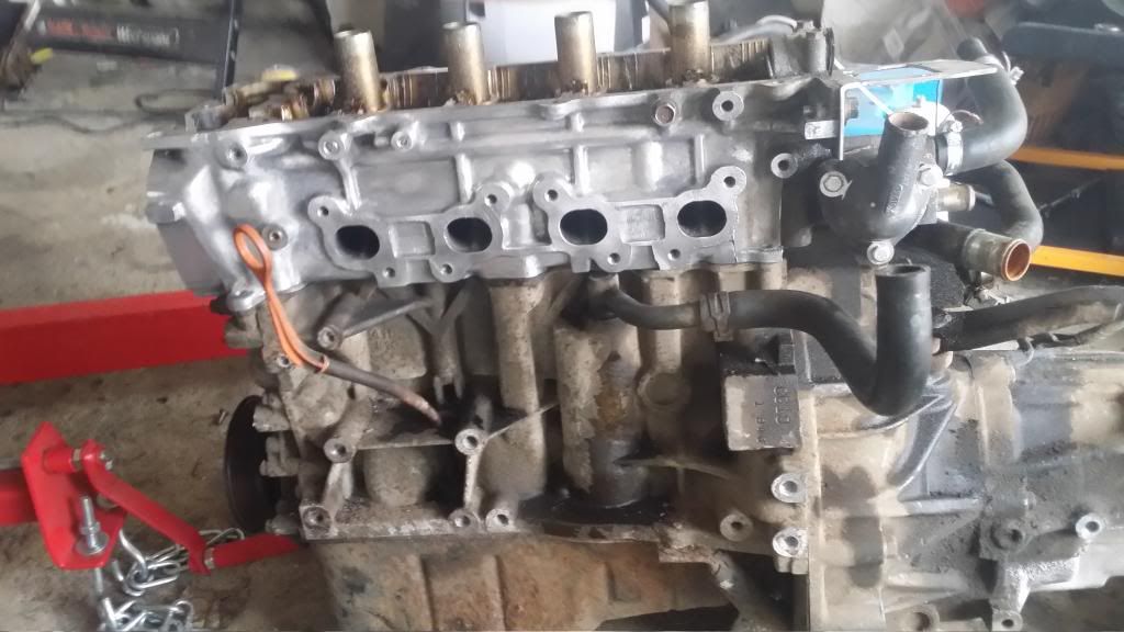

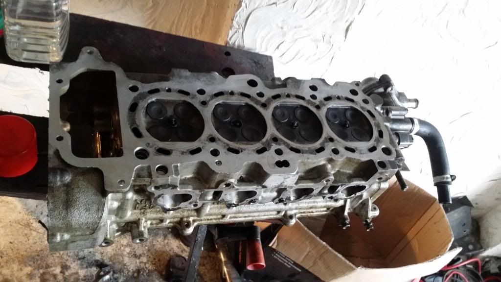

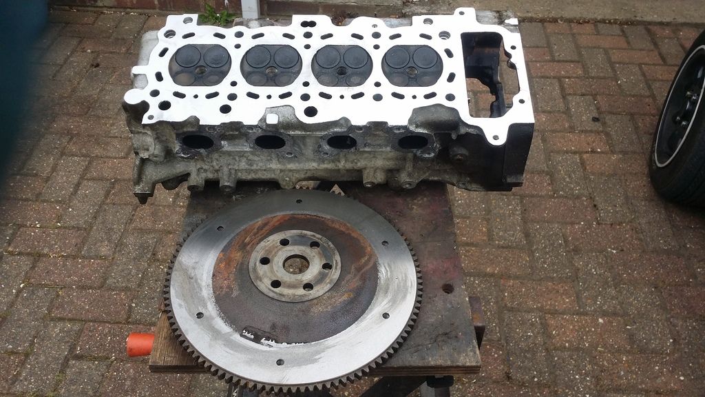

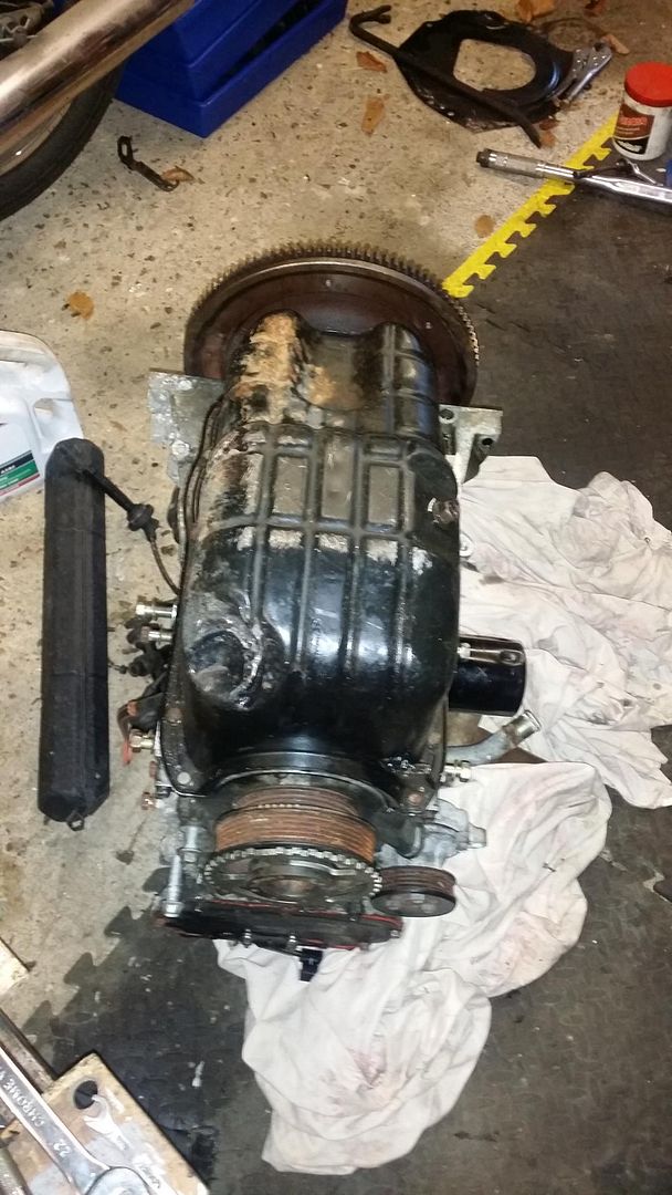

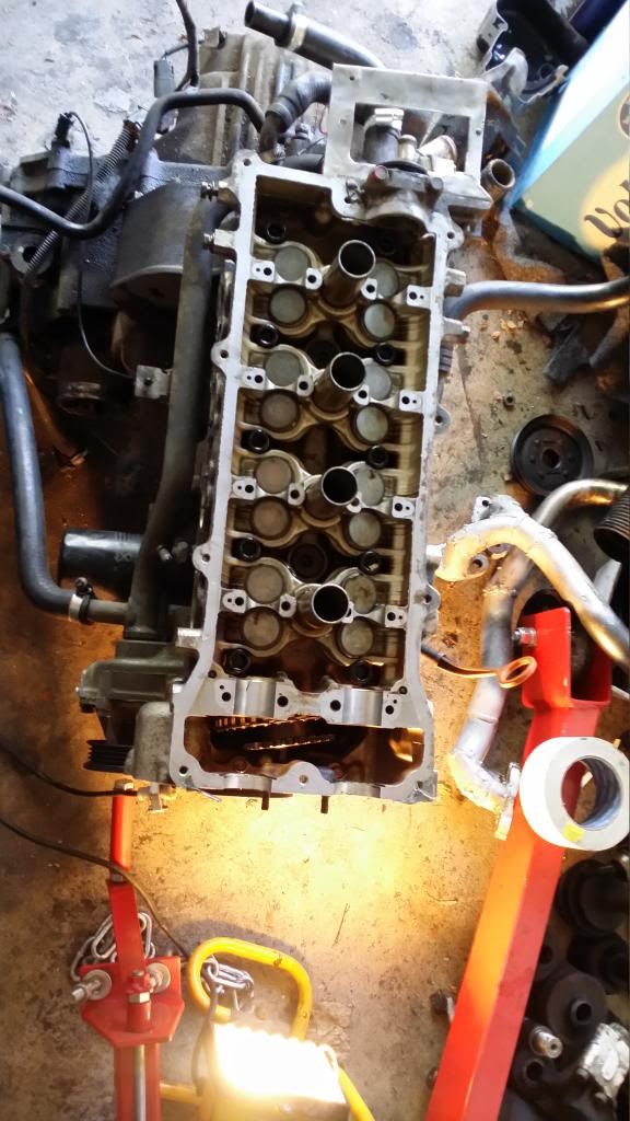

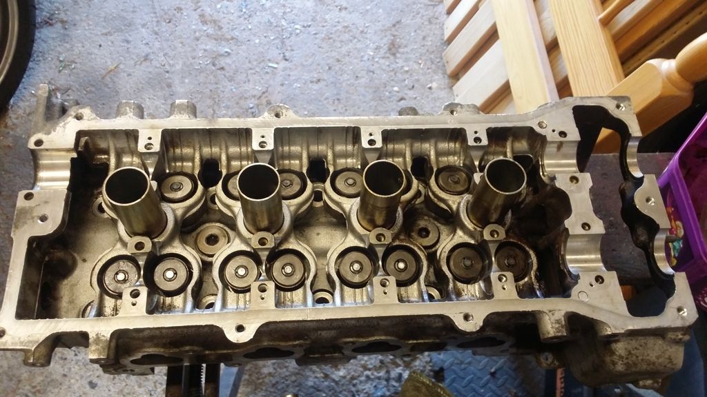

Engine dismantled, oil everywhere, valve stem seals have gone :(

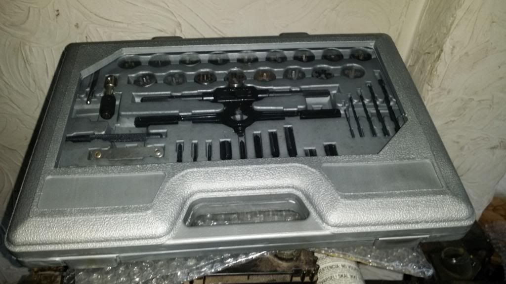

New tap and die set

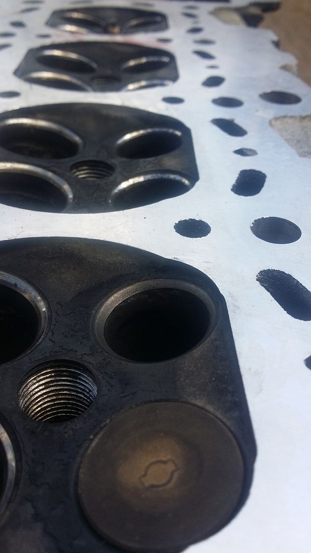

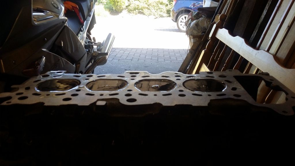

Polished up the cylinder head, only took 4 hours! Gunna paint the block and gearbox black so should look nice :)

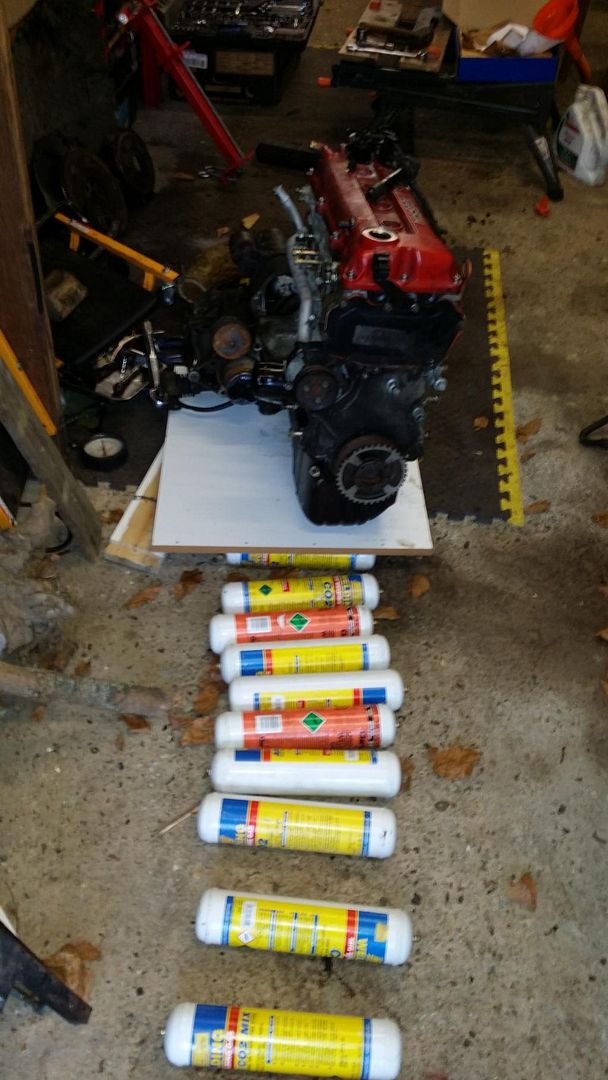

Contemplating buying this

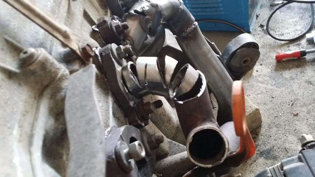

But that's all I'm afraid, ordered a new exhaust manifold as I don't like mine and some wrap also so that in the post waiting to come through
Trouble is I need a new gasket set which is£40 and a valve spring compressor which is another £50 and I have no money ATM :(

Valves lapped in
Valves refitted
New headgasket on
Head all on and torqued up, had to buy some fancy angle gauge also so yet more money spent :(

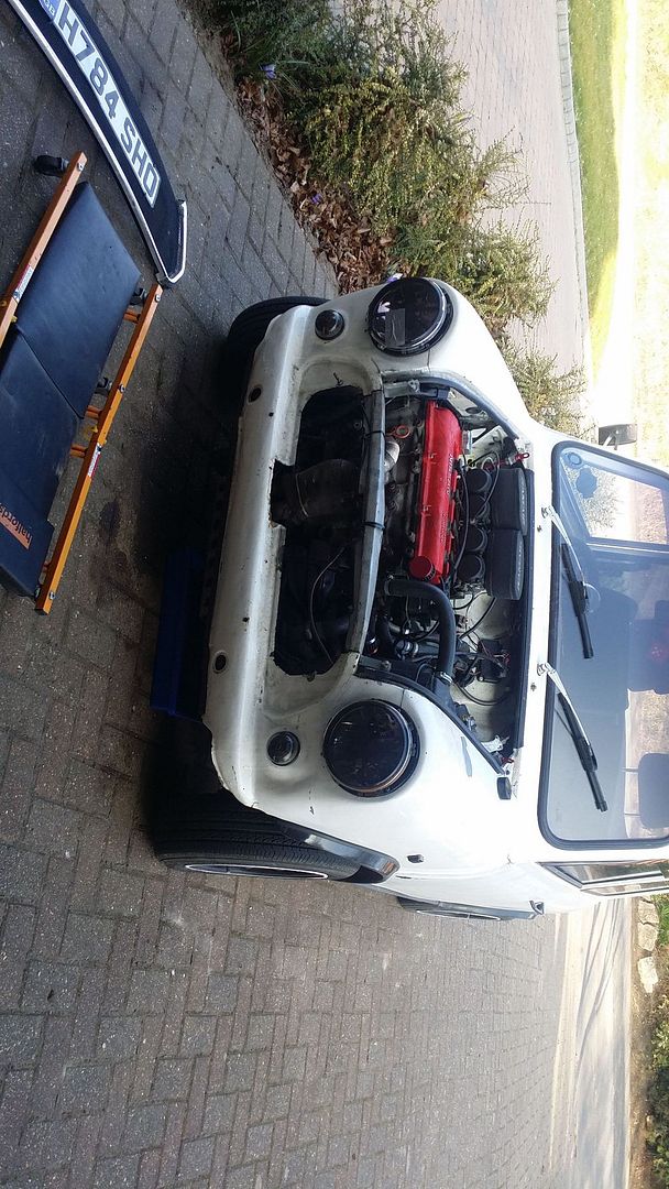

Engine back together and back in the mini, new exhaust made also
Engine all retimed and back together :)
Inlet painted and new gaskets fitted
New exhaust made, as everyone who came and looked at the car pointed out the crappy DIY one!
Garage tidied and engine ready to return to car
Engine and gearbox painted up :)
Engine bay tidied up again
Dropped it in

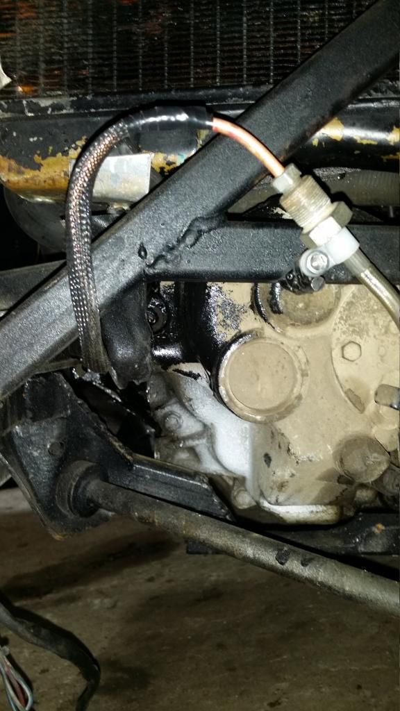

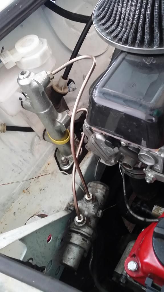

Brake lines
I've been cracking on with he brake lines however and they are now all done
So that's the front brake lines all sorted, they are all wrapped in insulating rubber and then polyester braiding due to the small tolerances through the areas they have to go through.
Brake callipers were painted also and will be rebuilt with new hoses etc sometime this week

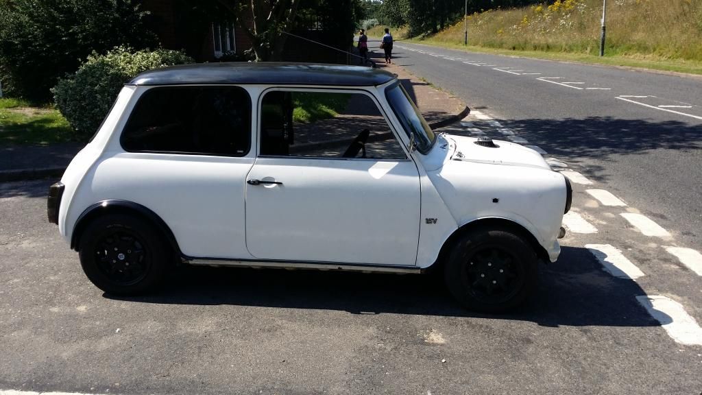

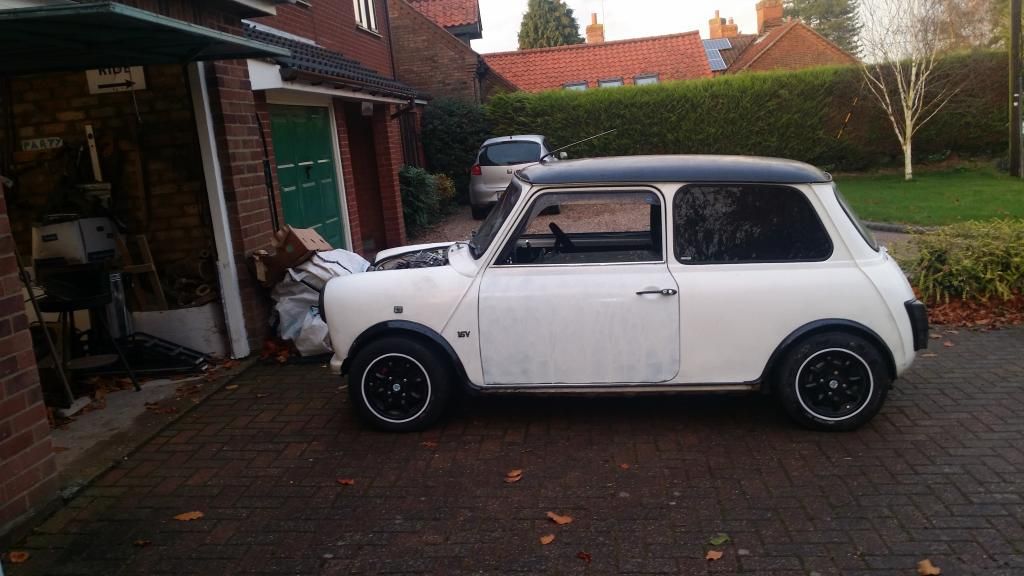

Between June and July 2014 I roller painted most of the car. Also did various mini related things which I ahvent transfered from my mini forum blog

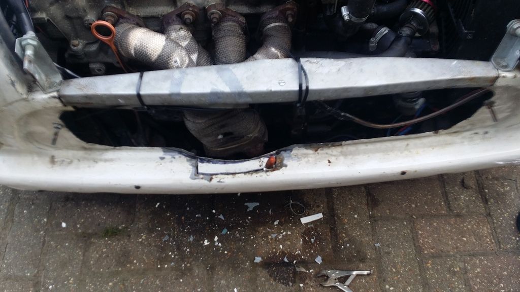

End of July 2014. First movement by own power, exhaust system shown in full with variable valve video also
My photos are all nicely uploaded :)
Exhaust tip position finalised

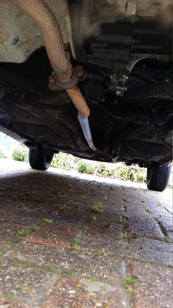

Undercar shot

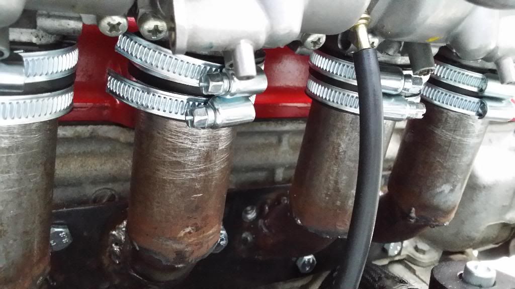

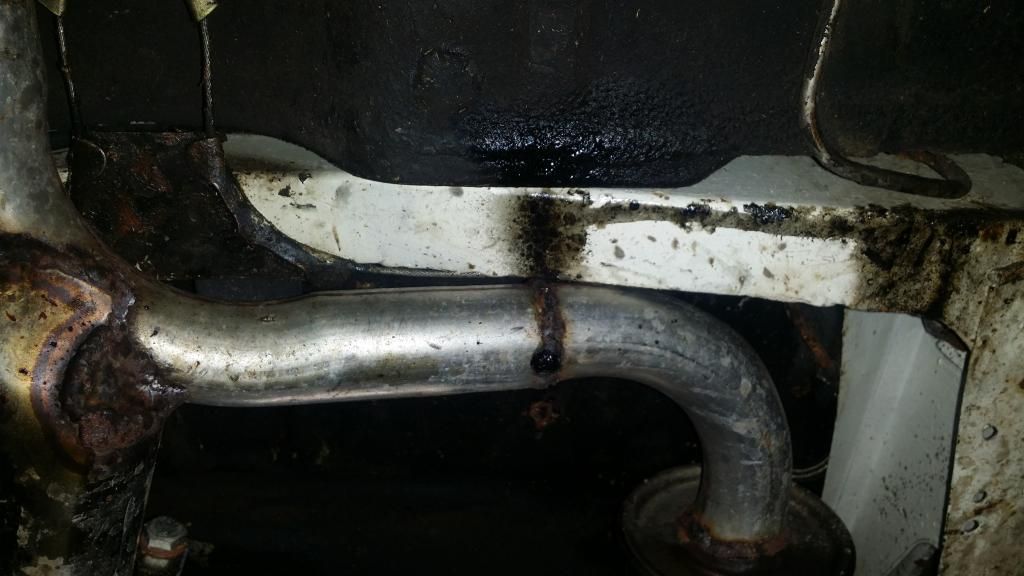

Exhaust manifold being finished off

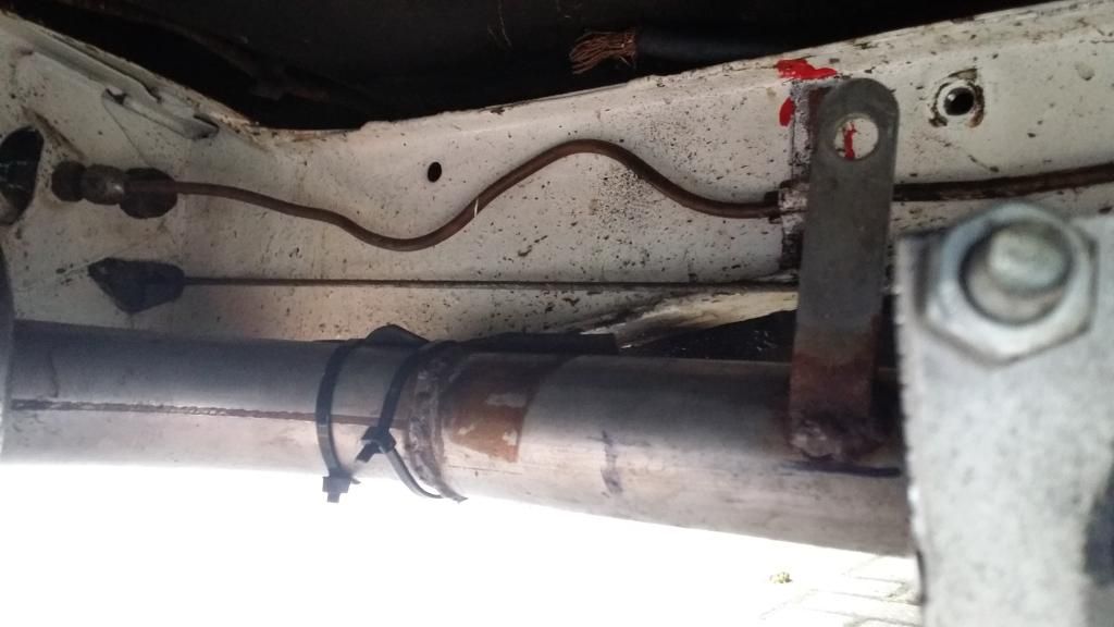

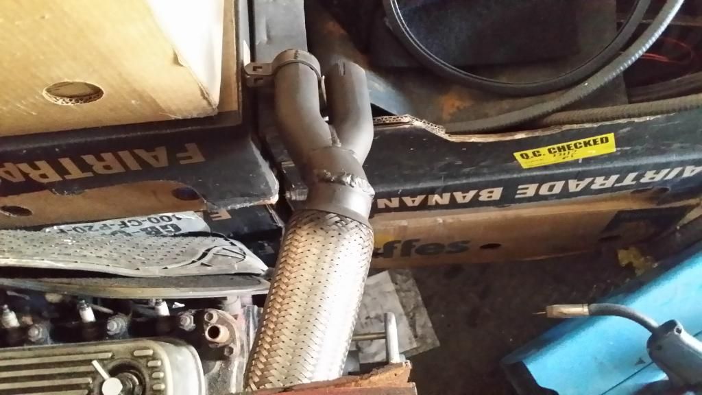

Y piece being modded for flexi pipe so give the exhaust system some movement
Rear silencer section fully welded

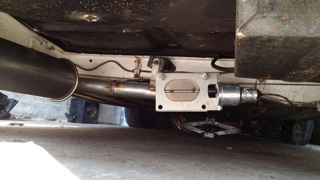

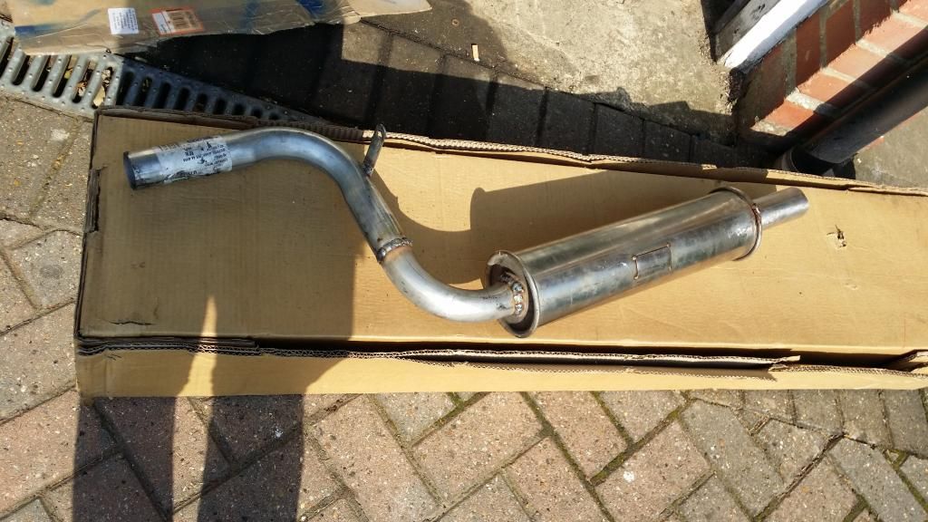

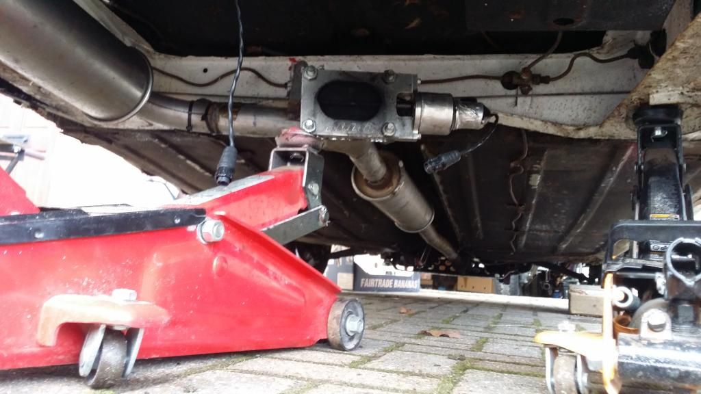

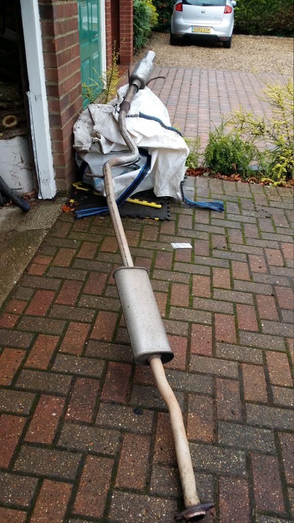

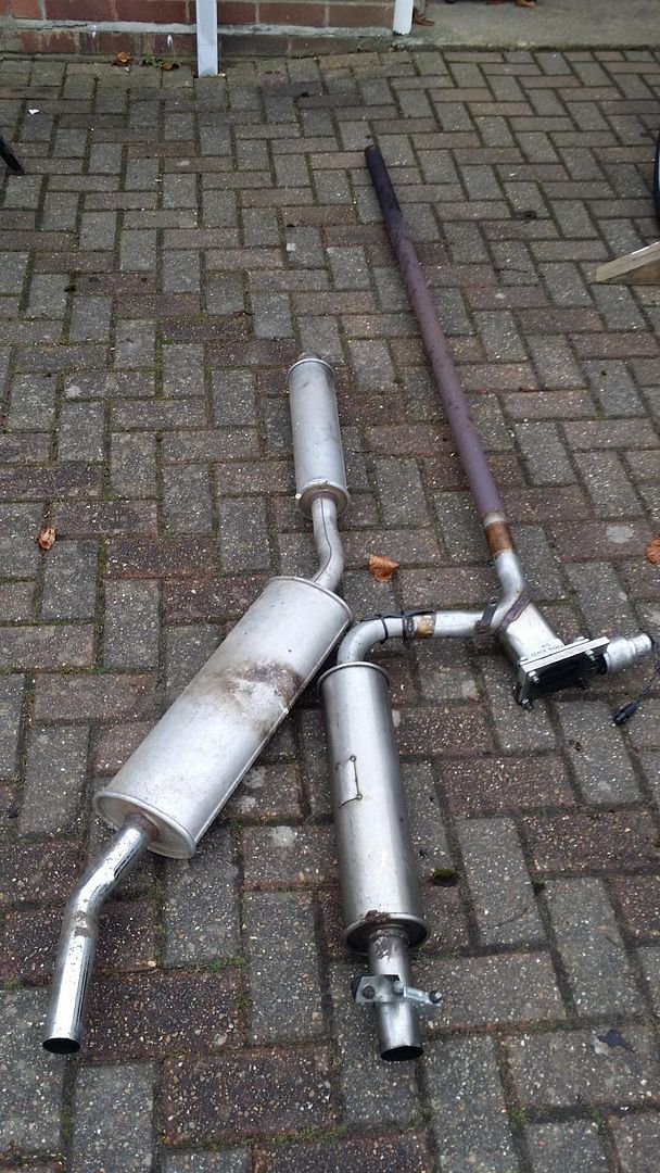

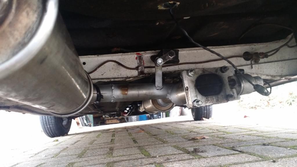

Qtp exhaust valve fitted and exhaust system mocked up on the drive

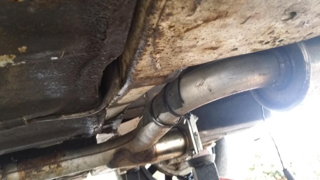

Exhaust fitted
I changed the centre pipe part of the exhaust shown on the driveway picture for a single straight through pipe to make a tidier job of it all

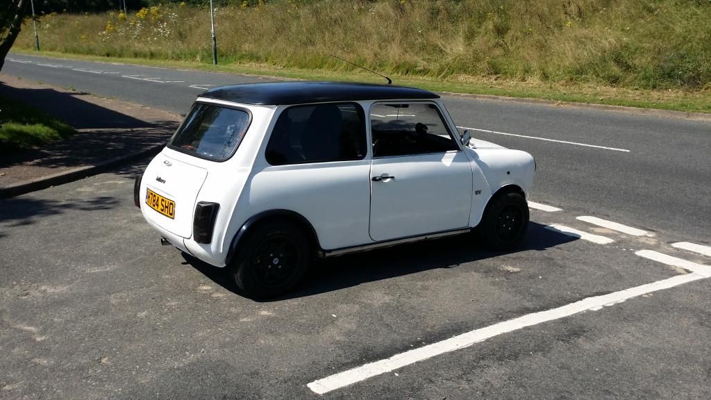

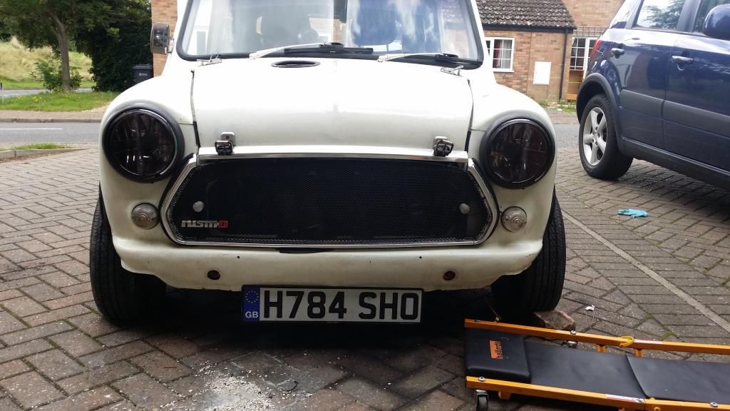

Rolled her out of the garage for a mini photoshoot
And last but not least a little video of the exhaust :)
http://i1111.photobucket.com/albums/h477/lawrence8322/Mobile%20Uploads/th_20140723_131440.mp4
The exhaust system is a 4/2/1 system, k series manifold modded to the micra exhaust flanges and then modded to a mini lcb y piece which is the welded to a flexi pipe in the middle of the mini lcb y piece for some flexibility. Keeping the mini y piece will allow me to fit standard mini exhaust, such as rc40, maniflow system etc.
I chose a 1 3/4 straight through pipe going to two 90deg bends then to a stainless silencer from ebay, end exhaust diameter of 2inches.
I chose 1 3/4 as that's what the rc40 on my a series 1275 performed best at, the micra 998 should put out the same bhp approximately therfore I chose the same diameter system.
The electronic exhaust valve will be linked to megajolt so when the car is at certain higher revs (3500 plus for example it will open) I doubt it'll add any power but it'll sound pretty cool!
Hope everyone likes this update

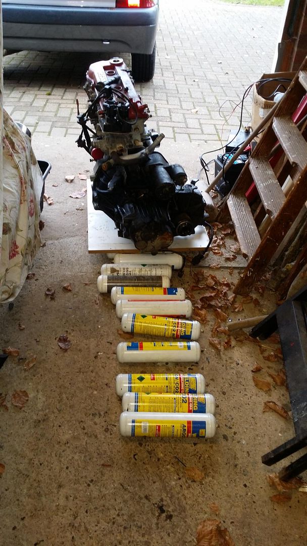

Engine fire

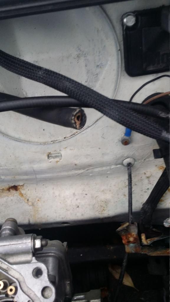

We'll today started well, got the exhaust manifold all nicely wrapped up
Fitted it all back up completely forgetting that the petrol pipe was leaking :(
Engine backfired popping the carburettors off the manifold and ignited the petrol pissing from the carbs resulting in 3 foot flames in the engine bay :(
So I grabbed the fire extinguisher From the car and put it all out
Mini is completely fine thank god but covered in the powder everywhere :(
Source of the fire
So I've packed her away for now as that powder is causing me to cough loads :(
So on the shopping list is petrol resistant silicone hoses for the carb to manifold connection and new petrol pipe connectors between the carbs, gunna get them made from milled aluminium so this mistake does not happen again!
Kinda rubbish update to be honest but at least I didn't get hurt !:)

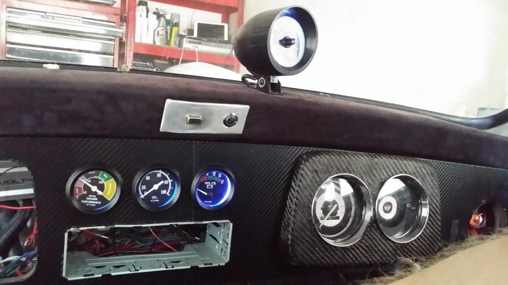

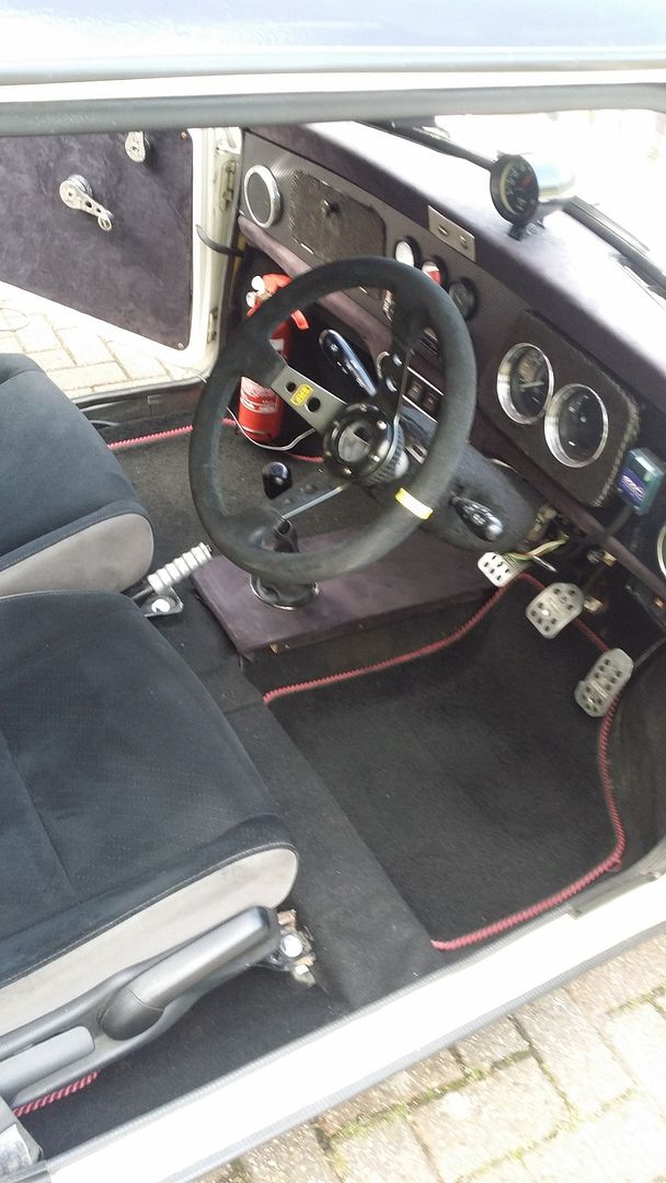

Tinkering with the interior

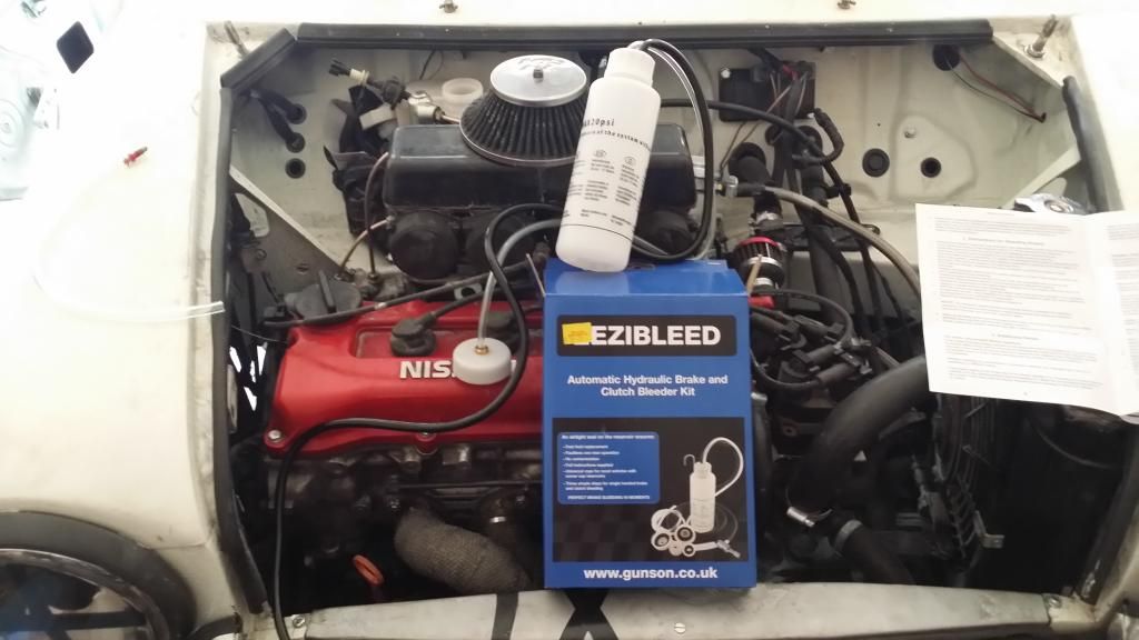

So guys I've done a few bits to the mini
Got an easibleed kit and the brakes are now sorted :)
Work needed on the inside
Too many different colours

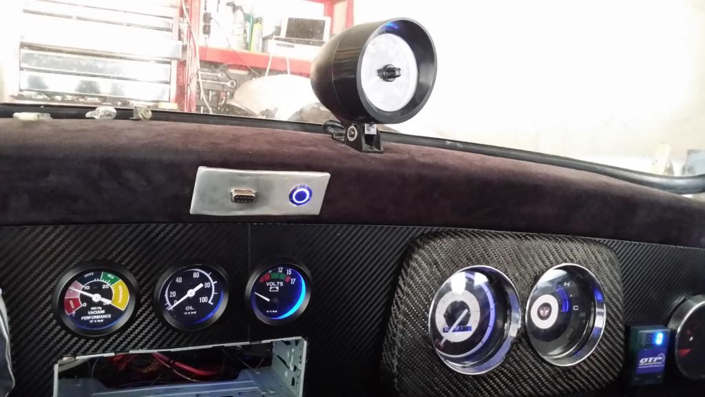

Got some blue LEDs
Fitted the speakers in properly
Before
After
More LEDs
Before
After
During the day

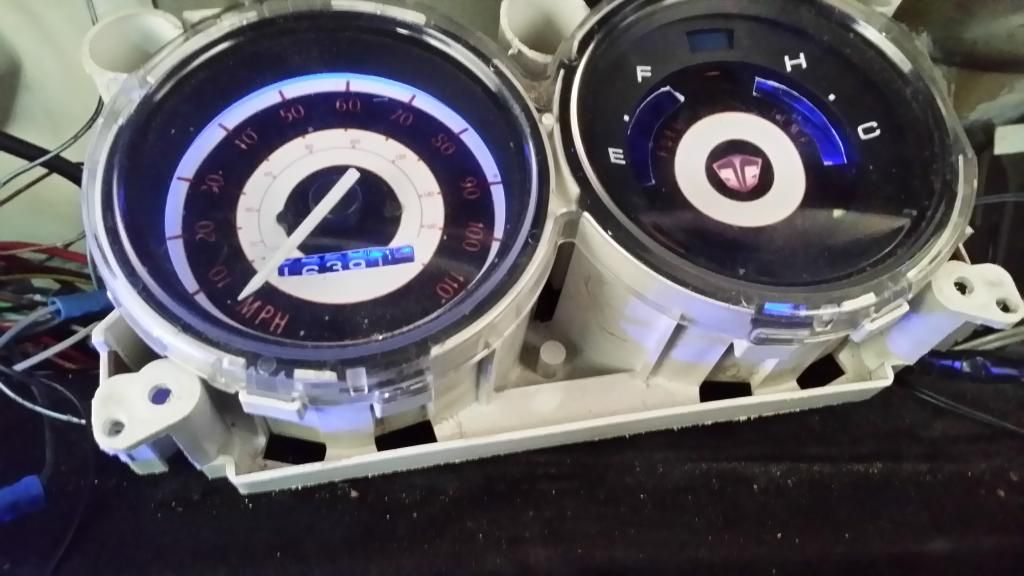

Dials
All sorted during the day
And at night :)
I have to admit it looks pretty awesome :)
Hope this mini update is liked
Lawrence

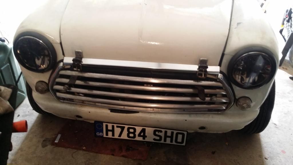

New grill
Mini update as expected, I've taken apart and got my carbs sonically cleaned, new seals all round :)
They are now fitted I just need to finish off the air filter setup
Made a new grill the other week
Before
After

Currently I am tidying up the wiring behind the dash. May make a start on the megajolt shift light :)

Trialing my mk3 air filter design
Overall look
The red you can see ontop of the carbs is a k&n filter that I cut up and flattened, possibly not the most ideal but should filter some air and looks pretty awesome

Trailering back to my parents and oil leak fixing
So guys time for another update of the past few weeks
On the trailer to go to my parents
In new home

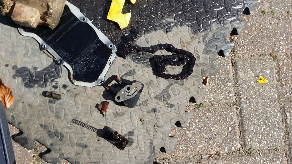

Ready for some engine work to fix the oil leak
Refrence pics for me
Found the source of the problem!
Feeler gauge showing gap in gasket
For the time being I've plugged the hole with some instant silicone gasket, thought I'd give it a try as I've got nothing to loose :)

Looks ace, good work. :)
Only concern is the angle of the carbs, they need to be at a 45 degree angle, for the float bowls to be the correct height.
Saxo fixing, headgasket change and intermittent cat photos
Had to do some more work in the daily
She was blowing around the silencer welds and it was breaking up along the folded seam
So I did what any man with a welder would do
Woo straight though!

Need to weld a small hole in the petrol tank
No photo of it welded unfortunately. I shall be buying a square race tank when funds allow
And with the oily bits. Gasket repair didn't work :(
So off with its head!!! Haha
Wayyyy past just sealing there!
New gasket!
Didn't take a picture of it one built up for some reason, but it's back together
Oil topped up too

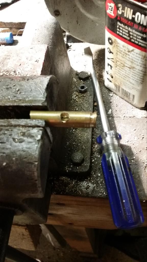

Learning new skills today
Soldering brass to copper
The brass bung is for the temp gauge
Where it goes
Drilled and ready for flux and solder
And sorted
Looks almost factory!
Very happy with that
So that's my updates from today!
Great news is that the engine keeps at a steady temp of just over 80 deg c at idle which is bang on what the Haynes says!
Turning on the aux fan rapidly lowers it to 50 so I think she's going to be fine on the cooling side of things!

Cams being broken
Well people, today had been very productive :)
The engine is fooked unfortunately!
But not broken enough so I can't fix it!!!
Basically this happened
The reason the engine refused to start, even with easy start was that the valves on the inlet size of the cylinder head we not moving at all. This became instantly obvious on removal of the valve cover!
At the end of the cam there should be a small metal peg to locate the cam, this has somehow broken and disappeared meaning the engine was never going to start
Drive to Hainford hall (nearest scrapyard) yielded me with a second hand hand inlet cam from a low mileage auto micra for a whole £12!
Valve timing set once again
Going back together
And the results are in!
http://i1111.photobucket.com/albums/h477/lawrence8322/Mobile%20Uploads/th_20141112_161049.mp4
That's just with a spray of easy start down the inlet manifold, carbs not on yet.
So theoretically I will get her running nicely tommorow!
Hope you like this small, but important to me update
Lawrence

Let's start off with this photo

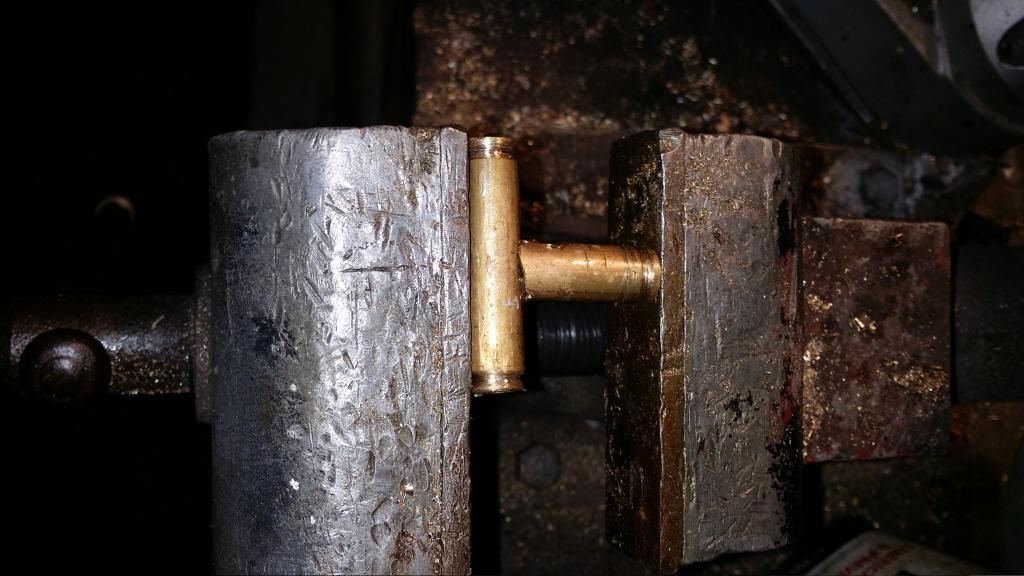

That's the end of the carb fuel feed pipe, yep it broke off, for the 3rd time! Brittle old plastic is to blame I think. Last time I bought spare carbs to steal the petrol feed pipes from, this time I'm doing something more permanent!
I went on a journey to a machinists nearby to hunt for some 10mm brass rod, I chose brass over steel as although I can weld due to the size of this part soldering will be easier. Rod cost a whole pound!
Extremely technical drill setup to drill out the centre of the rod with a 5mm bit
This is the piece I am trying to replicate in brass
Hollowed out piece of brass in hi tech lathe (aka drill mounted in vice)
Groove was then made using a combination of metal files and a chisel, hole drilled in middle for t piece
Hole being drilled
Ready to be soldered, clamped together to keep everything straight
And soldered, then lightly filed to remove excess solder then given a going over with a wire brush
And the finished article beside the brittle rubbish original
Fitted in its new home
Shortened and tidied the ht lead caps, also fitted button Allen bolts to hold the coil pack securely
And driven to the front of the garage :)

23rd set the timing, didn't work. Checked compression. Bugger
150,150,0,170
No compression on 3. Great. That would explain the low power and nothing to do with the fueling.
So rings or valves.
Teaspoon of oil says valves are borked
New engine now needed.

Time for engine number two!
Cheeks bud, that's a handy site. I just made a safe map while I got used to the car so nothing would get broken!
Time for an update :)
Found myself an engine
Stripped and cleaned
Next day started off a bit nippy

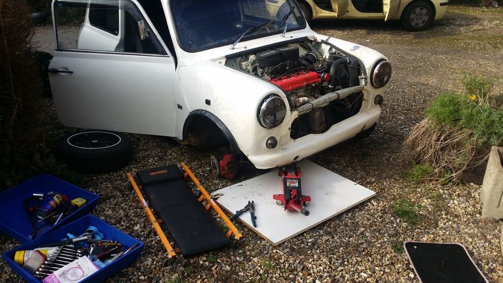

Time to get ready for the engine to escape
Part way through
Shafts removed
And engine out :)
Moar engine fun 1
Garage tidied
Broken engine brought into garage
Gearbox removed
However on removal of the engine I have discovered I've got two different types of clutches :( one car was pre facelift and the other post meaning According to the Micra forum I have to make myself a hybrid clutch or redo my subframe and or driveshafts!!!
So I'm mildly annoyed
Feel free to comment
Lawrence
Moar engine fun 2
So guys, mini update from yesterday. Like recommended by l jonez I've stopped the flywheels
Flywheels both off
Oil drained from old engine, it's castrol gtx so I'm stealing that and the new filter to put on my new engine. I'll popin a can of engine flush and change the oil again in a few weeks time.
Flywheel fitted
I also took the sump off he old engine and left it to drain, I need to stick it to the new one as it has the crank sensor bracket welded to it. Additionally I made a little metal sleeve to centralise the trigger wheel more efficiently that I had before.

Engine fun done and the new 998 back in the mini :)
Update time guys
Few things have happened now :) firstly I've started uni so it's been a bt of trouble to work on mini!
Let's take off from before
Coolent pipe relocated and re welded
It gives me more space around the back of the subframe now
Also fitted modified sump
The engine and gearbox were now together so to save splitting them again I decided to transport them to the car via roller method :)
All the way out the garage and over the gravel all by my lonesome
Painted the valve cover
And all done
And engine fitted.
That's my progress from last week
Also sorted the clearance issue on the subframe and fixed the slightly bleeding brake bias valve
December 2014
Final tidy up and it's ready for the mot!!!
So then it's time for a update from Wednesday until today :)
I put the rest of the engine bay back together
Fitted my new air filters
Ready for mot booked at 2pm Wednesday :)
So we went to the mot and all was good accept she failed :( but a reasonable fail and considering I hadn't planned to take her till today to get her ready for Wednesday was great!
Fail list
So as you can see a reasonable fail list, did the last bits to it last night and took her in this morning :) and well she passed!!,!!!
So I'm very happy :) on the way home the gf and I took some photos and I'll upload them in a bit :)
Hope people like this update! I'm soo happy that all my heard work has paid off!

Poor baby when I took her bonnet off on one of my days off she was covered in oil :(, checked dipstick and just covering minimum, no wonder she was leaving dots on the floor. Hadn't realised as she was parked on the gravel drive
Shiny oiliness
The blanking plug I had made to block the distributor hole had ruptured. So made a new aluminium plug out of the Micra distributor
Where the plug goes
Fitted oh so snug

Took her to get 4 wheel alignment done with a laser alignment kit.
Tracking was adjusted and and she handles loads better, may need to look into changing the lower arms at some point as the negative camber on the front isn't very equal. One is 2.5 percent and the other 0.5 so I think my bushes may be tired.
Took so photos underneath.
So dirty and only done about 500 miles tops :(
However I spotted this issue
I've got a small exhaust gas leak but the bigger issue is the exhaust is about a mm from the rear subframe so that could account for some of my vibration and reverberation issues I have been having at certain revs.
So onwards. She needed to have more clearance, was catching on too much road :(. Numberplate position adjusted and all suspension raise for the winter
Sumpguard trial fit
And fully fixed on
She is attached with 4 bolts at the front but the rears are on sliders that go into the box section that the subframe is made, it was an idea that I had when making the frame and deliberately left open two bits of box section on either side of the subframe. Means that there is some movement of the sumpguard

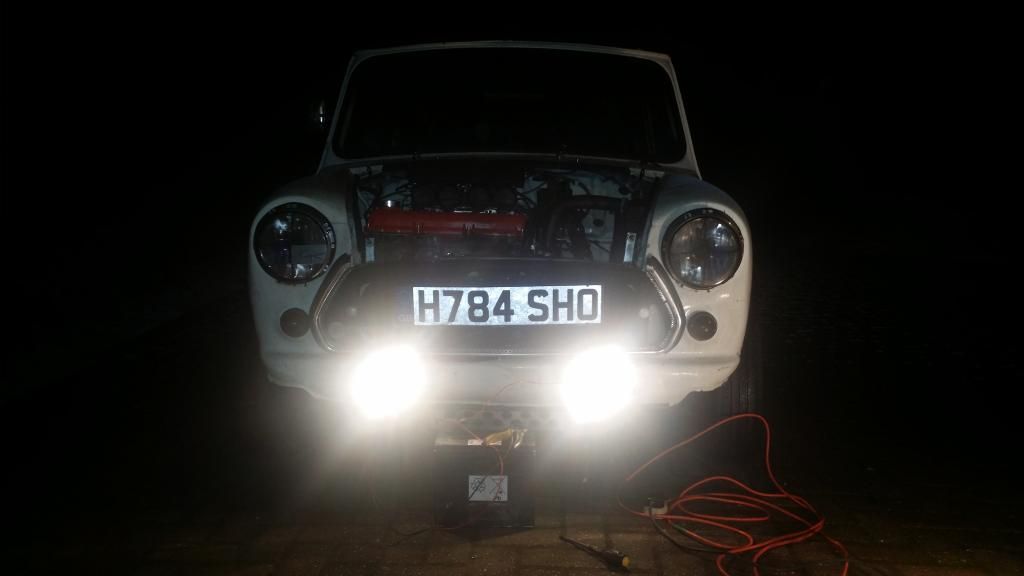

Fog lights fitted and test wired

Exhaust silencing
I'll look into them, the only thing that's putting me off is the cost of about £150 for a reliable and accurate one.
So then, today has been productive. Started off with assessing the exhaust system and its faults. Need to give it more clearance and a silencer.
That's as it was, clearance tight on the left by the old battery cable girdle slot, so wanted to move the exhaust to the left with a kink.
Removed and next to spare rc40 to be slaughtered for the cause
Donated parts cut up and realigned
Tacked together for test fit
Refitted and its bang on where it needs to be
Loads of clearance for the silencer
No longer mm close to the subframe
Removed and fully welded up
Final fit back to car.
All welded and clamped joints sprayed in zinc primer to clearly show rust pinholes
Took mini for a drive, if say it's about 30percent quieter so should be nicer when I get to speeds of 50mph or so. Vibration is defiantly down too! :)

Definately nearside inner cv, my rubber is still chafing on the frame unfortuatly so the inner gaitor is damaged and spitting grease, I need time to take apart and asses what I can do to fix it.

But I did do a few bits, changed the catches on the bonnet for genuine aerocatches and now they are tip top! Also got some gromits to use on the engine bay to try and stop some of the petrol smell coming through
Got a nice picture at the park and ride
Needed to do some work on the front end, so took off the spotlights that I never wired in
Now I need to fill some holes and re do the exhaust cut out
Panel made
Camouflaged the mini
Part welded
All welded up
Ground back and filled
Ready to paint
After two coats
And after four
I've left it to dry overnight and then I'll refit the grill tommorow :) happy with the finish too!

Cue first ****up.
I took the alternator charging cable off the alternator, totally forgot its attached to the starter motor and battery! Cable taps frame, creates short. I grab it to stop short. Fine for a moment but the the insulation I wrapped around the frame by the starter motor has gone and melted therefore battery is now shorting straight to the subframe. Entire car fills with burning starter motor cable smoke (cable runs inside) Rush to the boot to disconnect the battery. Can't find the freaking spanner! meanwhile car is billowing smoke and I'm in the boot trying to disconnect he battery! Lever off the negative earth clamp breaking a screwdriver but breaking the short.
Photo was taken while waiting for the smoke to clear whilst holding the fire extinguisher.
What remains of the starter/battery cable

Cleaned up the engine bay, took off alternator, checked it, totally fine just oily. Waterpump not seized so that's a good sign too. Checked oil, no sign of headgasket failure. Low water in rad but that's normal for her. So far thinking I got off lightly!

So then guys, it's time for a bit of an update :)
I drove her home/limped along at 40mph on Saturday morning, engine feels fine although she did overheat slightly but I have no idea how badly as my gauge is situated in the radiator not the engine block :(
During the drive home there was a slight mist of oil gently spraying into the windscreen so I knew something was broken big time, it was just was it the engine or something easier to fix!
I took her apart when she was home, cleaned up the block to find the source of the oil leak.
It wasn't the cylinder head thank god, it wasn't the cam chain view port area, so could only be the timing chain cover :( a big engine out job!
So started her up with the alternator removed and it was instantly clear where the oil was from
Oil after two seconds of running
So it was the lower pulley oil seal! Awesome, should be a nice easy fix if the engine was in a micra as there is loads of room!
However this is a mini micra so room is tight! Luckily I could get the lower pulley off as if not it would have been an engine out job!
Remains of the oil seal
Just need to clean up the old seal area
New seal has been ordered and so has 5 metres of battery cable so I can start her again. I am hoping the parts will arrive tomorrow as I am currently without car but still have to get to uni and placement!
Oh and there is nothing wrong with the cv gaitor, I must have simply not done the cable tie up enough so it slipped off!

Time for this afternoons mini update
Battery cable never arrived :(
So I took the carbs off and started fiddling
Made a new fuel pipe t piece from brass
Part way through
And completed next to the first one
And the evolution of t pieces
From left to right there is
Mk1- Repaired with metal tube and petropatch putty. Failure caused first engine fire, max bodge
Mk2- Entire set of spare carbs bought cheap from ebay, t piece then filed down to fit, medium bodge but completely worked
Mk3- Entirely new part, made from brass and silver soldered together, fitted perfectly, two issues in that it fits carbs slightly loose so may potentially leak and at 10mm was too big for the 8mm fuel pipe
Mk4- Again new and from brass. Fits carbs perfectly with many trial runs, double o ring for extra protection just in case, also turned down to 8mm to fit the fuel pipe snugly!
Also changed the jets in the carbs :)
Previously 118.116,118,116 now 114,116,114,116

My carbs played up the other day with one of the float bowls not shutting off, it's something that happens every once in a while but is a case of lowering the fuel pressure and then upping it again to sort itself out
Also got around to painting the bonnet on a nice day off
Before
Half way
Done
Also did a paint repair on the wing where the paint had peeled
Done
And all fitted back together, also fitted the outer light rings too, shall repainting these in black at a later time
And fitted second subframe hole cover to tidy up the front :)
And this post is finished off with some nice photos of her posing

It's hard trying to separate micra stuff from mini stuff! Not much micra related things have gone on really
New carb bolts fitted
Now all cap head Allen bolts so no more almost sheared cross heads to put up with! Also will make jet changes a two tool job opposed to 7and a Ratchet
I've also tuned the megajolt so I've got two maps as until I get a new battery for my laptop I cant do tuning as I drive unfortunatly
I also need to have a look at the micra gear change mechanism as it feels rather sloppy and it's getting on my nerves now when I compare it with other cars I drive

But on the micra side I've bought a new engine for mini!! :)
It's the 1275 micra engine :) unfortunately it has a broken timing chain! But I got it for a steal at only £40! It came with an alternator, power steering pump and the whole inlet manifold system so hopefully if I can sell them I can recoup the £40! Which would be great as I'm rather poor!
I've taken it apart and so far it's great! The chain snapped at engine startup apparantly and the chap I bought it from hadn't investigated into it and sold it
Top chain snapped and tensioner exploded
The plan is to take the head off, check the bores out, do a petrol test to see if the rings are damaged.
I have already tested the valves by manually turning the camshafts and they are all sealing great so there's no damage to them or the Pistons theoretically!
Once I've checked the bores I'll send it for a head-skim of 3mm and fit a half link in the lower timing chain :) and make a high compression 1275!!
I've made a post for the bits I've taken off to sell also
Feel free to comment! And drones anyone know what sort of bhp a skimmed 1275 puts out?
Lawrence

So what have I done? Well the engine parts are back from the machinist :)
Flywheel has gone on a diet and lost about 5kg.
Head has had a skim and lost 2mm so compression should be higher :)
Had a breakdown on the 6th June. Waterpump belt went unfortunately mid journey so had to drive about a mile to the girlfriends with no waterpump going.
On examination in the morning I found that the waterpump bearing had gone with 2mm play side to side. Most likely causing the premature belt failure
Changing the waterpump
Cleaned up ready to fit new one. Access through the inner wing isn't too bad. I'm glad I cut them back however or it would have been an engine out job
New coolant in the engine and she's running fairly well. However there is a grumble at low revs. Probably the engine has had it but I'll keep it going for the time being. Also main good thing of the breakdown is that I found a bolt rubbing on the subframe, removed it and there is no more engine drone!!!
So back to the engine mentioned in the last post
After checking the valves with petrol they all had leaks to some extent and the combustion chamber only remained full for about 10seconds before draining
So lapping the valves in
Nice Matt finish
Pitting evident on the exhaust valve seats
So they are all lapped in. New stem seals gently tapped to places and valves oiled
Had to adapt my spring compressor tool after having a shock finding the price of the proper tool
All done. Took over two hours to fit the valves due to the complicated tool I made!
New plugs fitted
Bosch super 4s as a little treat and as the late Richard Attenborough said i “spared no expense”
And tested with petrol
Needed to tidy my gearbox mount as it was cutting into the carpet
Tidied up
Covered in sound deadening to try and cut down on engine gasses creeping in so mucH
Carpet cleaned up and refitted
Interior all back in
And then back to the engine
New headgasket (£15 bargain)
Head placed on
That was all done by the 5thjuly. New engine was ready for fitting cams and lower timing chain all torqued up
