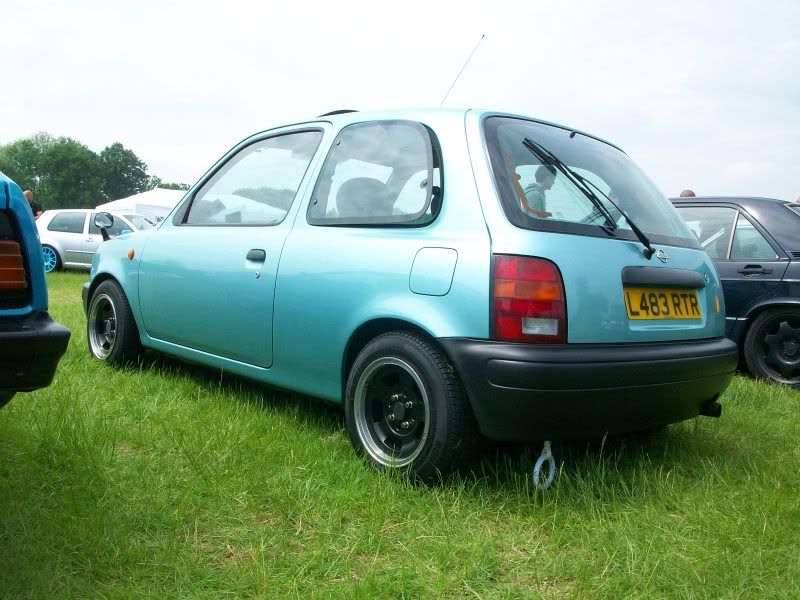

meji, have a good chop at a set and see how it sits. if you dont like ive got a spare set you can have for free to try agen
First coil + 1.5 off the front, first coil + 1 off the rear. You can take more off (Y)
Fronts were loose but are wired into the cups. Rears are a bit loose and awaiting me having time to shorten the rear shock rod.
The ride isn't nice, but its bareable.
