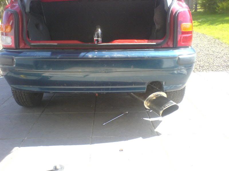

lol james had sumone weldthe exhasut on and they di it rong therefore he put it thorugh the back bumper :s
sumthing i have to sort out

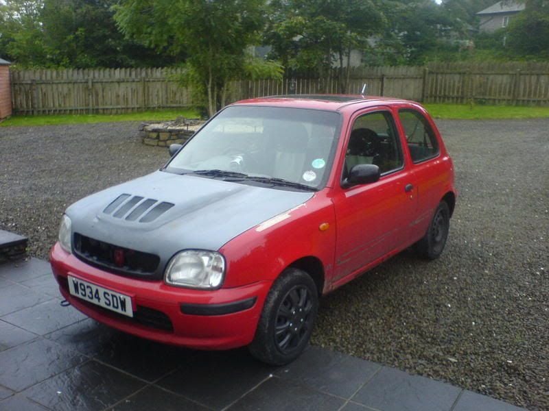

I'm sure that bonnet will look much nicer when it's matching the rest of the car.:k12red:

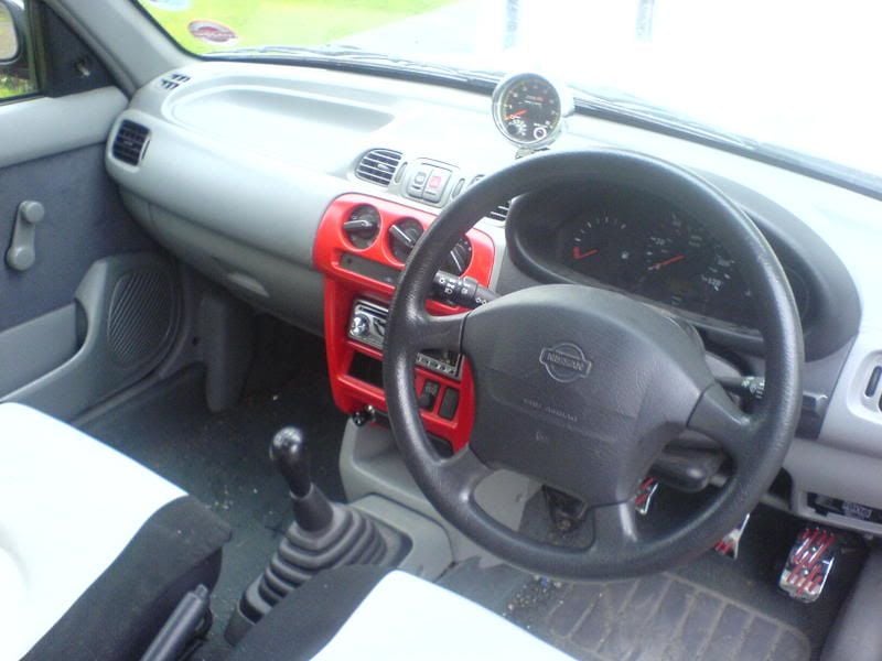

I've noticed that you have a rev meter in your car how easy was it to fit and how if you don't mind me asking.

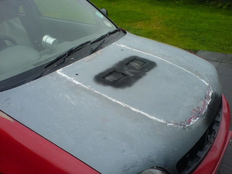

the bonnet looks pants on a micra full stop :p pulsars have them for a reason (top mount intercooler) on a micra its just stoopid imo, and jas didnt put in the rev counter. although he may have put one in his other micra.

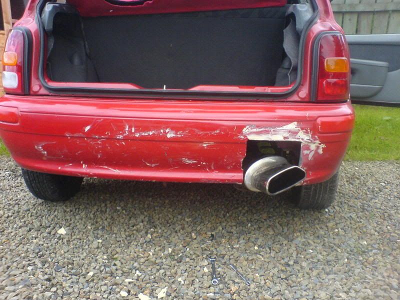

i like the exhaust wat is it ? wats wit all the foam?
how can you like that exhuast??? its at a stupid angle and its coming out of the bumper! also iam guessing the foam or filler whatever it is is there to rid of the hole and smooth around the ott exhaust...
i fitted the tachometer to the car.
its easy, connect ground to ground +12v to ignition live and illumination to either side lights or to +12v so the light is perm on
the wire that is for the revs goes to a blue wire on the dizzy
the fill;er on the back bumper is because someone went into his rear end and broke it (apparently)
and the vent was his own idea
